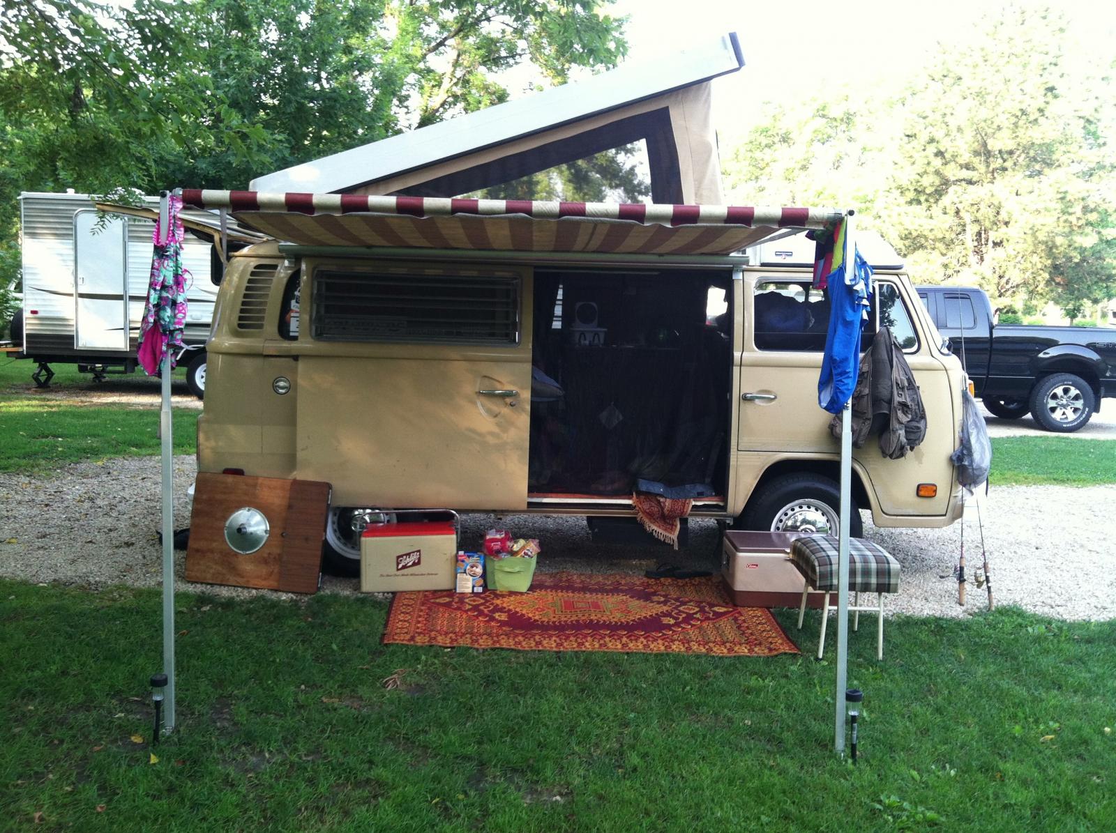

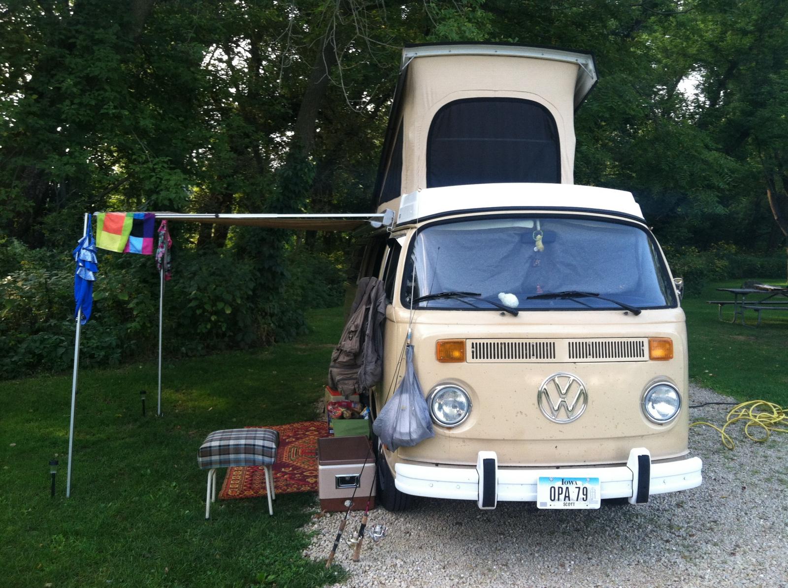

Finally got around to installing my Transawn on my Bay Window. Bought brackets from the above mentioned Eezi Awn dealer. Plan to fab a third mount for center myself, after seeing them in person. Mine doesn't interfere with slider operation and is a breeze to open, set-up, etc. Love it.,,

I have no problems with the case rubbing the slider on my Bay at all. I have heard from a few other Vanagon owners of the problem though. As you mentioned must be how some mount them.
