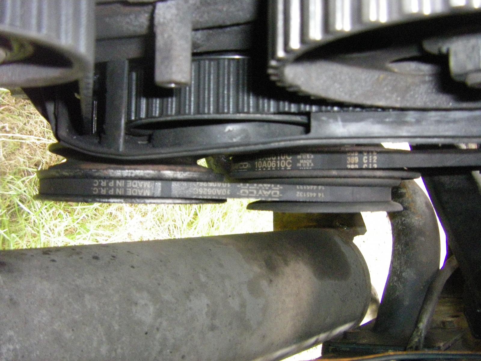

OK, I will post pics of my crank bolt and washer once I actually remove it (just ordering the 27mm deep socket this evening).
Seems T3s have been plagued with crankbolt problems... what kind of problems? Do they loosen and come off?

The updated crank bolt does not use a washer.
What size wrench fits on your current crank bolt? Is it 19mm or 17mm?
yeah, the one I'm thinking of ordering seems to have the washer built in...
is the updated one 17mm 12 point?? [I was about to order a 12 point 19mm just for that bolt - because my current one is a 19mm)
Jumping now slightly ahead, I have been a bit concern with the waterpump belt tracking (although I know this is less critical)... here are a couple of fotos of before I touched anything... it looks to me like the crank pulley needs to be further OUT. Or perhaps the double-pulley should be further IN, or maybe a tad of both?

PostPosted: Tue Feb 16, 2016 10:52 am    Post subject: Re: 1.6 TD JX timing belt change / injector pump timing set Reply with quote
epowell wrote:
QUESTION ABOUT FILTER(s) SIZES:
I'm about to order AIR, OIL, & FUEL FILTERS.
Should all these filters listed for a JX fit my engine, or are there variations to the sizes ordered and needed?
The OIL filters mostly seem more or less the same sizes. I am thinking about ordering this one:
http://www.autokseft.cz/FEBI-Olejovy-filtr-FB-22540-22540-nd184378
However the FUEL FILTERS seem quite wildly different in sizes... is this normal?
My guess is that I should go out tomorrow in the light and remove my existing fuel filter, and make sure I order the same sized one. This is where they are listed:
http://www.autokseft.cz/Nahradni-dily/VOLKSWAGEN-1...0105_10361
AIR FILTERS?
...these all seem about the same size:
http://www.autokseft.cz/Nahradni-dily/VOLKSWAGEN-1...0105_10360
All oil filters are the same from that age up to the 1Z/AHU Tdi You can use even the AFN one but it is shorter a bit. I am using a brand named Filtron that made in poland as it is one of the cheapest ones but has good pressure valve.
The fuel filter varies per year. The screw on type was used up to '87 or '88 models where it was changed to the valved type. Sometimes mechanics change both type to the two nipple version used on all other VWs as it more commonly available in their inventory.
The 295mm tall air filter is what you need for an original cyllindrical air filter housing.
The new type bolt is 19mm 12point
In my PM where we were discussing the waterpumps and locally available manufacturers in general, I mentioned that this type of misalignment is what I have with the cheapest pump. The casting of the pump is thicker than OE (maybe Bosch) so the pulley is out compared to the original.
