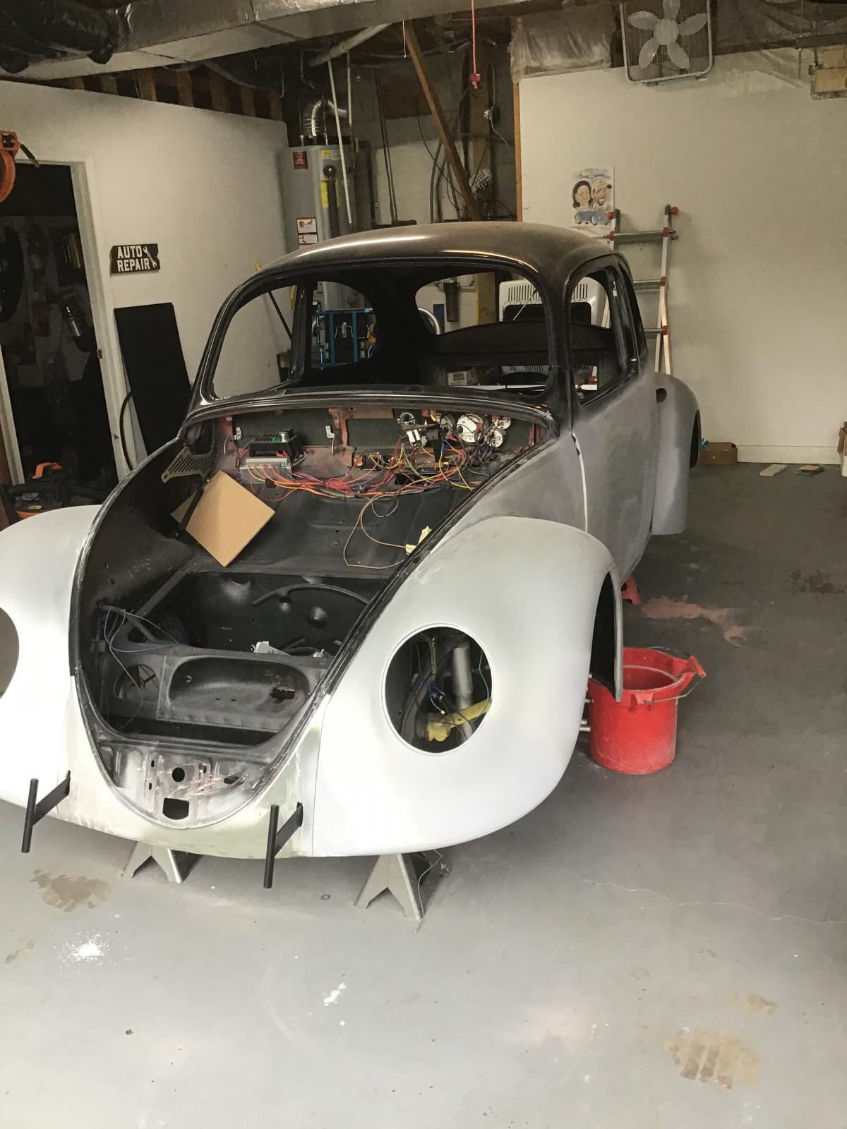

Getting ready to start sanding this 20yr old paint job on my vw that’s never seen the light of day other than to roll out and take a few pixs like this. My car was stripped to the metal b4 the existing paint(base/clear coat) was applied so it should make a good base for the next spray. I’m thinking wet sand the existing paint with 200 then with 400grit. The blue paint on the side will need to be sanded down to the silver base coat since the transition between the two colors can easily be felt and seen. The new color will be some shade of silver so I’m thinking the primer sealer should be that same color.
Should I used an expoxy sealer? (brand?)
A regular high quality sealer/primer? (brand?)
What grit should I used on the seal coat in preparation for the new base/clear coat? (dry sand?)
Does this sound like the correct approach that will result in an quality paint job? I’m planning to color sand and buff/polish to a show finish.
Thanks!

Body on the above is dent and wave free. In preparation for the application of a urethane primer(grey), would hand sanding the current paint job with 320wet be adequate b4 the primer? The new color will be metallic silver(Audi Florett?) base/clear coat.
Also I have a $120 Sharpe Cobalt HPLV gun still in the box that I purchased about 15yrs ago with a 1.4mm tip. Would the 1.4mm be adequate to spray the urethane primer? I plan to purchase a better gun b4 applying base/clear coat.
Thanks

if you're just doing a color change just seal it and go.
you'll have to look at the TDS for whatever you're going to spray in terms of grit and tip size.
rule of thumb is 400-600 grit on existing surfaces BUT CHECK YOUR TDS for the correct procedure

Thanks skills.....I should have mentioned that even though the body is straight there is some trash and minor orange peel from the previous paint job. I want to make sure I sand it out b4 I lay the urethane primer down. I’m thinking wet sand the entire car with 320 wet, apply the grey urethane primer, then wet sand the urethane primer with maybe 600 wet.
Hopefully she will be ready for the base color coat after all of the above.

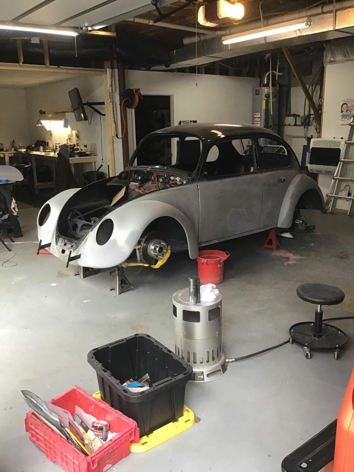

Started block sanding the old paint on each panel and fenders one at a time with the intention of perfecting each b4 I move on to the next. In the process I have found more low spots, small cracks and pin holes than I realized. Even the CCC rear fenders required some cleanup. I plan to use a still new Sharp Cobalt with a 1.4 tip I purchased about 20yrs ago to apply the 2K primer. I will be purchasing a Master Pro 44: https://www.amazon.com/Master-Performance-Spray-Pressure-Regulator/dp/B07HNFDCT9 based on reviews to apply the base coat and sealer.
I will tackle the roof next and then add a removable 67 apron as soon as I find a donor part. If I can’t find a 67 rear apron CCC makes a rear apron cleanup panel.

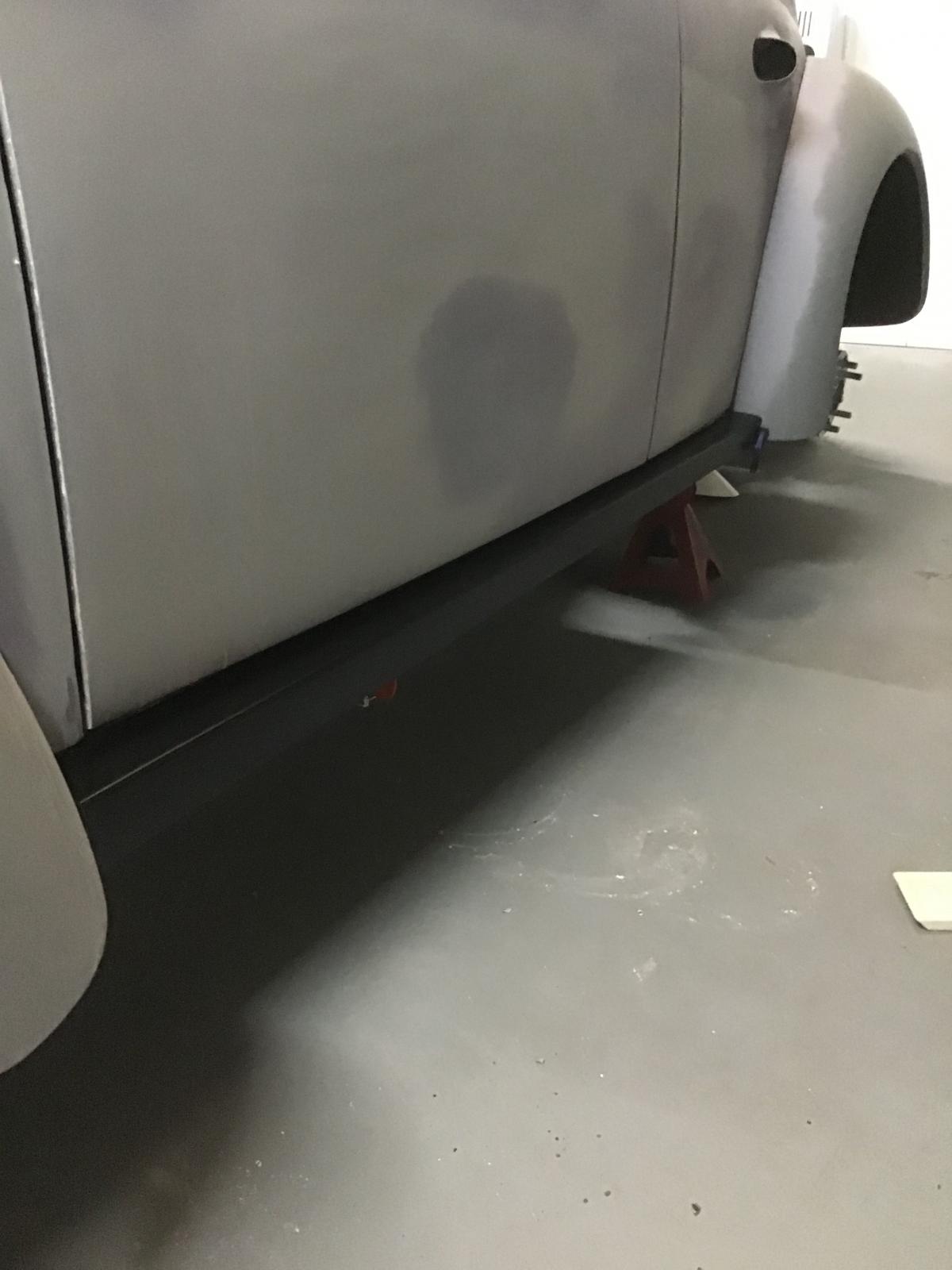

Did a little work on the rocker panels
With a little more hand sanding, cleanup & attention to some areas that will need some touchup...hopefully I can start applying the 2k primer.
