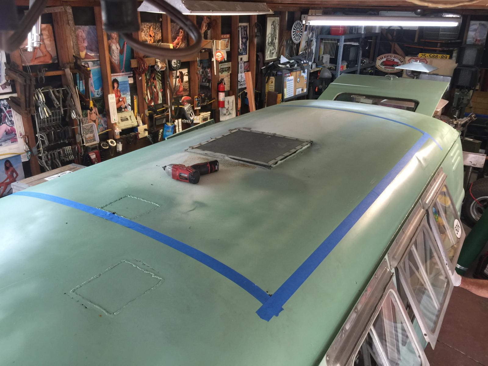

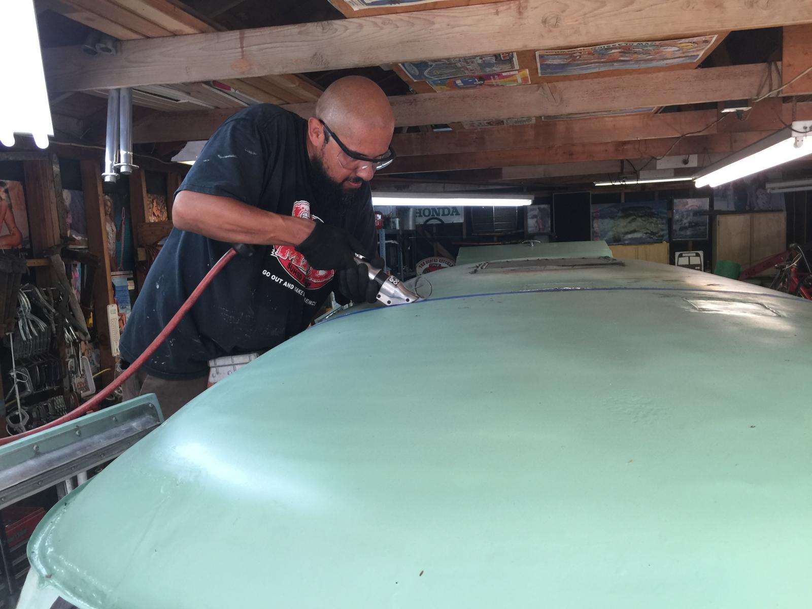

I helped David with his install last year. Cool
iveedubbin wrote:
Got the roof measured, checked, double checked and checked again before cutting.
Then got the shears and went for it.
Roof has a BIG HOLE in it now, ready to install Frame and Dormobile top.
The most important thing to do is to measure, then measure again and again and again... Once you cut, you're in for it!!! So it's important to get that measurement correct. However, as what happened to us when we did this last one, after the cut the sides of the roof "sprung outward" which gave the impression we botched the measurement!!!! Shocked
We then use a couple of long ratchet straps placed around the top and bottom of the bus to bring the sides back down in order to bolt on the steel frame. Don't recall if we took pictures of that. Confused
Anyway, it isn't all that difficult but it is a lot of work. Yes, it seems daunting but once you get it all done you will never regret it! Go for it! Cool

pyrOman wrote:
...after the cut the sides of the roof "sprung outward"
What did you do to fix it?
pyrOman
Fire Master
Joined: July 21, 2003
Posts: 12571
pyrOman is offline
PostPosted: Thu Apr 07, 2016 10:07 am    Post subject: Re: Dormobile roof mounting instructions Reply with quote
BarryL wrote:
Cool

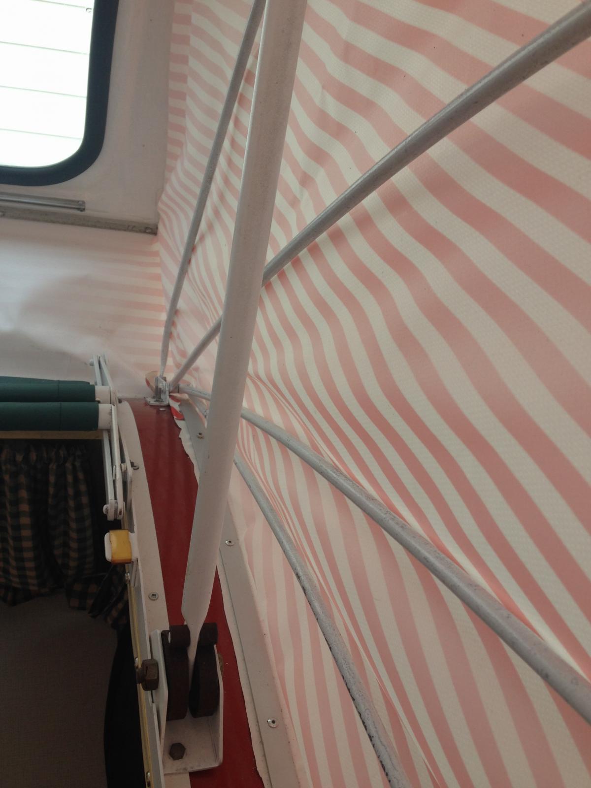

This was in January this year:
These are recent pics:
