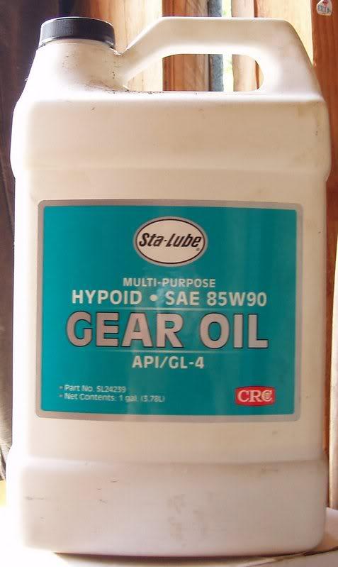

That said, for my own peace of mind, this is what I run in my VW, and it's been running and shifting about as well and flawlessly as a 57 year old, un-restored transmission could. I'm sure GL-5 would work in it just fine, but why take the chance when I don't have to? There. End of discussion and worry on my part.
(As an aside, my AH Sprite uses straight 30 weight, non detergent motor oil in its transmission. Shocking huh? Shocked )
