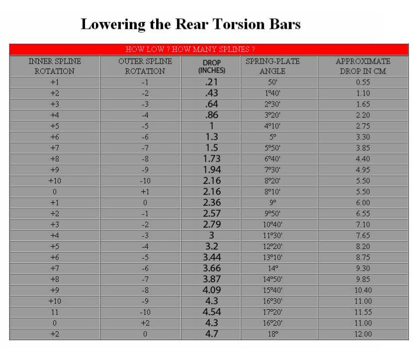

So monkeying around with ride height, I have static spring plates. If I replace the spring plate just one spline north, it looks like it will drop the ride height a lot more than an inch. When you guys made the comment about simply adjusting the spring plate, were you assuming I had adjustable spring plates?
Thanks guys, I appreciate the input on this..

No. There are splines on the inside end of that torsion bar, too. With one combo of up/down between the two, you can gain (or lose) about 3/16" ride height.

PostPosted: Mon Aug 22, 2016 7:32 pm    Post subject: Re: IRS Bolt on Like BusBoys (Are They Out of Biz?) Reply with quote
Huge bulb just went on!! Idea Idea now I get it!
I can do the math on moving in inner one direction and the spring plate the other direction.
Learning as I go. Cool. Thanks.

Bingo! There are a different number of inner and out splines to allow for small increments of change. I believe it comes out to just between 1/8" and 3/16" of overall height change per inner/outer spline combination.

Bay bus, early/late beetle, type 3 are all the same setup in regards to torsion bar indexing to adjust ride height. I did not watch the entire video, but it seems like he has the right idea.

PostPosted: Wed Aug 24, 2016 7:35 am    Post subject: Re: IRS Bolt on Like BusBoys (Are They Out of Biz?) Reply with quote
From the gallery:

OK...looks like I have the math. My approach, do math, measure from floor, eyeball, make fine adjustments, and get as close as I can to stock height. Roll the bus around the block a few times, see if all is good.
Thanks again for all the input from the community. Super helpful. I love videos so I will make a video of the highlights and post it. Work slated with my friends for Sunday. Need to research the best way to get the spring plates off safely.

Spring plates on a bus are a breeze. They aren't preloaded against the bottom stops like a bug. Just pry them off making sure not to pull out the torsion bar from the housing. Of course, this after marking the original orientation of the bar to plate and plate to housing.

Yes. I usually make a vertical line top to bottom over the whole thing. That way, If things get wonky, you can always go back to your starting point.
