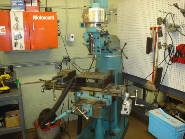

That is a beautiful Brigeport!!! If I may, send you a few PICs and tricks on the ACE method of how we hold down cases and heads..
I will get some PICs. Maybe I have some in my PIC gallery here on Samba..
I built several tools to help make holding and clamping Cases and heads that I haven't seen other do.
NICE MILL!!!!
Art @ ACE
By making this Bridge "Frame" 3/4 Iron... Had it made by a Fab shop in area, then they Surfaced Ground bottom and top.. Very flat..
Dial in on the Plate.. After its bolted to mill we never move it. Very handy to bolt other work to also,,

look out art that mill is the rong color!! YOU MIGHT BE IN FOR SOME FLAMING!!! Rolling Eyes I make almost all my jigs,was gonna build the sine plate but not a big difference in price with the cost of materials these days.. my brother has a mill that looks just like that one.

Whats so crazy!!! is that mill has been a great machine.. I Like the RONG color..... so funny! Love this stuff
