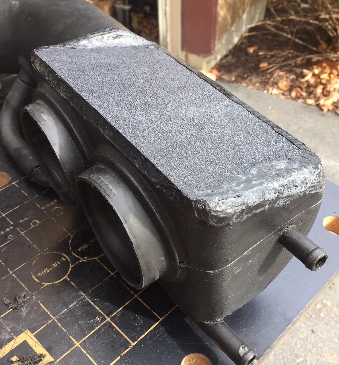

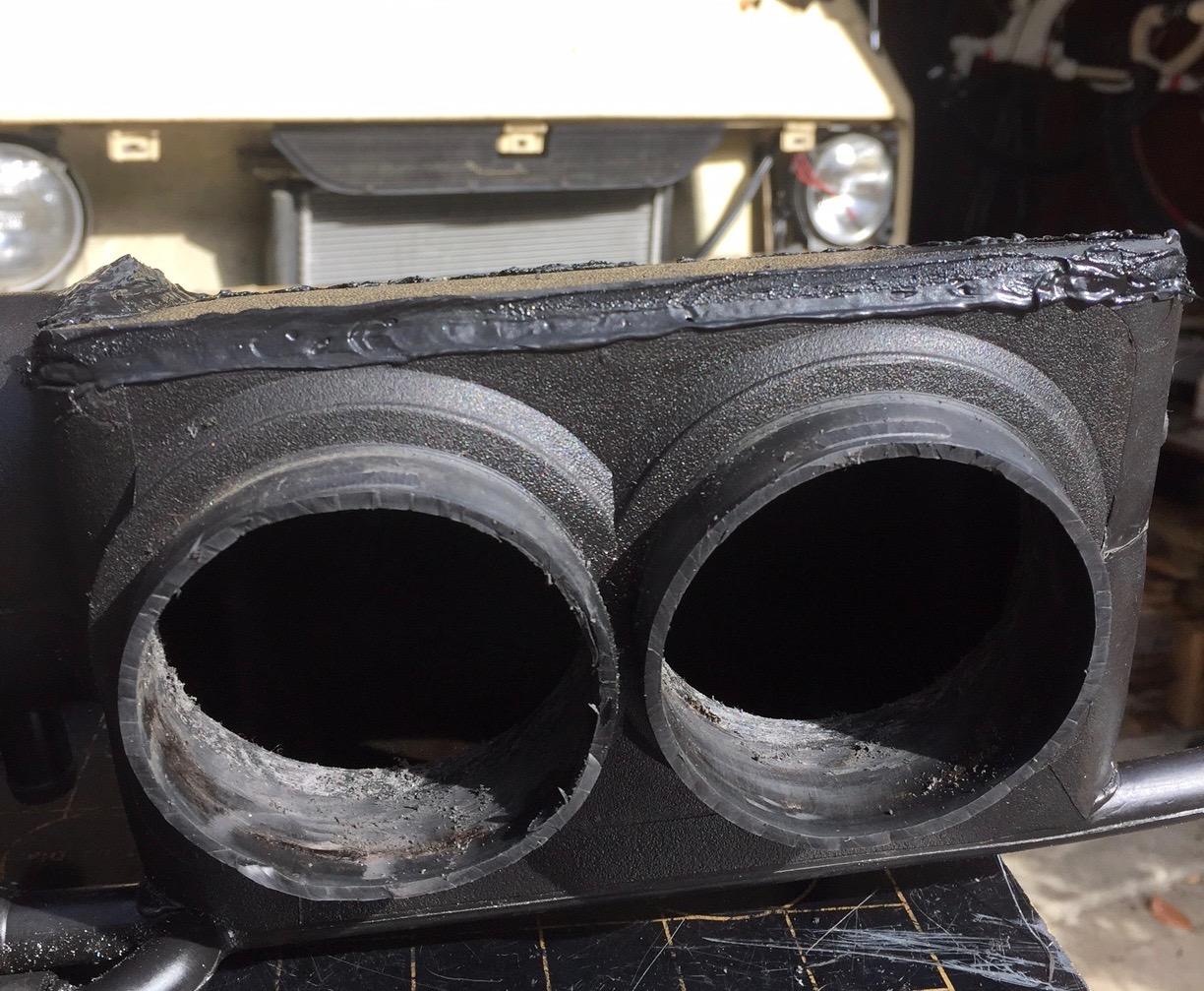

I wasn't able to find any information proving that the stock SVX airbox could or could not be used with just some sheet metal clearance work at the front of the engine compartment of an air-cooled van but I can now do so. Modifying the stock SVX airbox is necessary. Rocky Mountain Westy used to make a nice, narrow, aluminum unit but that is no longer the case. Without much to lose I decided to see if I could modify the airbox via plastic welding. I found a plastic welding video at youtube
https://www.youtube.com/watch?v=QBAs4VDzkew
The video mentions the Mini-weld model 5 airless plastic welding kit. I ended up with the model 6 off of eBay for about $90. It is basically a soldering iron with a temperature control unit for various types of plastics.

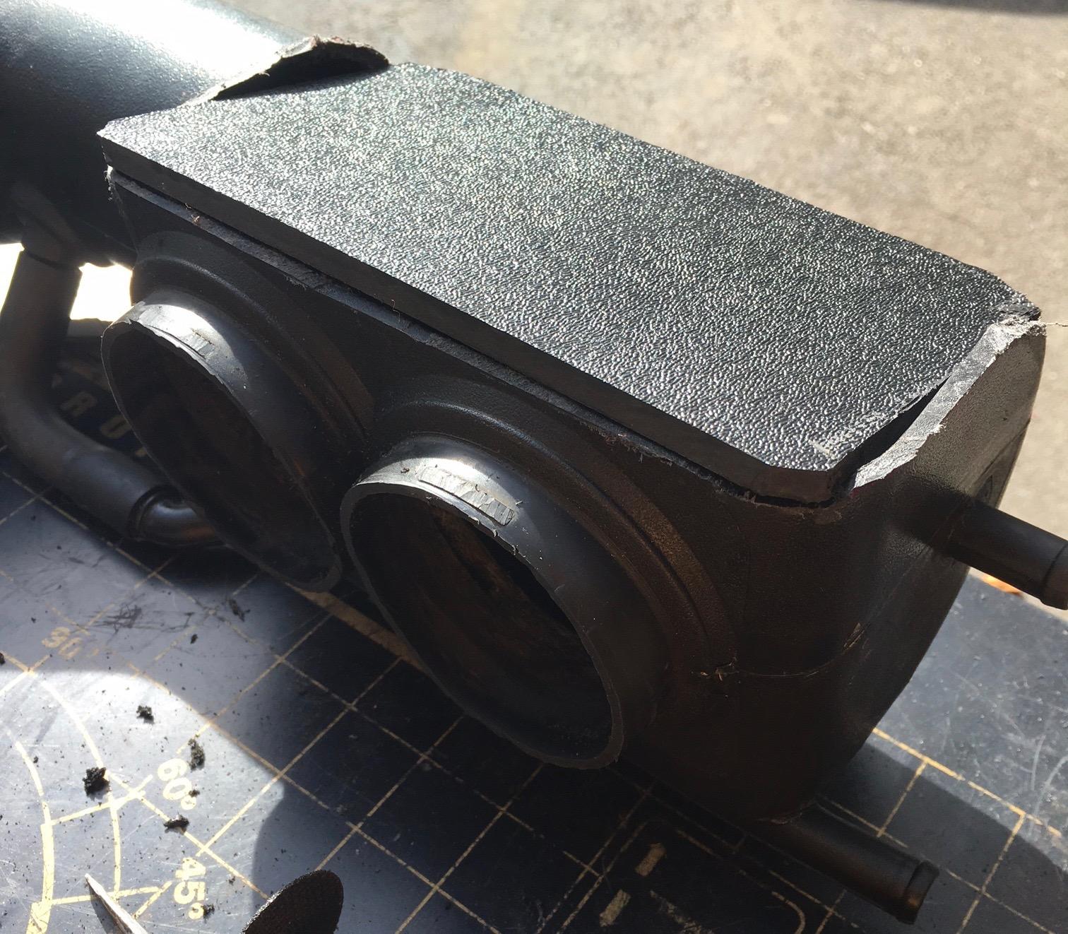

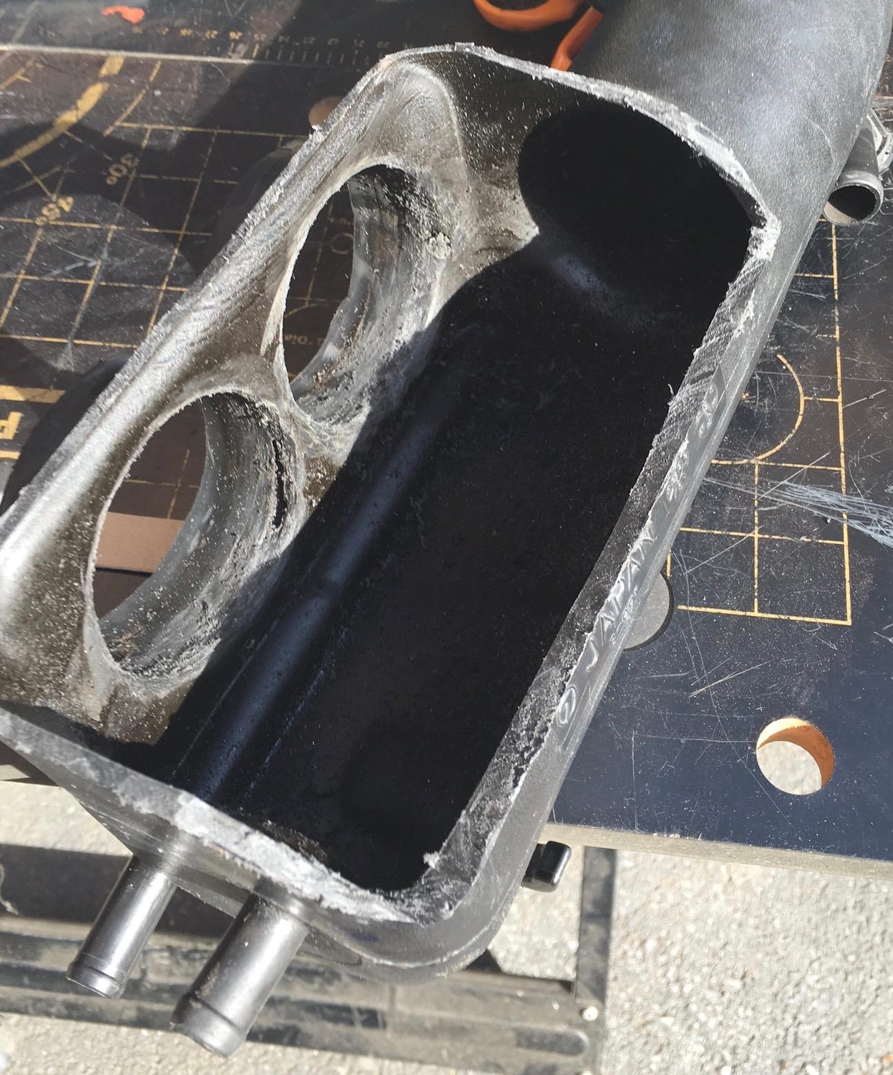

After sizing up the necessary cuts with the airbox in the van I cut the top off of the airbox.
Then I created a cardboard template and cut the necessary piece out of a 12" x 12" sheet of ABS plastic I ordered online.

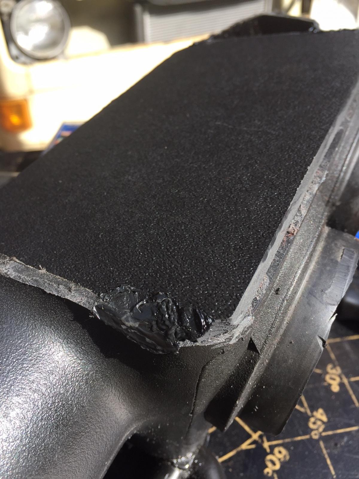

Tack welded the piece in 4 spots to keep it where I wanted it while I began welding.
My skill at plastic welding improved dramatically as I worked. I did just a few minutes of welding on the two pieces I cut off the top of the airbox but I'm too impatient to practice for long. Here is the final side weld I did before I touched it up at all.
Here is the finished product. I used the "R2" black plastic welding rod in the kit. The "ABS" rod in the kit was white although you can order black. I found the white rod gave a milky appearance to the finished weld even if it was worked in. I really have no worries that this modification is not air-tight or strong. If I have any problems I can take care of them easily with the plastic welder.
