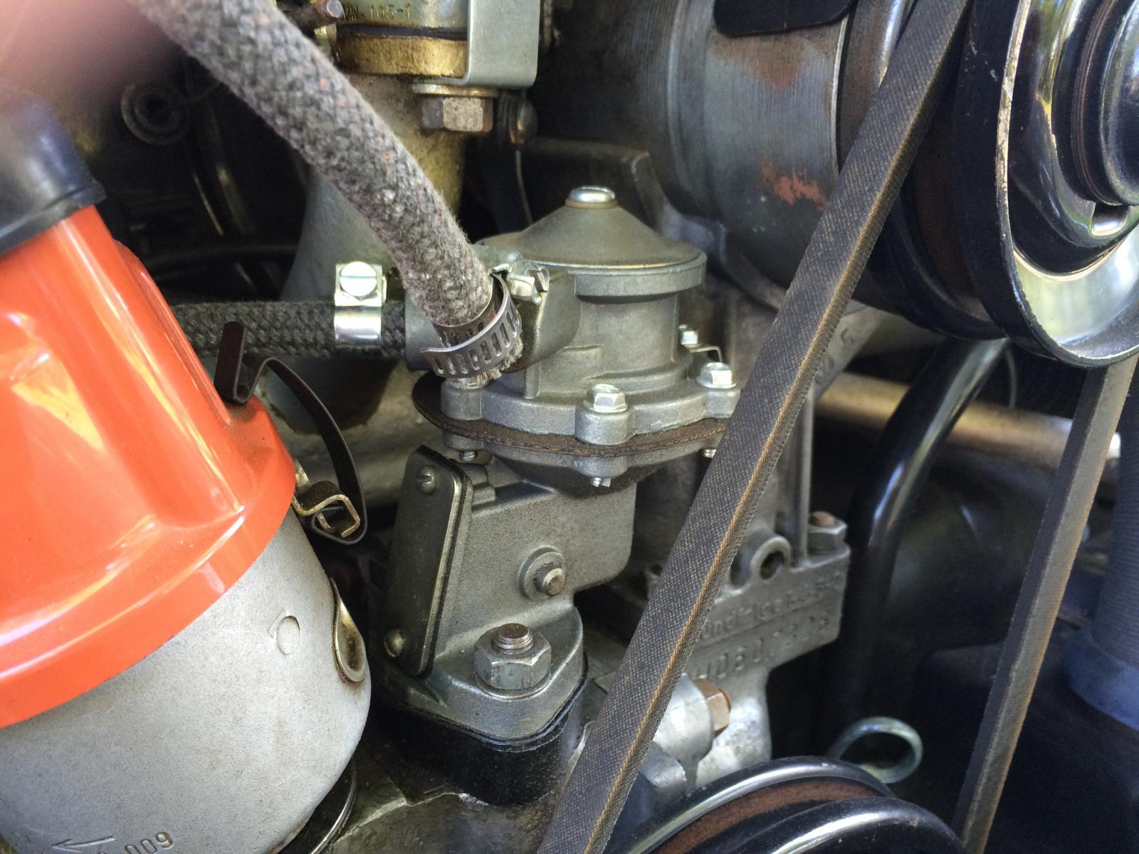

Swapped my Brosol fuel pump for a rebuilt Pierburg in my 67 sedan. I have had hot start problems all summer and tried everything. One day it just shut down like I'd turned off the key. The pump push rod may have been restricted, opened up the Bakelite insulator but still had a no start when hot, so now the Puerburg is putting 2.5 psi into my 34 Solex feeding a 1600 dual port

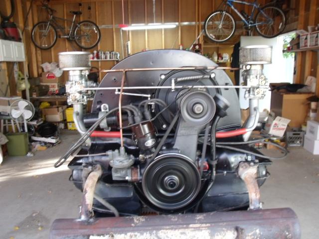

PostPosted: Tue Oct 18, 2016 6:08 pm    Post subject: Re: What did you do to your Beetle this week? Reply with quote
freshened up my 36 HP stoker for my 60 ragtop Very Happy

60ragtop, that looks nice. And running too. I sometime want to tackle one of those 36hp engines with the dual carb mods and all.
Just have to get the funds together.
Nice work.
Very nice. Is this the Okrasa dual carb kit from WW?

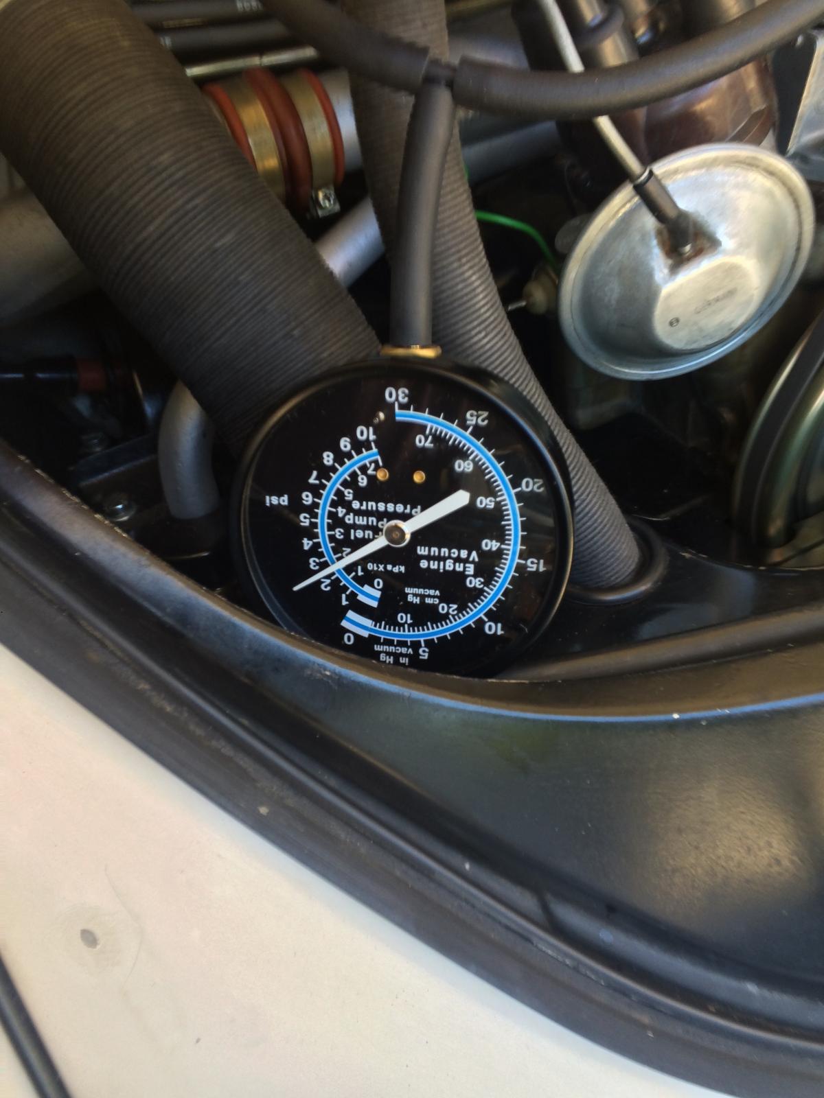

I made up a bracket (got the idea from someone's post but can't find it to give credit) and installed a fire extinguisher. Since the pics, I painted the bracket satin black.

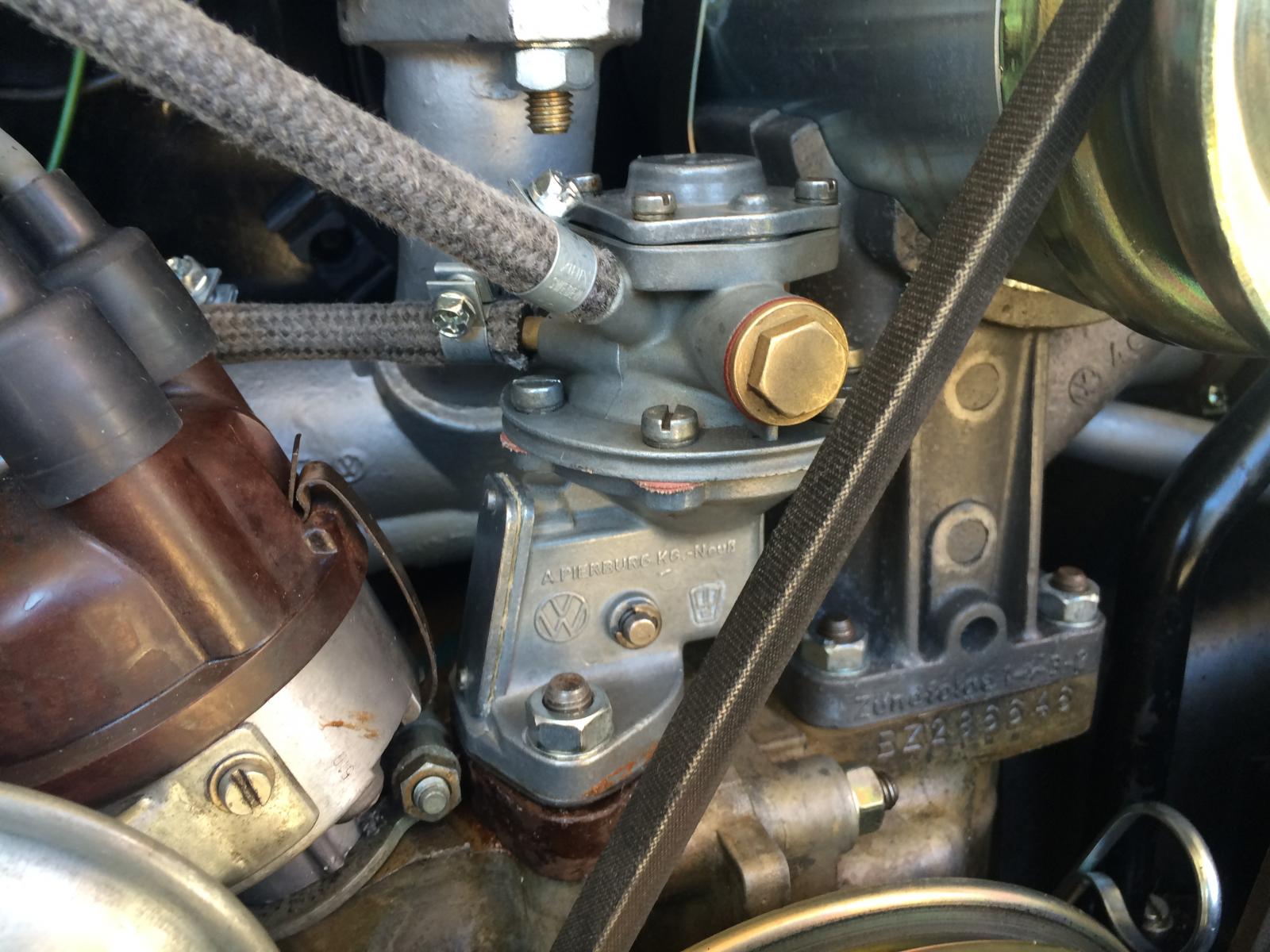

Installed one of Ed Fall's rebuilt Pierburg fuel pumps. Since the pic, I safety wired the outlet hose (already safety wired the carb. inlet) and replaced that worm-drive clamp with a proper one.
