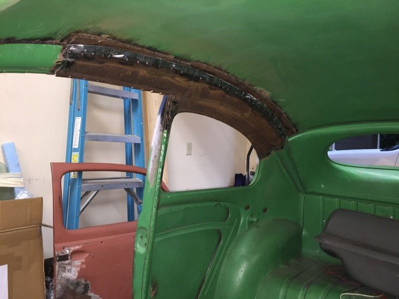

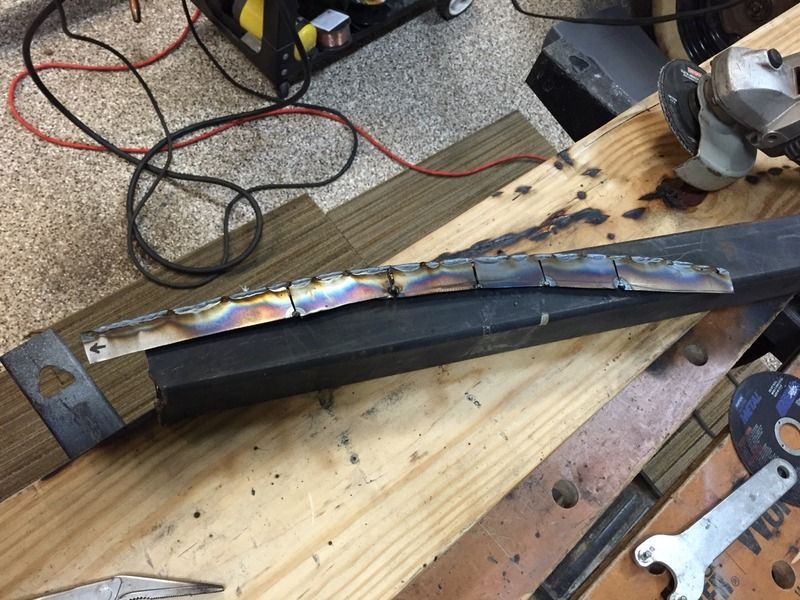

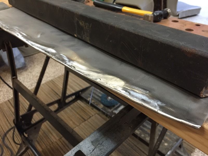

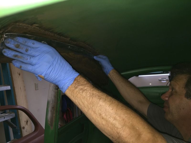

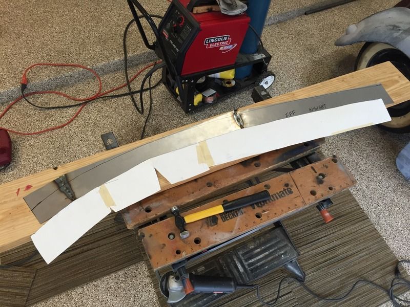

Small update this time. We figured out a fix for the headliner dilemma... kind of rigged but it will be hidden from site / should do its job. Ended up using 22ga sheet and some 1/8" rod along with a new toy from HF (electric shears).
Shaped template using poster board:
Adding the rod to the edge:
Test fitting:
Tacked in place:

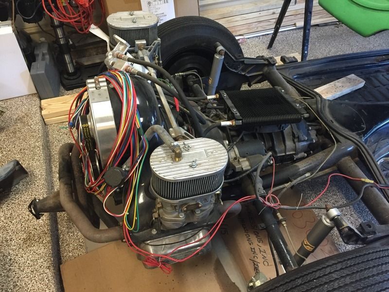

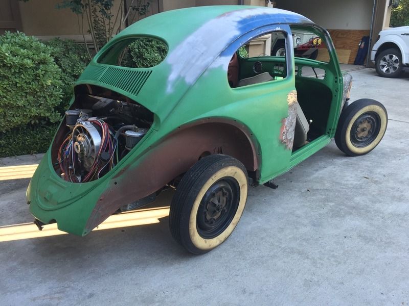

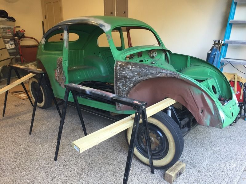

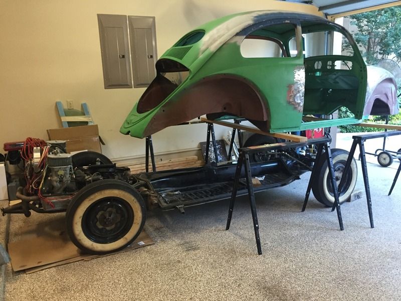

Also spent some time this weekend building a rolling body stand, I'll post pics of that once it is put together. For the meantime, we pulled her out to dust off and got the body up on sawhorses so we could get access to the engine (shoe-horned in there).

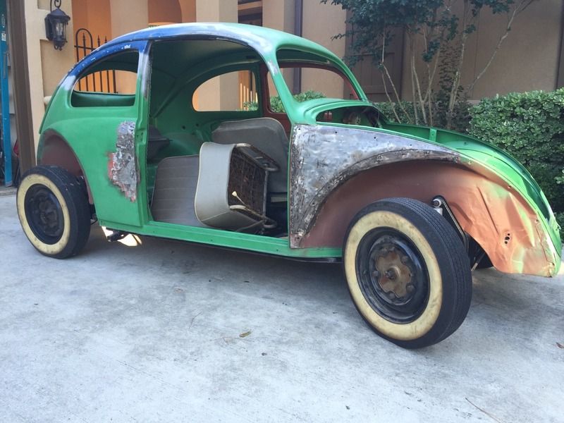

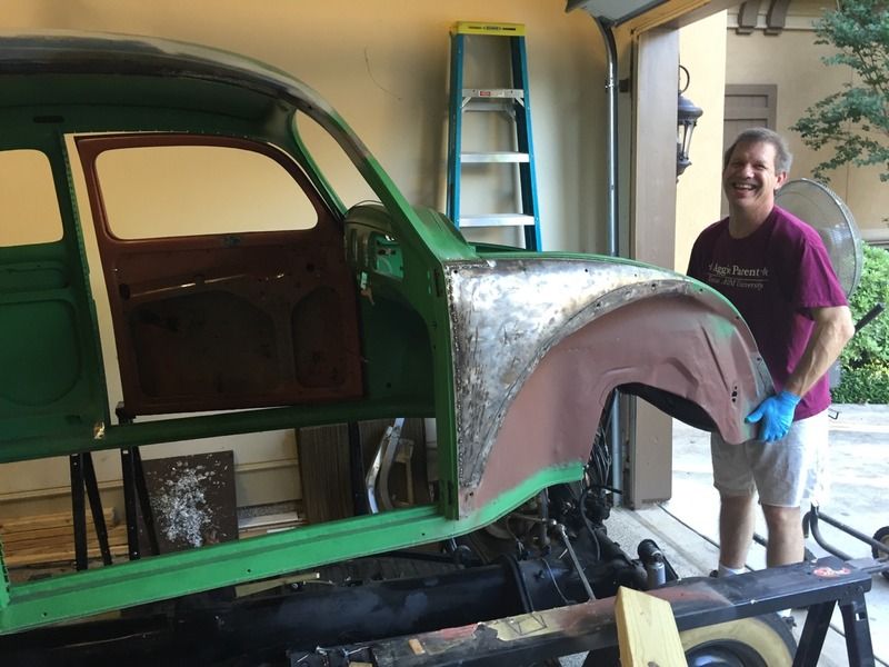

Also, Dad finished up most of the welding on the front quarter repair:
Lifting in stages:
Up on the temporary stand:
