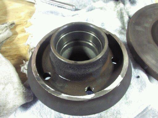

Anyway!!! So these gti calipers...288mm rear rotor outside diameter, with a 5x112 bolt pattern, and the calipers have the mechanical e-brake on them that I can retro-fit the stock vanagon cables to fit!!! Decided to get these, also the pads you could probably get anywhere same as the rotors Very Happy . OK so i need to make some brackets to make these things work and find out how thick they need to be to get the calipers centered over them. Im running spacers as well which doesnt really matter but ill throw that in there! Here we go Rolling Eyes .
Disc and rotor. The hub doesnt exactly fit inside the rotor so I had to machine some of the OD of the hub down to get to fit( sorry no pics of that)

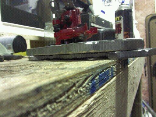

Brackets are a 2 piece design I came up with.. Probably would be better/stronger if it was a single piece but this is what I did and its been holding up fine!!

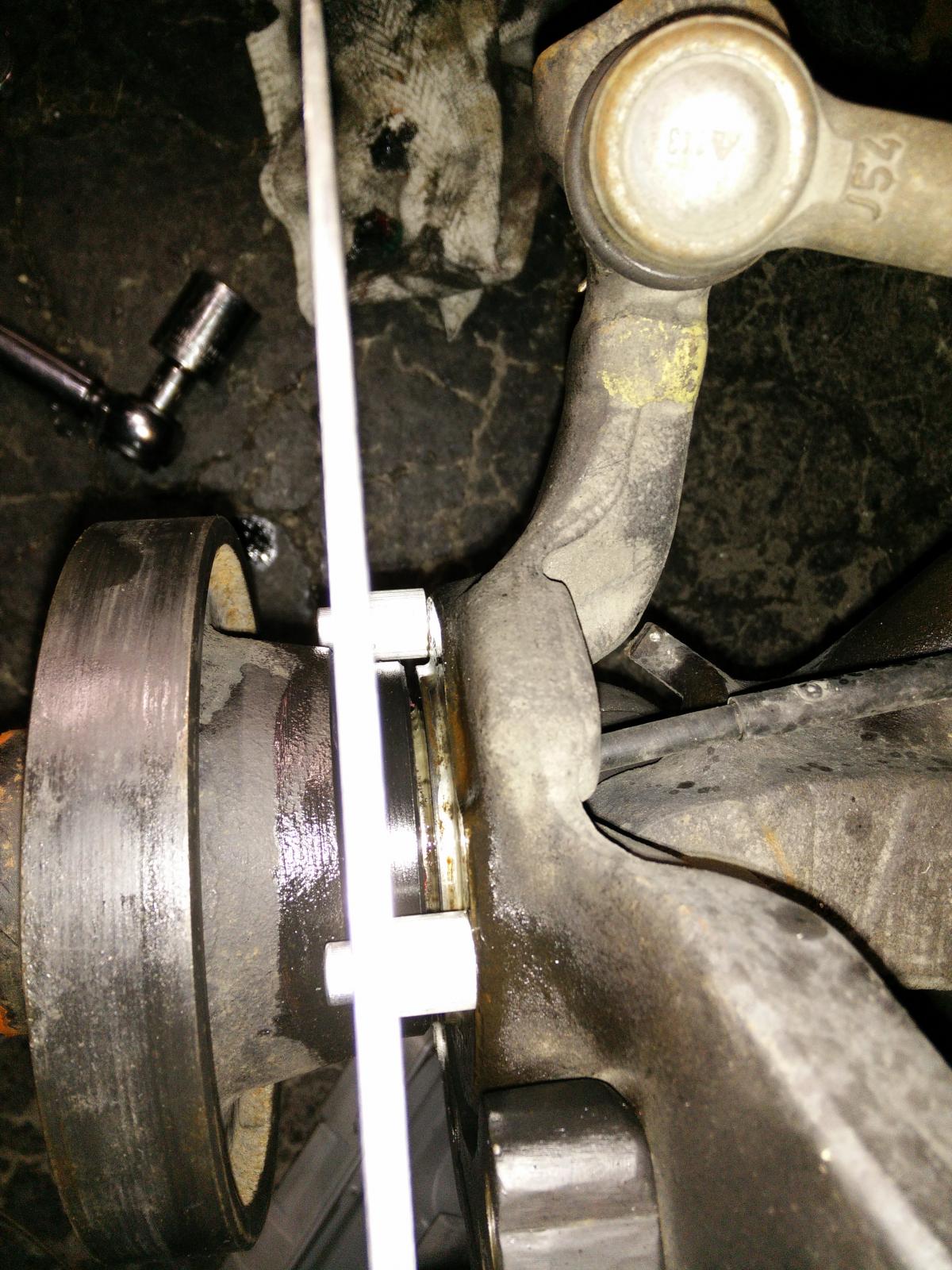

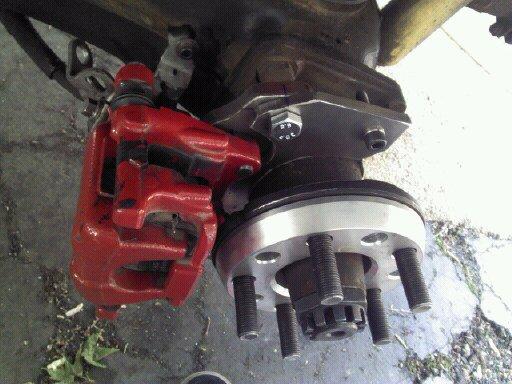

This just showes the offset and the caliper mounted up
The bracket mounted up (actually looks like it will work Very Happy ) You can also tell that the hub outside diameter has been turned down and is not as big. Basically the same dia as the spacer which has an angle machined on it to match the angle on the rotor. Its a lot of figuring out because NOTHING is supposed to be here Shocked

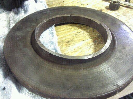

SO first things first, the discs have to fit on the hub, well my hub already has a disc on it with the bearings inside... With a LOT of thinking, i decided to cut the disc off and make my own hub.
No turning back now Shocked
All cut
Heres what I want Idea
Now I need the hub to fit inside here so the disc can bottom on the hub

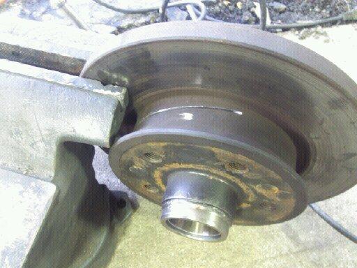

So I ended up having to machine the hub down so it would fit inside the disc. You can see the machine marks here and can tell the hub has been turned down (sorry not the best pic)

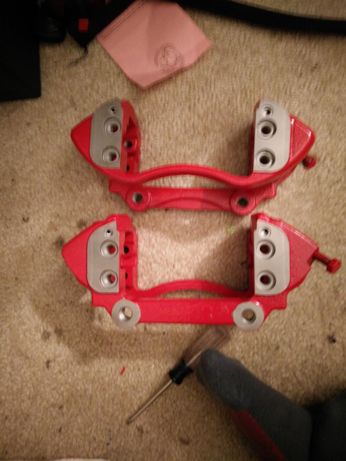

Ran this for a year and wanted to ''freshin up'' my calipers a bit Cool
Fresh Red powedercoat to match the rear

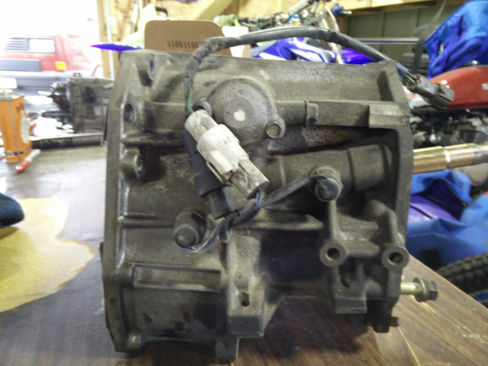

Ok lets talk transmissions.. I was running a Subaru with the Vw trans for about a year. The transmission I knew was toast but decided to run it with the new engine and get it running good then move on to either getting a rebuilt trans or possibly Subaru... After LONG hours of research and debating mentally... I figured id go big and go Subaru. Which requires me to build my own trans (you can buy already built but you sure do pay for it$$ Shocked ). With an already huge price tag I figured id do it and save some money. This was not easy and took so many long late hours of research on the Subaru gears site, the samba, various Subaru forums...exc. There is a lot of decisions to be made, what linkage, trans, which gear ratio to go with...the list goes on. So heres what I ended up with
JDM 2002 WRX 5MT transmission (40-50k miles)
Quaife QDH3Y STI Limited slip diff
RS Fab Parts shift linkage
2 Left hand Automatic Transmission axles(short) 531mm (20,5'') Lobro joints
New OEM Subaru clutch with Subaru starter
New front poly transmission mount (T3 Technique)
Had a new clutch line made up from the plastic line(off clutch master)to trans

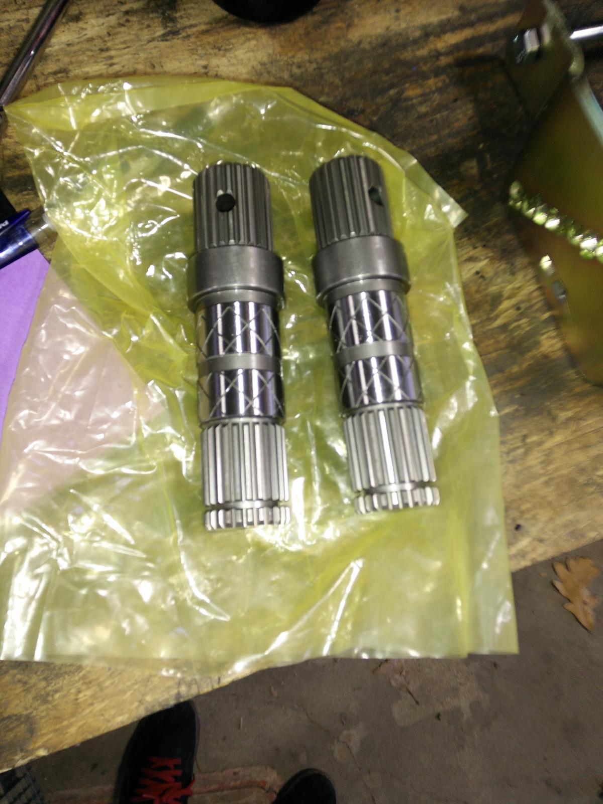

Subaru Gears Kit with 4.44 gears, also stub axles, and front trans mount
New SUBARU bearings for my diff, also random gaskets/seals
I might edit this list if I come up with anything important I forgot, but for now I think that's it!!!
Ok first things first, buy a transmission Very Happy
SWEET, It even came with a starter, a full clutch setup, and the speed/neutral sensors Dancing .... NOW WHAT??? I have this transmission, never seen one before, or even took one apart (from a car). And its apparently going in my van?? You just have to keep moving, cant give up now... just dropped $1,300 on this Shocked .

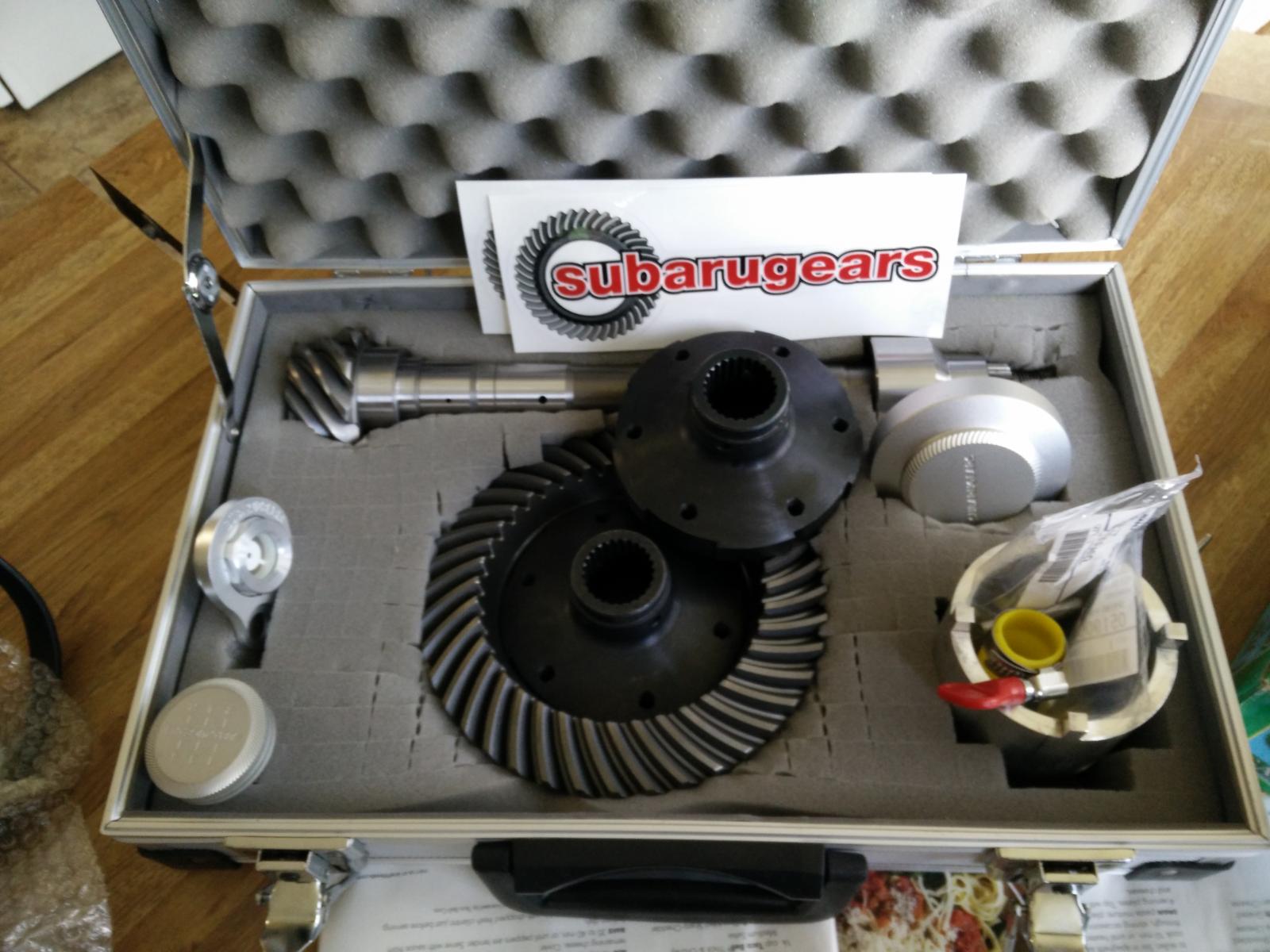

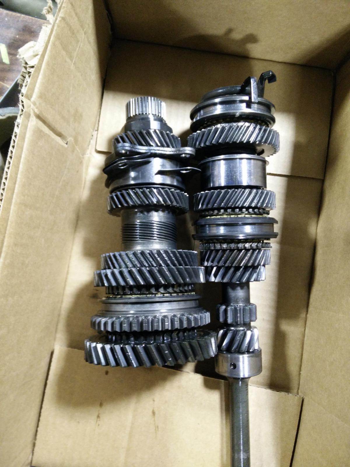

So lets drop another $2,300 on Subaru Gears!!!
Sight Glass
CV Joint Adapter
stub axles
Subaru trans to Vw mount (so itll bolt to the van)
All of this stuff if VERY good quality, you get what you pay for.

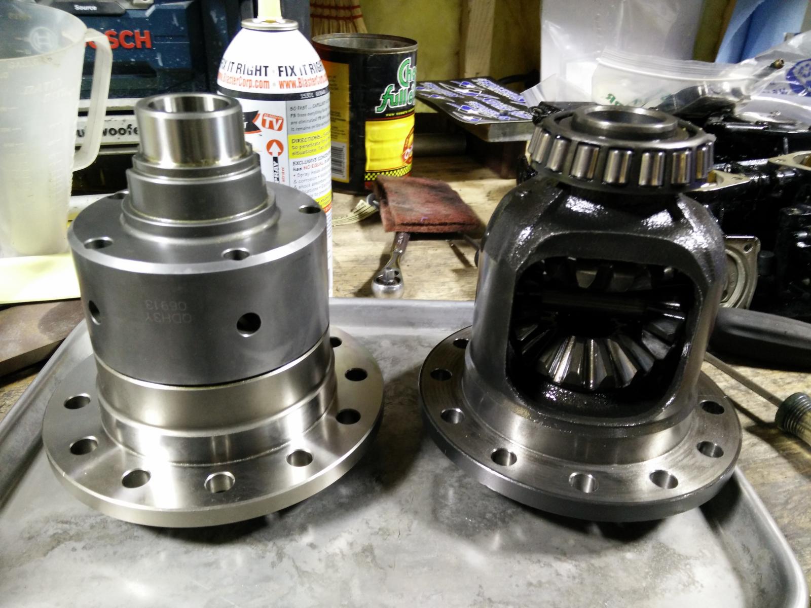

Well I'm not building all of this and going to be spinning my wheel around turns and getting stuck at inconvenient times. So lets buy a Quaife ATB limited slip diff Applause (which is somewhat difficult to get, they are in the UK and sell EVERYWHERE...Except the USA..figures..)
Ebay score for $800 (you see the pattern here Laughing )
Quaife on the left

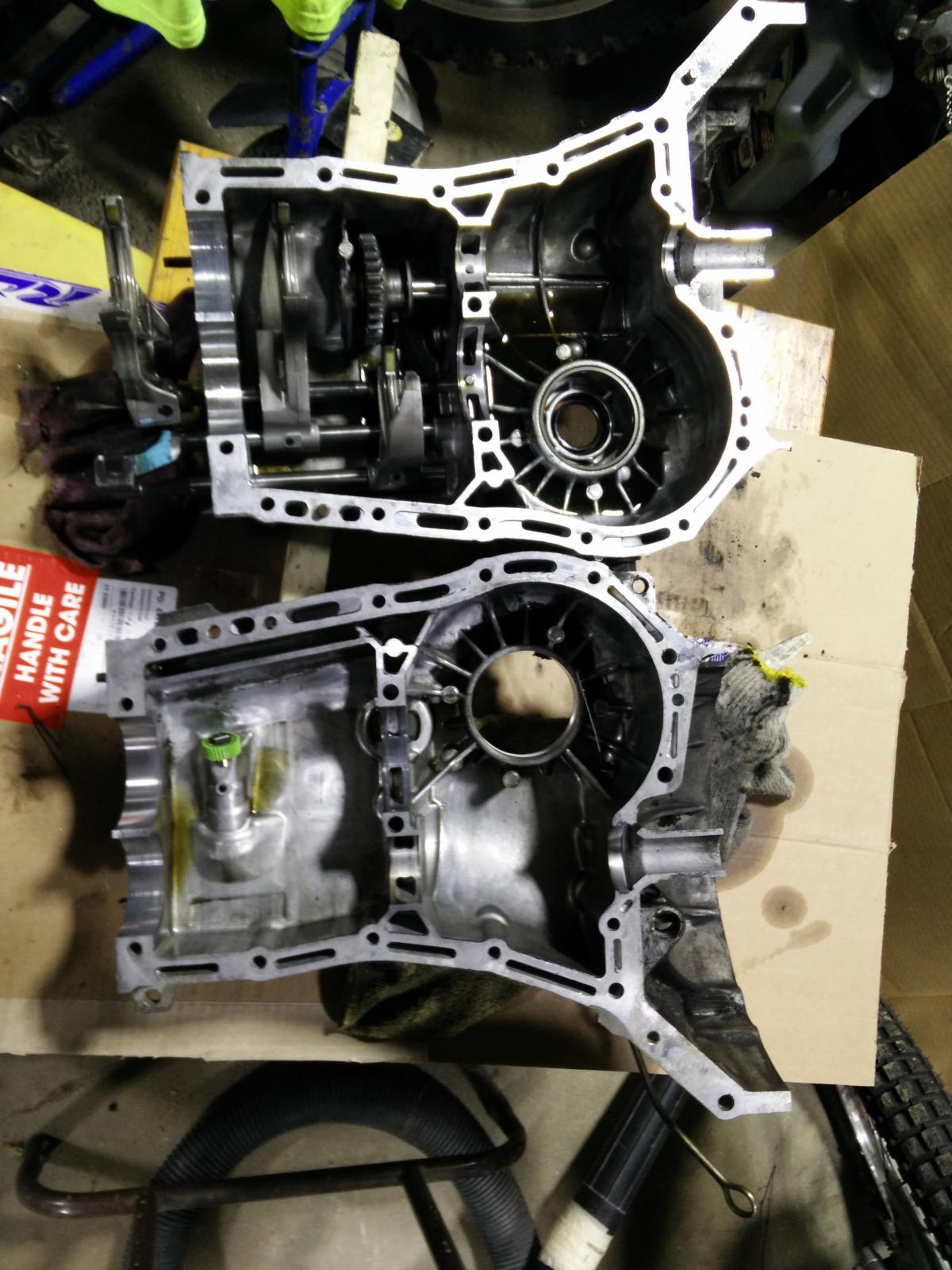

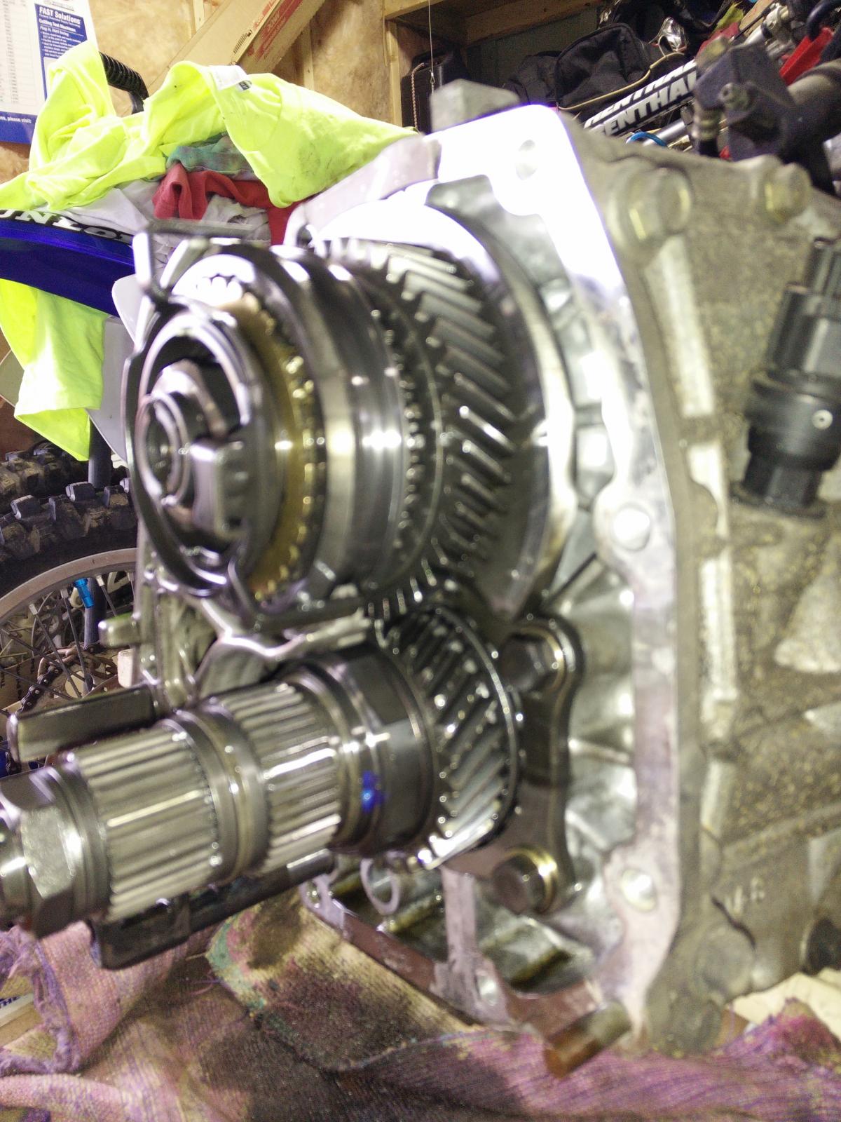

Ok so now I have most of the stuff, lets get some champagne and tear this thing apart!! Also take loads of pictures so when it comes flying apart I know how it goes back together Rolling Eyes ...I have SOOO many pics from this, so ill just upload the basics..

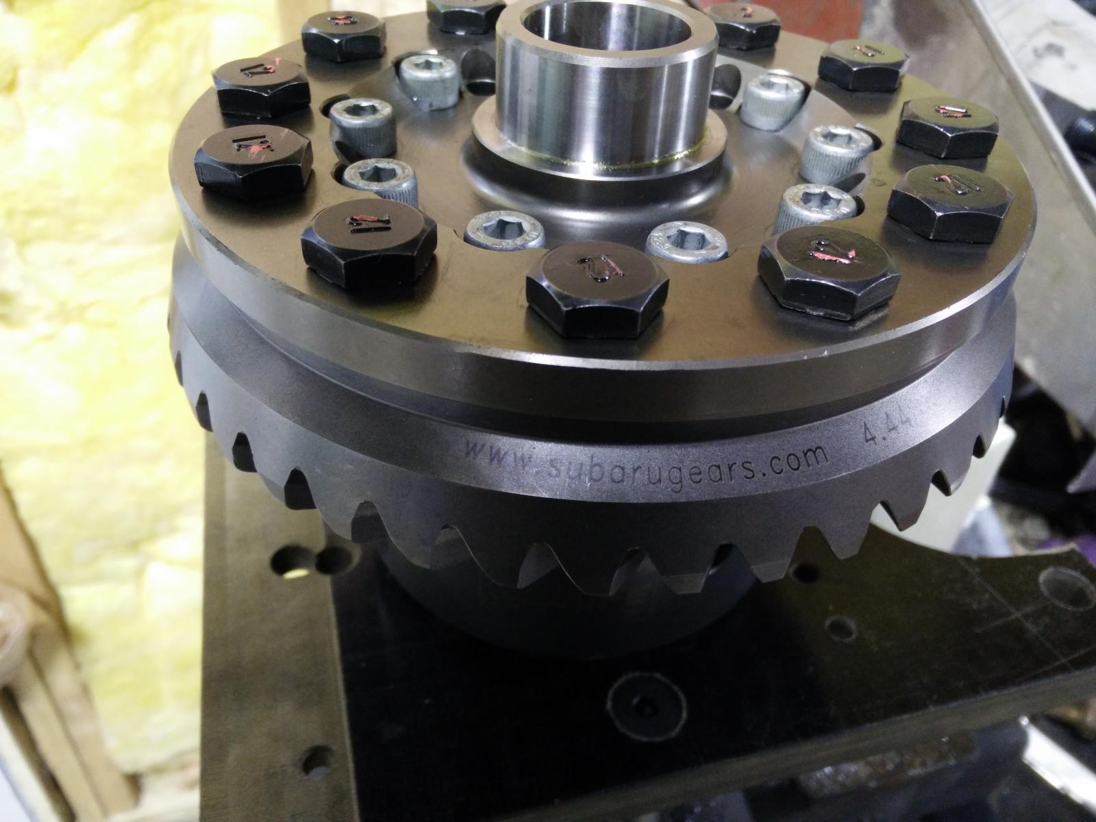

NEXT STEP... Lets get this reversed cut ring gear on my Quaife diff!!! (was kinda nervous about all this going together because the diff is from the UK and these gears are from Australia that are going in a Japanese transmission, that's being assembled in the USA, and of course going in my German van Shocked )
First, there is like 12 bolts holding on the ring gear to the diff... I have NO way of holding this, but it has 5 holes
and since I can make things at work, I got this under control, I just got a piece of phenolic and made a bolt pattern with 5 holes in it, at the specific diameter(don't remember what it is) and reamed the holes, punched in some dowel pins.... this little fixture worked perfect!!!
Tightened everything down and torqued to spec with red locktite and we're good to go. I cant for the life of me figure out how to get the pic of my fixture uploaded, ive been messing with it for like 30min now, Ill edit it later.... Ill continue this write up another time. (promise it wont be months like last time)
