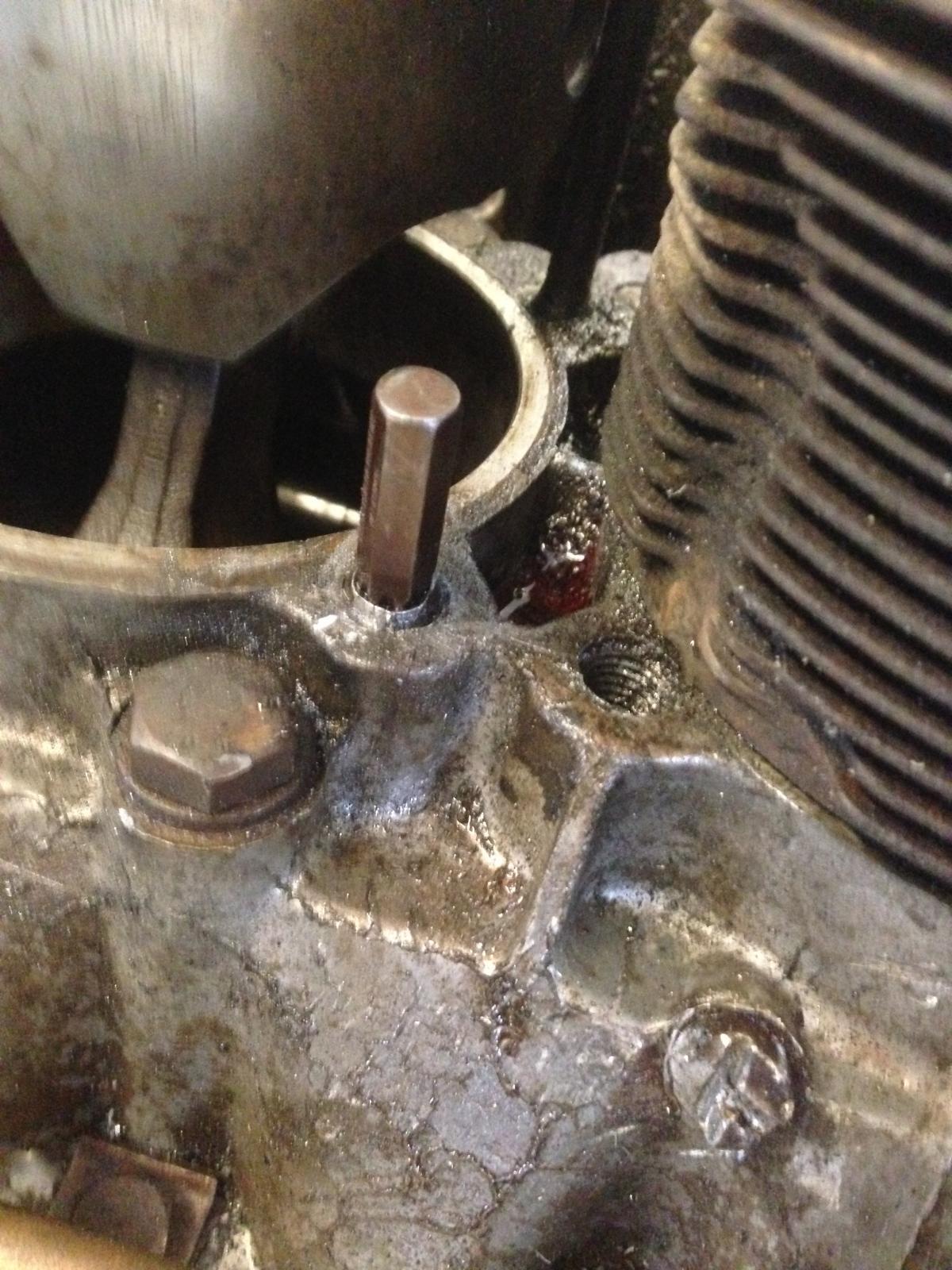

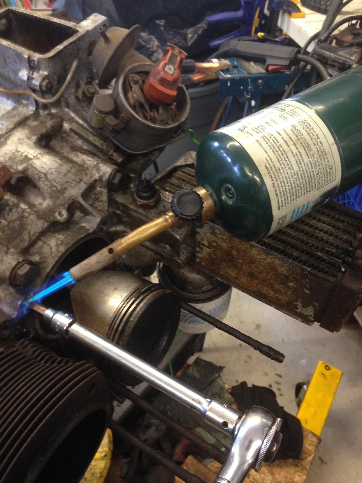

Ok, Here's how I made out, and thanks for the replies..
I hammered the EZ out extractor, put some heat on it, peened the stud around it slightly with a cold chisel and ball peen hammer, peened the boss slightly too and hit with some penetrating mixture and left it for the night.
This afternoon, tried it and would not budge..
Put some more acetone/ATF mix,put some heat on and had a beer and watched the torch..
I tried it again, no dice, I was afraid of twisting the extractor off and breaking it so I moved the heat further away from the stud and heated the case itself, with the idea of expanding the boss and not the stud itself..
MOVEMENT! This came about after heating and dribbling penetrating fluid (kind of boiling it in the threads)
Carefully moving it back and forth, the stubborn whore gave way..

Yeah, I didn't have much faith in the EZ out either, ( had sheared one off with a broken exhaust stud on a head)
I figured if I had to apply much more than 40-50 foot pounds it wasn't going to turn out well...
Amazing how clean the rest of the threads are compared to the trouble first few.. Doesn't take much to ruin yer day does it? ..
And yes..these are very high tensile steel studs, cobalt bit is a must
