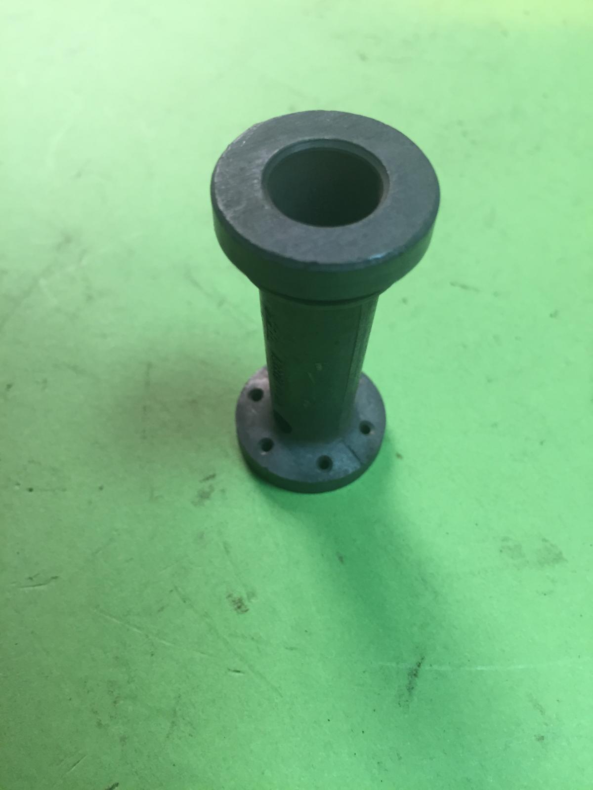

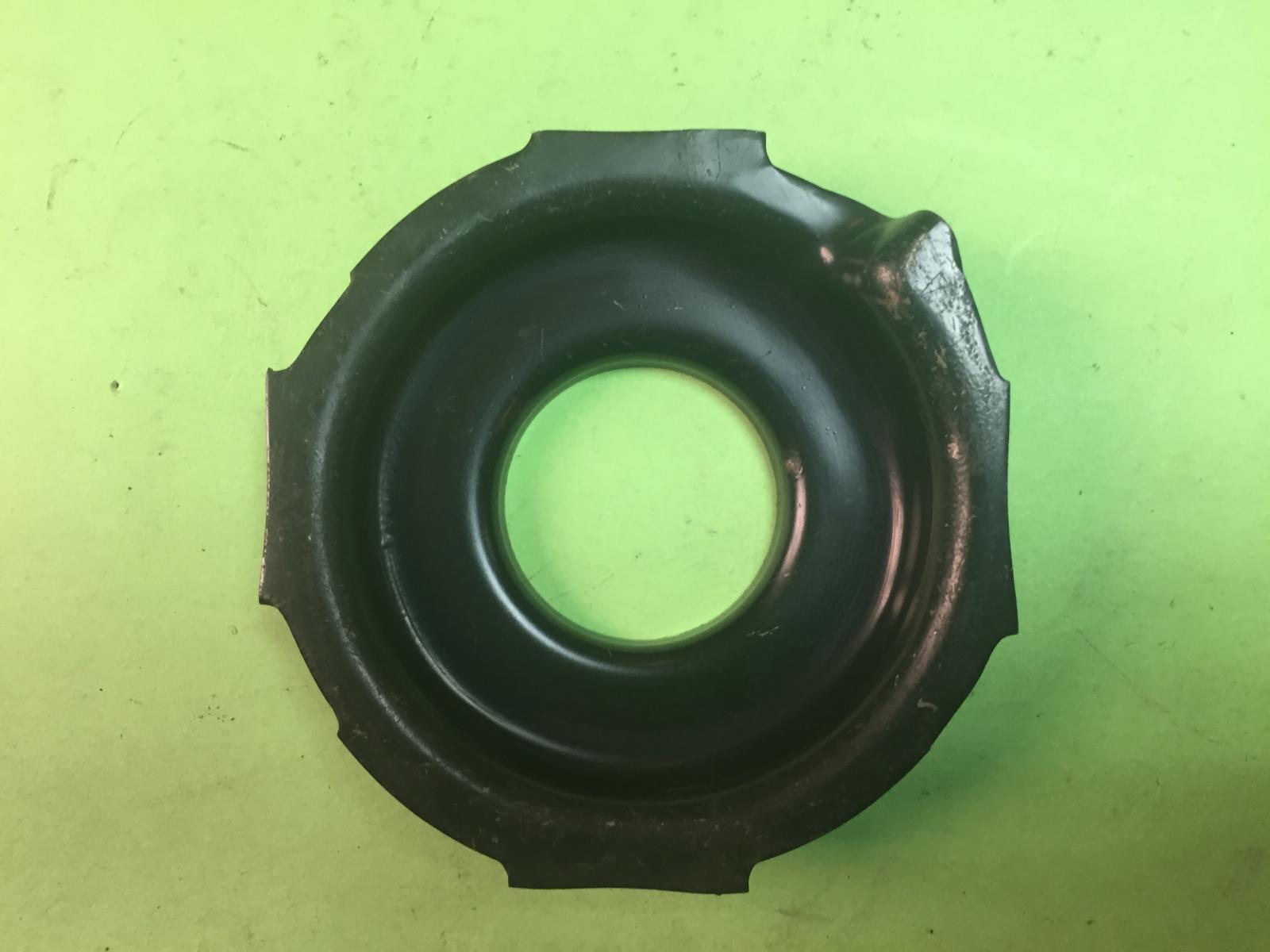

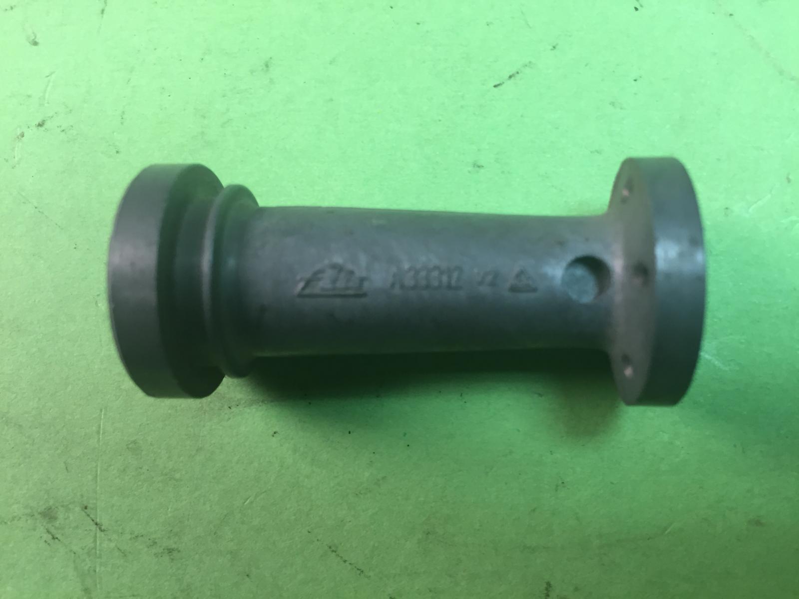

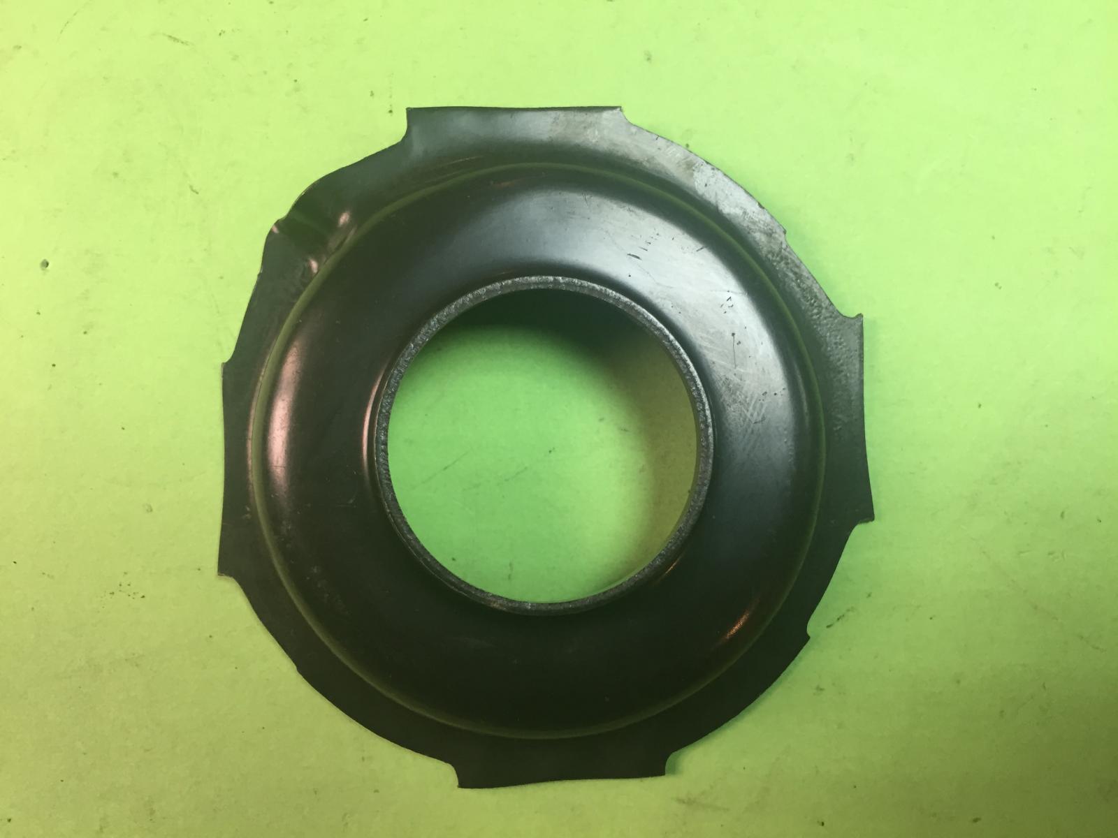

I found these parts in the old stock I bought here in Egypt, any leads about them
Thanks

Hard to tell without a scale, but my guesses are:
1-4. ?
5-6. Master brake cylinder piston
7-8. ?
9-10. Thermostat air control ring on fan housing
11-13. Rear axle cover

1-4 is a flame retarder for a mid 49 and earlier gas tank. Rarely seen and hard to find. Last one I saw was in the $400 range.
Yes and this is a 55-down one since it has the earlier style nuts on the back

it is not split beetle era though because it is the later two piece design.

11 to 13 is a pinion bearing retainer for 60's vintage tunnel transmission, not a rear axle cover. Very Happy
