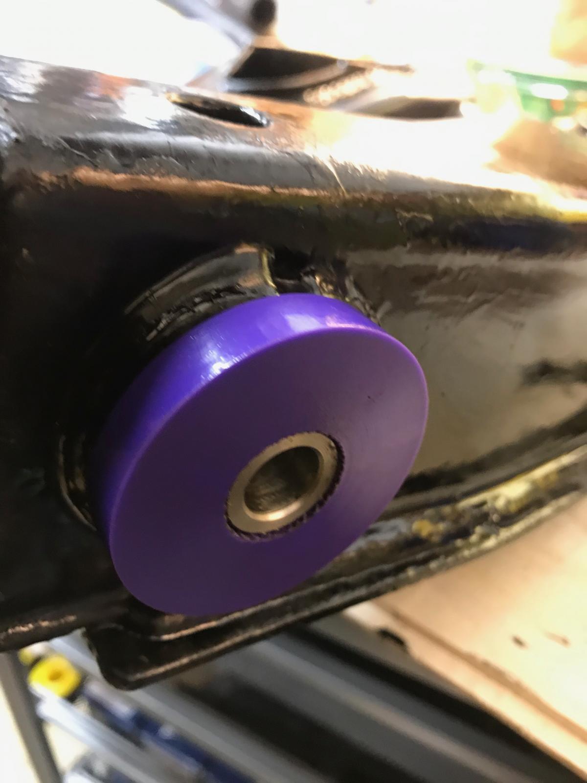

PostPosted: Fri Jan 03, 2020 6:05 pm    Post subject: Re: Powerflex suspension bushings Reply with quote
I'm installing powerflex bushings in the lower control arms on my westy. Can't find any instructions or technical data on how to assemble this.
I would have thought that the bushings should move freely with the arm in the body (shackle) and hinge on the tube clamped to the body (forming a bearing). But the tube is shorter than the bushings when installed in the arm see the photos. The bushings will obviously touch and rub with the body when I bolt this together.
Is this normal? Should I lubricate the end of the bushings?
Christopher Schimke
Joined: August 03, 2005
Posts: 5525
Location: PNW
PostPosted: Sat Jan 04, 2020 9:27 am    Post subject: Re: Powerflex suspension bushings Reply with quote
Yes, that is 100% normal. And absolutely, yes, you definitely need to lube the ends of the bushings LIBERALLY as well as lube the bushing where is slides into to arm and lube the inner bore really well before sliding in the sleeve.
The number one mistake that people make when installing these bushings is lack of lubrication. When installing any urethane bushings, keep in mind that you need to liberally lube every single surface that touches anything at all. In other words, if it touches air, it's okay to leave dry. but if it touches metal, other urethane, plastic, etc., it needs to be lubed really well.

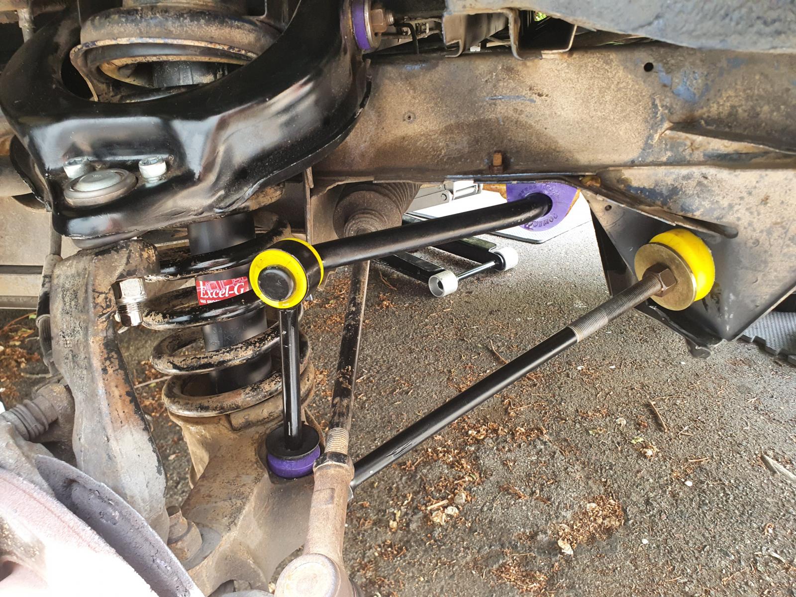

PostPosted: Thu Jun 04, 2020 3:21 pm    Post subject: Re: Powerflex suspension bushings Reply with quote
Finally got around installing Powerflex on the front end (2WD 1990), along with new Moog upper ball joints (Thanks Chris).
A couple of tips/notes:
- Watch out when tightening the bolt on the drop-link, below the Lower Control Arm. The droplink rotated so much that the sway-bar to endling bushing popped out. Frustrating.
- I found that the amount of grease supplied was not enough. I'm sure it is when you know exactly how much to apply and you don't make mistakes. But for a DIY mechanic like me, you're not sure how much to put, and you end up repeting some tasks 2, 3, even 4 times (see above for an example). It's part of the learning curve, but every time I need to apply some more grease.
- The Youtube tutorial from James Akers really helped, as well as T3Technique's Youtube tutorial on the endlink to swaybar bushings. To install the new bushing halfway in the droplink, I cut the old bushing in half, like so:
You pop that in the droplink eye, and push the new bushing from the other side. No need for a vise, just stepping on it with your foot does it.
-Is there an orientation to the dropling to lower control arm bushings? It seems that one side is slightly taller than the other (left side on this photo):
'90 Little Blue Truck, 2WD auto, FAS GenV 2.0 NA (AVH)
Christopher Schimke
Posts: 5525
Location: PNW
PostPosted: Thu Jun 04, 2020 5:06 pm    Post subject: Re: Powerflex suspension bushings Reply with quote
Nope! Either way will work fine.

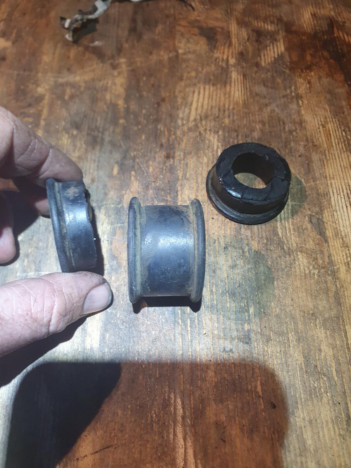

PostPosted: Mon Aug 17, 2020 11:36 am    Post subject: Re: Powerflex suspension bushings Reply with quote
I've got an '86 syncro. a previous owner installed the poweflex bushings.
Everything seemed ok for a while (not sure how to compare handling, as this is my first vanagon). But the front end squeaks like crazy. I'm thinking that I may need to take things apart and re-lube them. I'm looking for tips on locating the squeak and lubing....
Not sure if this should be a new thread - but seems like it is related to this thread?
