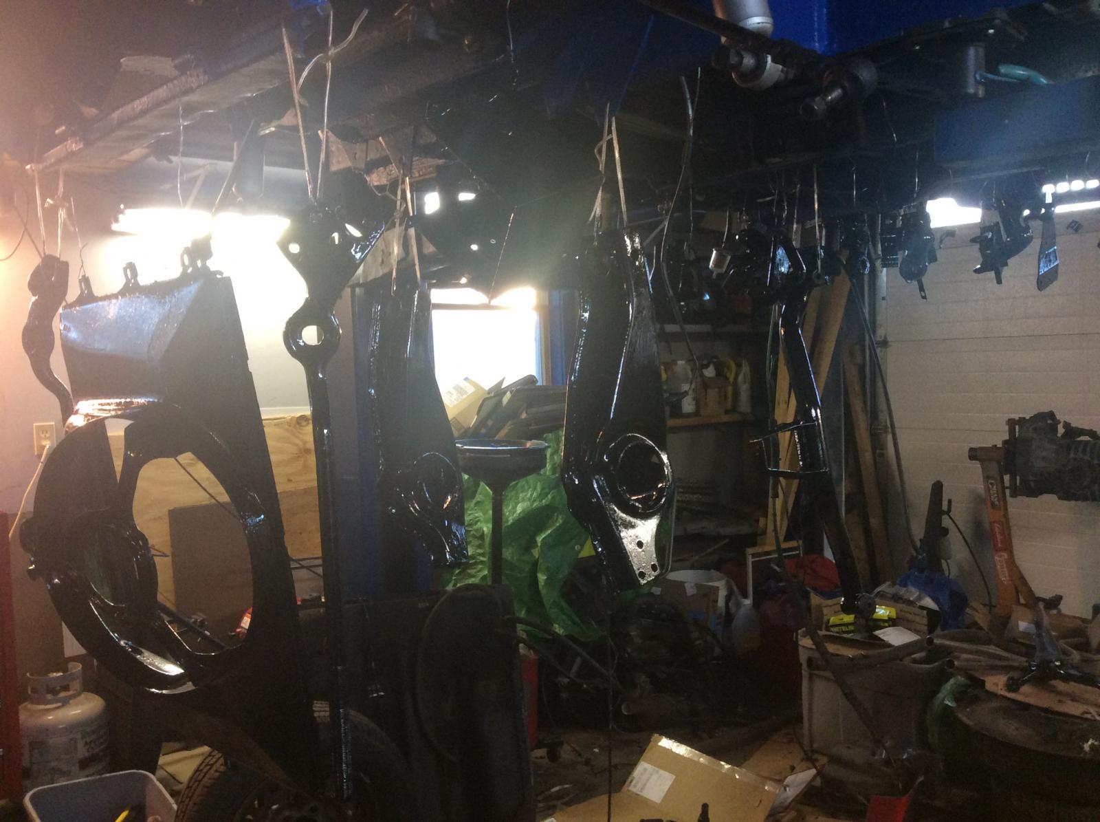

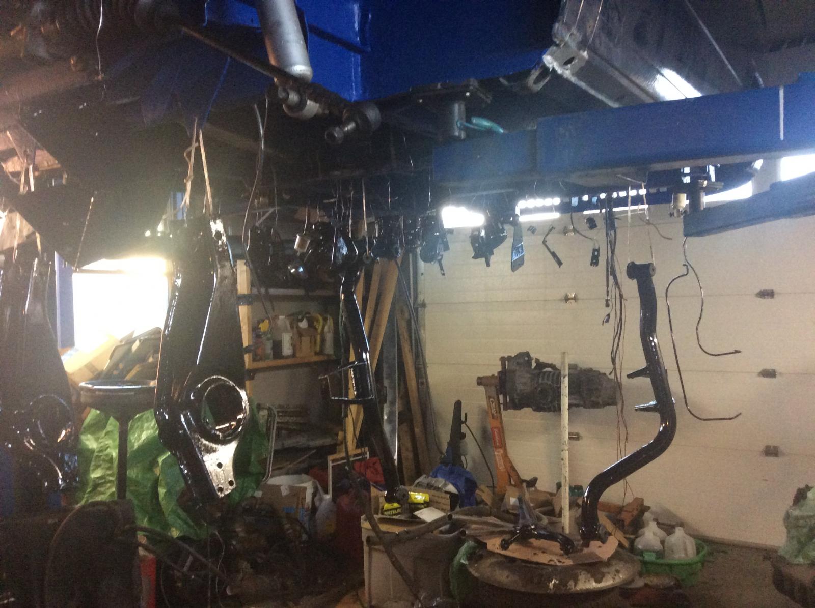

Hello we are making forward progress. Sandblasted and painted all the front end parts and pressed in new ball joints. Now all the parts are ready to be re-installed in the vehicle. Also sandblasted and painted engine carrier bars and mounting brackets. Once this is completed, it will be time to make new brake lines.

Posted: Tue Mar 28, 2017 4:21 am Post subject: Re: 82 WestyRabbit Restoration |
Not much visible progress this weekend. I insulated behind the radiator. I also replaced most of the metal brake lines. Then I sent my radiator out to be flush and tested ( all metal radiator ). Next I Replaced the front sift rod in preparation for a five speed transmission. Now I'm waiting for some front brake parts so I can finish the front brakes.

Posted: Tue Mar 28, 2017 3:55 pm Post subject: Re: 82 WestyRabbit Restoration |
| It is a parking solution. I didn't have enough lot line to build two car garage. So I went up instead. That's the van's permanent parking spot. The wife's Miata fits nicely under it when the van is not so far apart. |

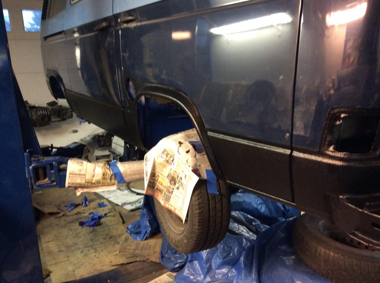

Posted: Sun May 07, 2017 6:49 pm Post subject: Re: 82 WestyRabbit Restoration |

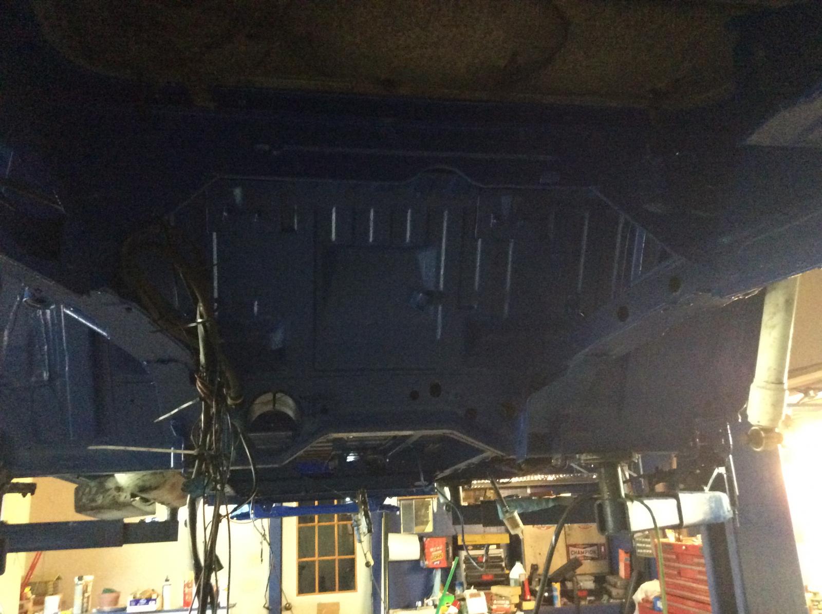

Today I used A wire brush on a drill to clean out the lower seams. When I finished with the wire brush, I cleaned up the rest of the seams with a sandblaster. Than I scuffed down the paint and primed with self etching primer. I ran out of time before I could apply the seam sealer. Hopefully I can get the seam sealed some evening this week.

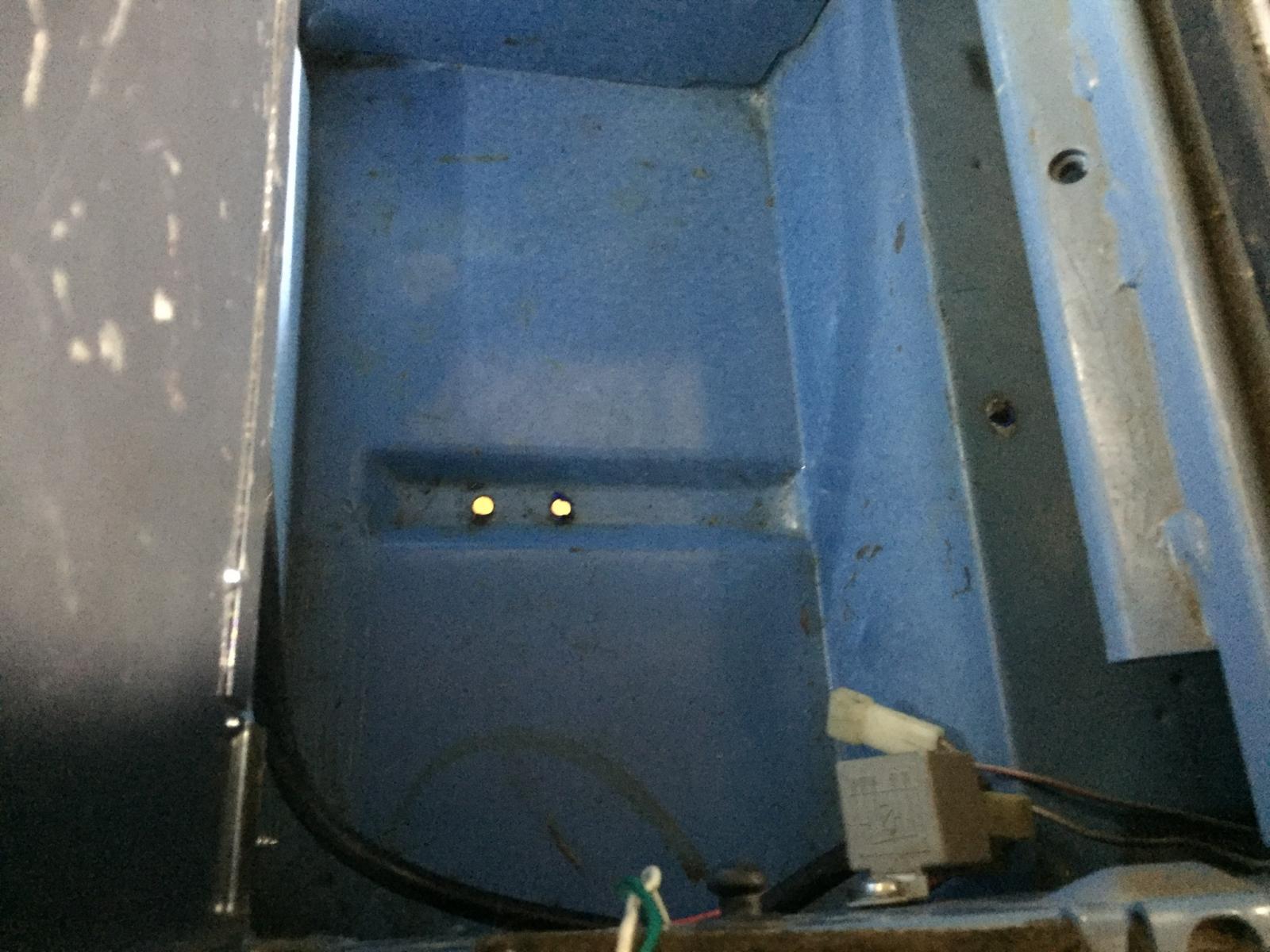

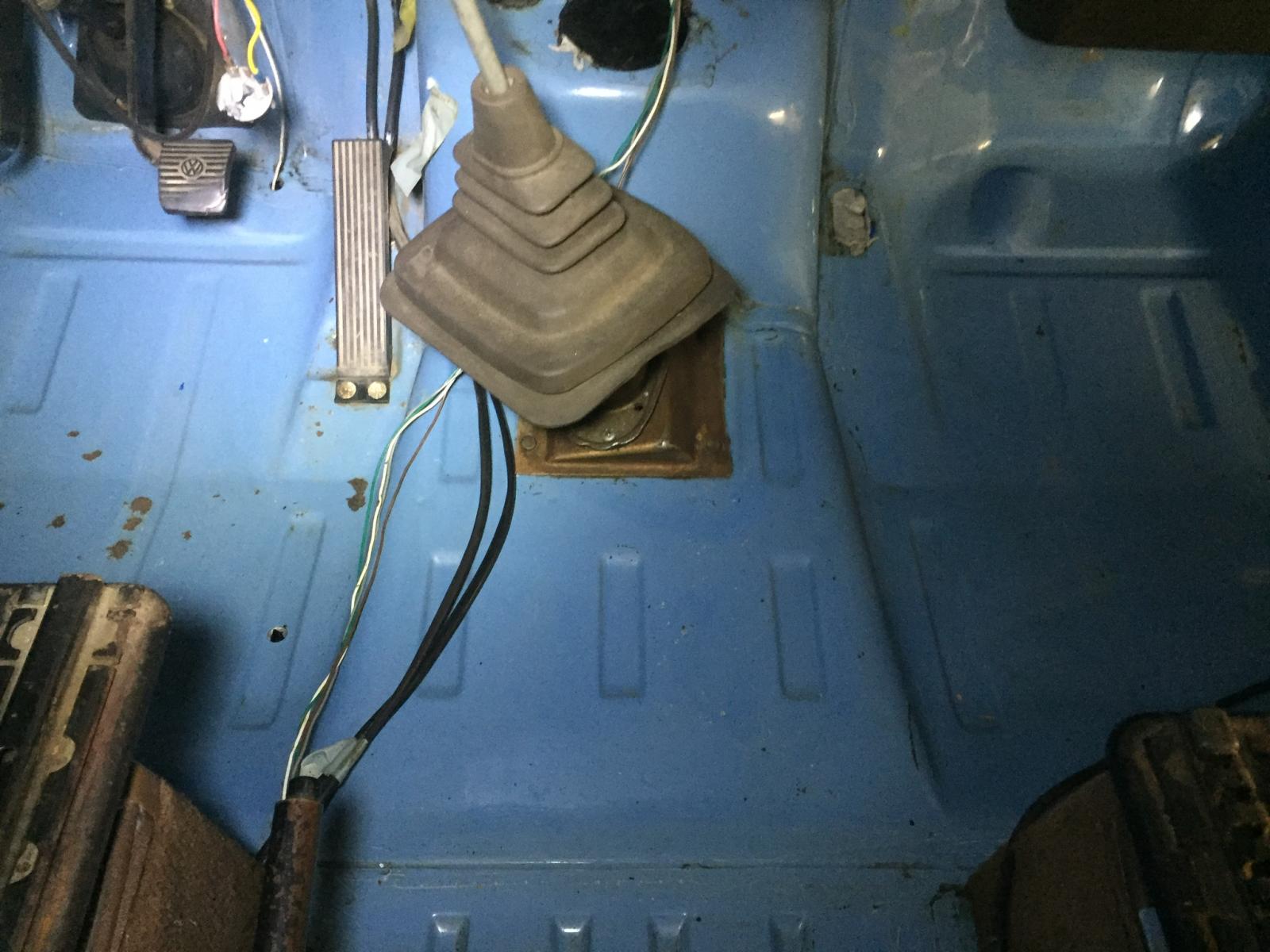

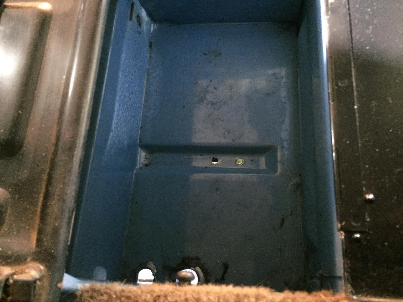

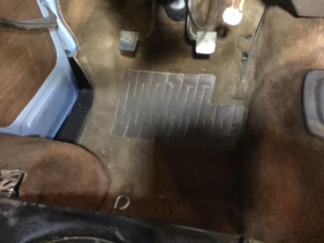

I pulled the front carpets out today anticipating cleaning them up and getting them ready for painting, but they look so good I only did the left side front.
I was also quite pleased when I looked in the front battery boxes.
I finished the seam sealing and prep work, so that I could put monstaliner on the lower section of the van.
Now I have lots of stuff that I can put back together. The rear suspension is ready to be reinstalled with new bushings. I have to figure out what extra wires I want to run to the front of the van so I can reinstall the gas tank.  |

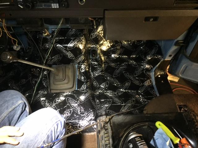

After painting and monstalining the front floors I was able to Dynamat Them.
I used more dynamat than gowesty recommends. But a lot less than some other people use. I reinstalled the front carpets with the original cork flooring under it.
The carpets look pretty good for a vehicle with over 250,000 miles on it. I will probity lizard skin the back inside of the van when I get that far. But right now my priority is to start working on getting the engine and transmission reinstalled so I can start driving the van this summer.  |
