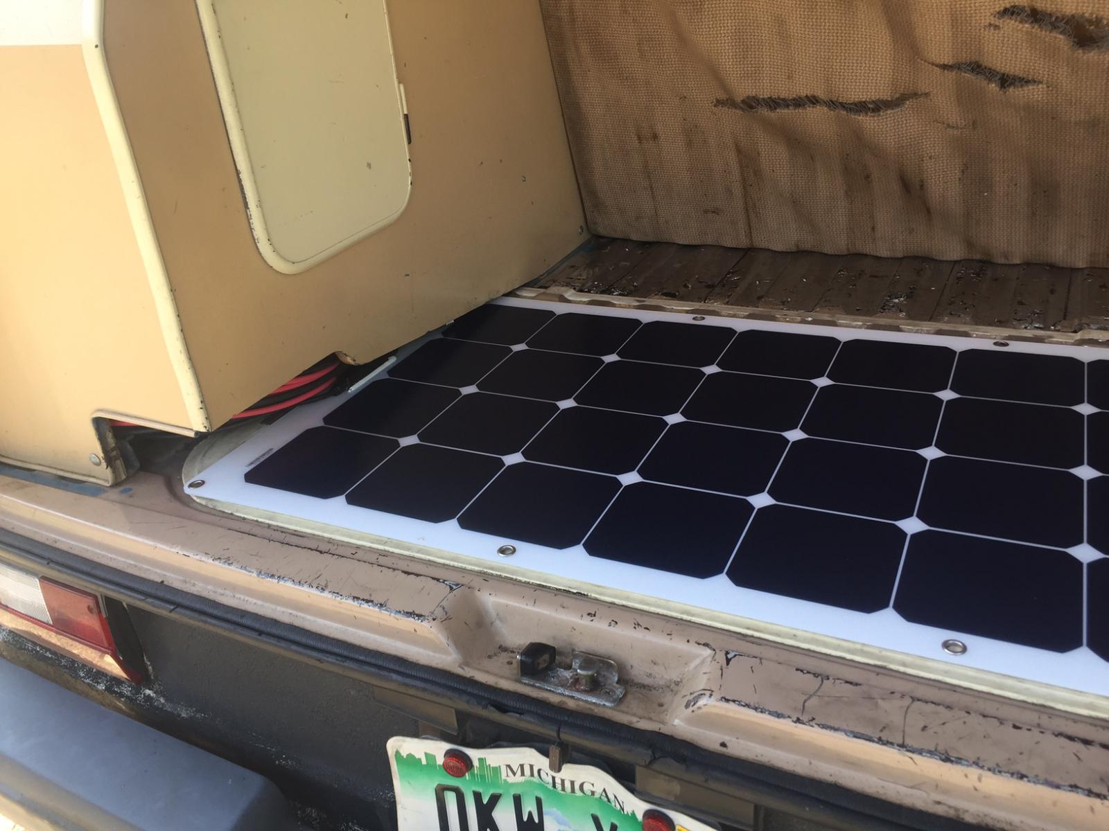

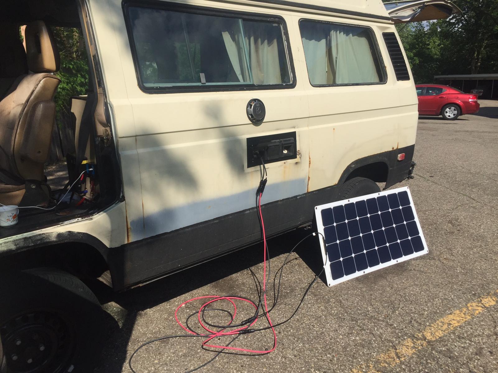

I finally got some solar into my van, and as much as I liked GoWesty's folding 110W panel, I could not in good conscience pay almost $600 for their kit, so I made my own.
I did purchase their solar hookup box, doing away with the city water outlet which I never used. This enables me to connect the panel wires without having to crack a window.
An SAE (the GW connection style) to MC4 adapter is necessary to do this project.
The panel I got was a 100W Suaoki semi-flexible. Almost 6 amps in good sun, very sturdy unit. Cost me $180 on amazon.
Charge controller: 10 amp, $15 on amazon.
Wires: 15 feet of extension, so I can park in shade, panel in sun: $25 on amazon.
Adapter: $20 on eBay.
I have amazon prime, so free shipping. All told, about $240.
Pics below. The unit stows nicely under the rear bed cushion, with the wires neatly tucked beneath the rear cabinet.
I have the TF49 out for some maintenance, so the wiring was easy to do. The whole shebang takes one minute to set up.

I tried a 10a controller for my 160w panel....
Lasted a day or two...my mistake....Im not sure if it is robust enough for a 100w panel...there is some maths I believe... Smile

He's using a 100w panel, at ~6 amps max, he's all good with a 10a controller. I have the same setup (it's great). A 160w panel is a different beast entirely. Pushing 10a in full sun it isn't surprising that you smoked a 10a controller.

Each panels spec sheet will have a rated closed circuit current (Ioc)that is the maximum current you can expect from it (barring acts of Zeus) and it will surely be less than that based on what your controller decides the voltage should be.

My only advice would be to add a 25' separate extension cord. Almost as often as not, you'll want that flexibility -- especially on a hot summer day when camping in the woods.
