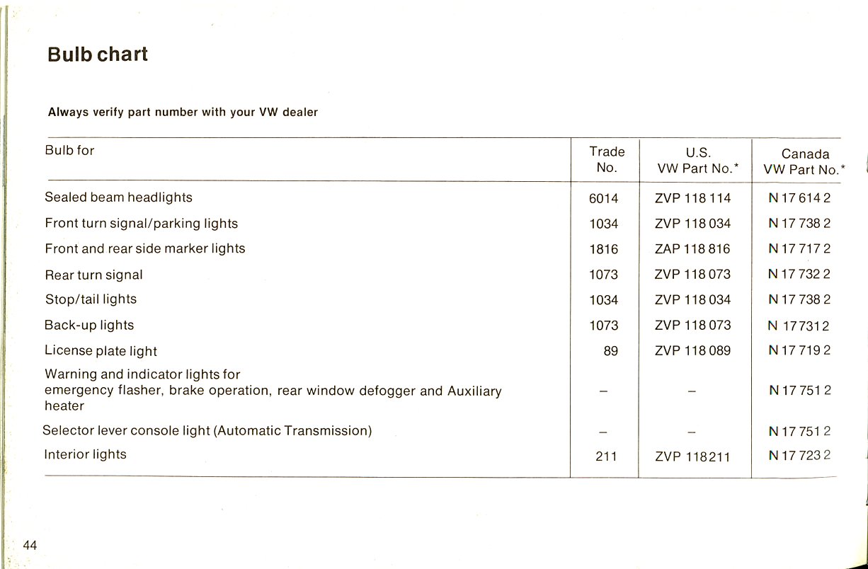

Looked through my Bentley (1979 edit) last night but could not find a chart on light bulbs stating lamp numbers for specific locations. Ex- tail/brake=1157.
Is there such a guide or chart?
Specifically I need a license plate lamp # now.
Searched first using "lamp" and "bulb" in titles. Sorry if this is a repost.
Thanks,
Dim in St Louis.

Yes, there is a chart right in your owner's manual, many of which there are electronic copies of on this very site.

Ah ha! The owners manual. I knew I had seen that chart before.
In my glovebox just under my nose while I was sitting in the passenger seat thumbing through the Bentley last night.
I am a dumbass. Embarassed
At least I can buy the #89 license plate lamp on my way home from work now.
Thanks.

The official VW Owners' Handbook, for the British specification, 1973 VW 16/1700 Type 2, also specifies the bulb wattages, for each application; including those in North America.

PostPosted: Fri Aug 25, 2017 2:43 pm    Post subject: Light Bulb Chart T2 Reply with quote
To link to this thread copy and paste
Code:
[url=https://www.thesamba.com/vw/forum/viewtopic.php?p=8539877#8539877]Light Bulb Chart T2[/url]
LIGHT BULB CHARTS
- NOTE BULBS NOT LISTED
- N 17 751 2 = 2721 12v 1.2w Instrument/Warning light bulb
2723 12v 2.3w bulbs can be used for brighter Instrument illumination. (note: not to be used for warning idiot lights)
- N 17 723 2 = 6411 12v 10w Dome light Bulb.

PostPosted: Wed Sep 06, 2017 10:47 am    Post subject: Philips Bulb Guide for: VOLKSWAGEN Transporter Reply with quote
High & low beam headlamp H6024
Parking light 1157
Front turn signal 1157
Rear turn signal 1156
Tail light 1157
Stop light 1157
License plate 89
Back up light 1156
Front side marker 1895
Rear side marker 1895

I've been replacing bulbs with LED replacements, and I found 2 very small bulbs beside the front turn signal lamps - I can't read the markings - any Idea what they are?
Thanks for any advice,
busdaddy
Joined: February 12, 2004
Posts: 52730
busdaddy is offline
PostPosted: Sun Jul 02, 2023 1:42 pm    Post subject: Re: Baywindow light bulb chart? Reply with quote
Welcome!
I'ts on the charts posted above, front and rear side marker lamps is what they are called.
