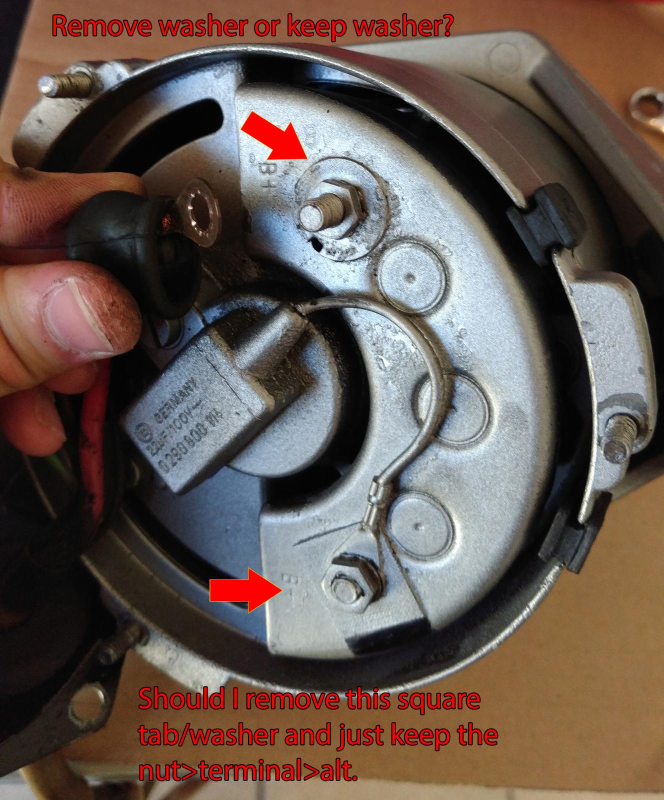

Just picked up my alternators after having them fix/rebuilt.
Not too happy with the inside being spray painted this way but as long as they work Pray
I want to prevent my alternators from shorting..
If I'm understanding this correct
1) I remove one of the nuts and the washer, keep it as nut>terminal> directly to alt.
2) Grind off the excess as you say.
3) Use cardboard trace out the plate and place between the alt and the cover plate.

PostPosted: Tue Jun 27, 2017 5:37 pm    Post subject: Re: Alternator Type IV (4) Reply with quote
It would be worth your time to scroll up 2 posts and watch my video.
Leave the washer and for sure leave the square unless you want to do it all over again with a new harness.

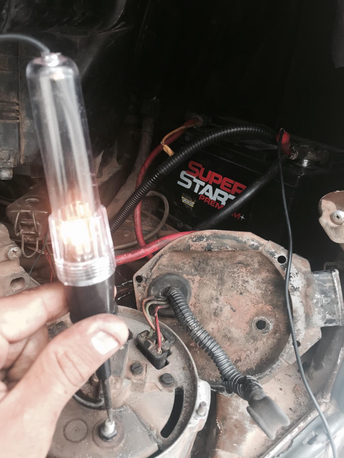

PostPosted: Thu Jul 27, 2017 8:42 pm    Post subject: Re: Alternator Type IV (4) Reply with quote
telford dorr wrote:
Slammed77bus wrote:
I recently had the same problem somewhat . But as I touch the red wire to the positive on the batter it begins to spark. I used my test light to check and when I clip the alligator clip to the positive and then touched the b+ b+ bolt and the light turned on. That means it's grounded right?
Right. It means there are shorted diodes inside the alternator.
With the alternator frame grounded and the regulator disconnected, connecting a test light from +12 volts to either B+ or D+ should NOT cause the test light to illuminate. If it does: shorted diodes.
Before anyone says anything the Previous owners have the batter wires backwards. The RED is negative and BLACK is positive
I'd fix that ASAP. Should you connect the battery backwards, even for an instant, you can kiss the alternator goodbye. All the diodes will be forward biased, and thus allow ridiculous amounts of current to flow. The diodes will instantly melt and short. Shortly after that, any interconnecting wire will overheat and melt the insulation. Sort of a catastrophic failure...

PostPosted: Fri Jul 28, 2017 1:53 am    Post subject: Re: Alternator Type IV (4) Reply with quote
I bet you do have a bad diode shorted to ground rather than a shorted wire. Your connectors and wire insulation look good and I think I trust your instincts not to have wires bare dangling in your engine compartment.

PostPosted: Fri Jul 28, 2017 8:50 am    Post subject: Re: Alternator Type IV (4) Reply with quote
I don't think a bad diode is going to melt down the Big red cable. Usually it creates a parasitic draw on the battery and that is about it.
I posted telford's post, more so to show how to test for a short to ground.
One member reported, that by tightening the B+ terminal alone with no Big red wire created a short to ground. So the Alt. was shorting internally through the post.

I forgot to add these pics from my procedure. On a dry run without a gasket or standoffs, I bolted the back plate on and used my endoscope to see what the clearance really was and what could cause the short. I hope this helps.
I found that even with the double nut on the post, there is more than enough clearance from the back plate.
I concluded that the flat part of the back plate without the fiberglass wafer as a buffer was the reason my harness fried. You see it sit right on the washer. Additionally, removing the washer does NOT fix this. All removing the washer does is ensure the full length of the flat piece contacts the entire B+ donut instead of just a little section that can be protected by the fiberglass wafer.
