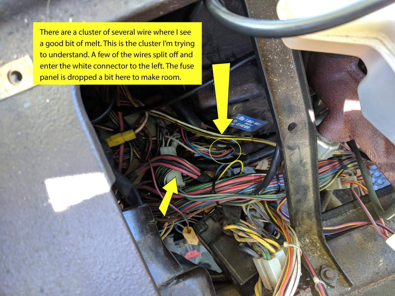

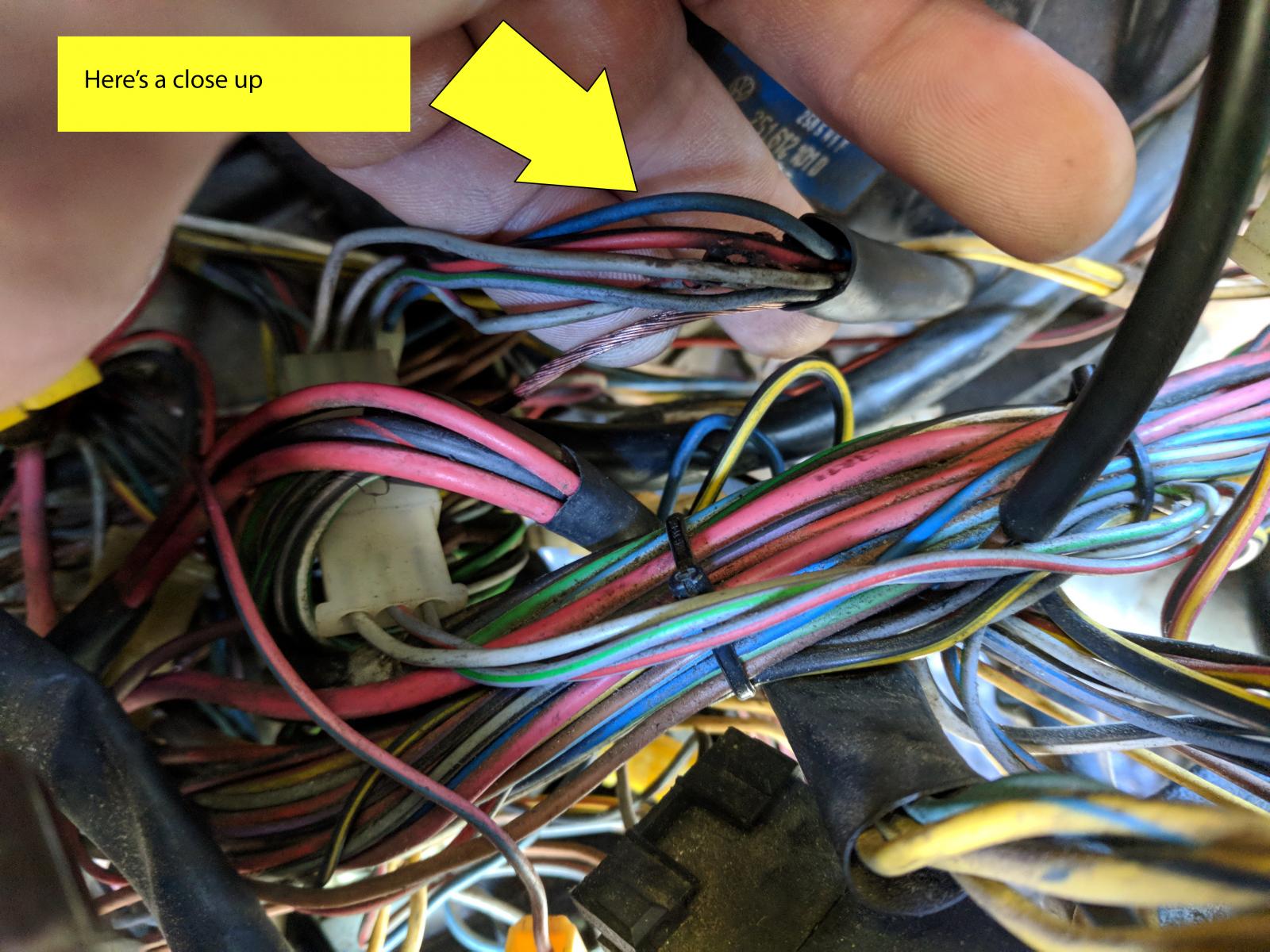

I've got an 86 2wd Weekender that had smoke pouring from the top of the instrument cluster the other day. I've found the melt-y bits but I need help identifying what these wires power so I can make sure I fix the problem correct. I'm hoping you guys can help me.
In this shot I've got the instrument cluster out and the steering wheel removed
Here is another angle that shows the burnt wiring
Here is a close up of the wires I'm trying to identify

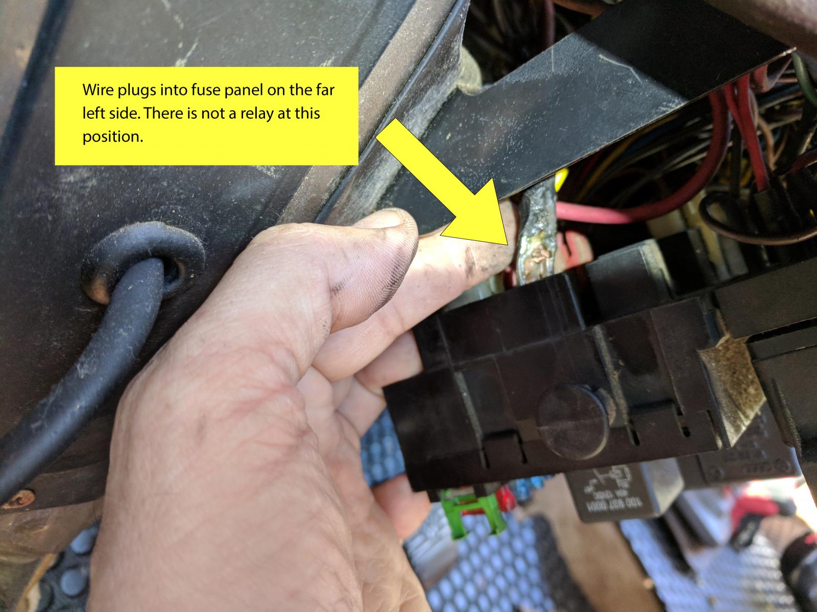

Here's a shot of the culprit going into the fuse panel under the dash
Please help me figure out what this is. You are all my heroes. Thanks!

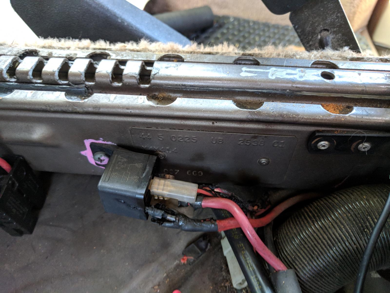

That looks like the bundle that comes/goes to under the driver seat.
Slide the seat forward and look closely under there.
Are you storing metal objects under there?
Is something going on with the the relay under there?

Amazing work. Indeed I believe I understand what happened.
So normally I have an aux battery but its nearing the end of its life and I pulled it so I could better test and care for it. Well, I thought I had secured the cables and was safe. It looks to me like my positive wire could have hit the metal on the seat and run current through it. That little guy must have been the path of least resistance. It's pretty amazing something way worse didn't happen really.
So if you were me, what step would you take next to right this wrong?
Thanks again for the suggestion. No telling how long it would have taken me to link the two and realized the problem was right under my ass the entire time.

I would make careful notes of how things are connected and then remove the Westy aux battery harness. Once out I would split open the loom cover and see if any wires can be reused.

Those looms need to be cut open and every wire in them inspected.
Fires are not fun.

UPDATE: I pulled the bundle and its totally shot. I'm going to completely replace it and the relay under the seat. I'm thinking I'll reuse the connectors since they appear in decent shape and will be a lot harder to find replacements for. Now to source replacement wire. I'm hoping I can find the right colors to avoid future headaches. Anybody have a good source for replacement wire?
