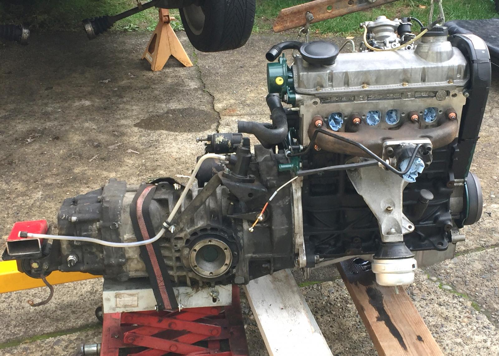

For those running Audi 5000 mounts on a 50º gas I4 with diesel oil pan and diesel Vanagon mount arms off the engine.....
Is it normal for the mount to be so close to the oil pan?
Image showing passenger side Audi mount position on my in progress ABA swap

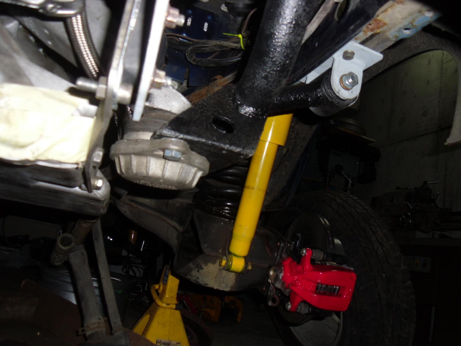

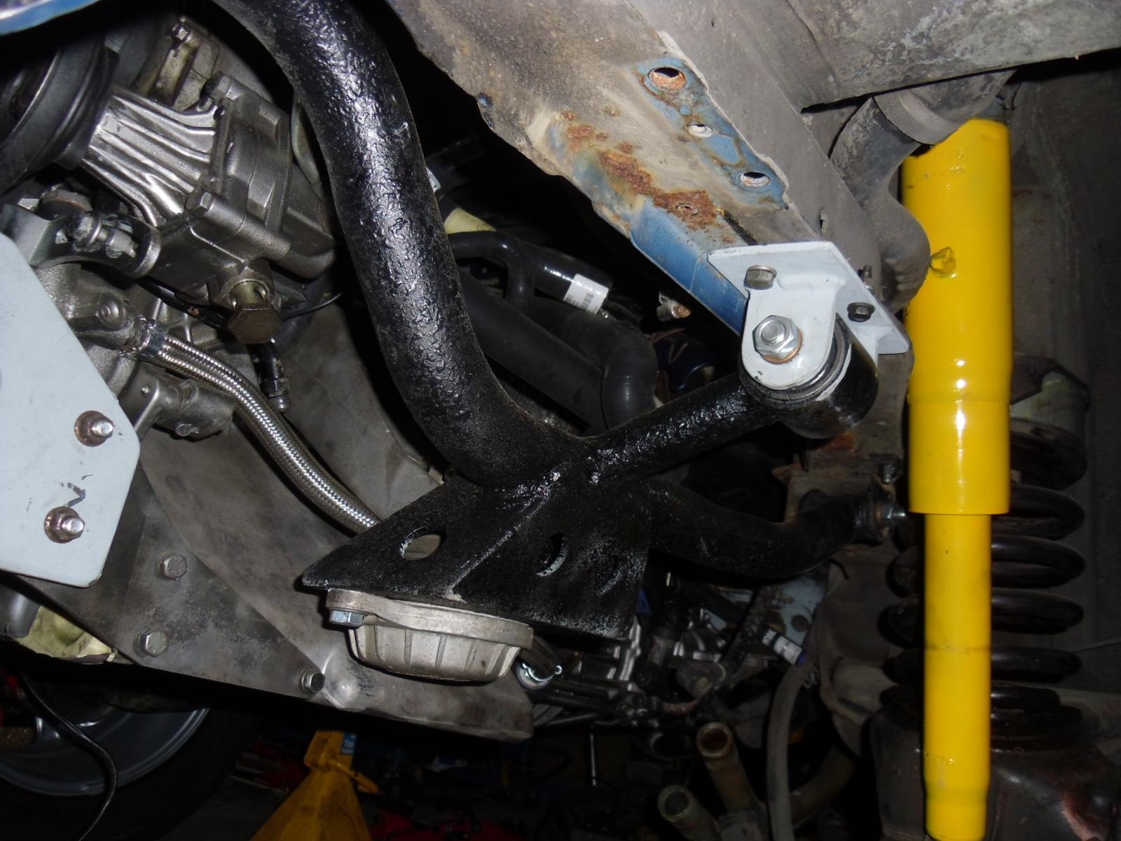

Neil, have you fully committed to the Audi 5000 mounts? I ask because I've found that it's much easier to use a center top/bottom post type mount like the Passat/A4 1.8t hydraulic mounts, and they have a smaller footprint which would be less likely to interfere in the manner in which we see in your pic. Just a thought.
Thanks Casey. No, not committed yet. That mount you show certainly looks like a better solution. Since I'll likely lower the engine by 2.5" so it can clear the engine lid, part of my "madness" was to create a bracket on the carrier arms that would accommodate raising the engine back to "OEM" position without to much modification. However. Maybe the mount you show would work to that end. It would require less fabrication anyways. I know that Tony (91Transporter16" ) shows an Audi mount for his brackets. IIRC, that mount has ears. A mount with ears would help my idea.
The images below show a larger gap between the Audi 5000 mount and pan. But maybe thats not an Audi 5000 mount Question And maybe that pan is different?
Anyhow..... I think a different mount is the way to go. I was ready to fur the arm away from the block a little to accommodate the Audi 5000 mount but that's the wrong way to go about this.

...... However. Maybe the mount you show would work to that end. It would require less fabrication anyways. I know that Tony (91Transporter16" ) shows an Audi mount for his brackets. IIRC, that mount has ears. A mount with ears would help my idea.
Thanks again Casey. I've decided to go with the
357 199 402b
part. They'll be from the "dealership" so should be decent quality. Technically they're transmission mounts but should suffice. A very rough guess suggests they're not much bigger than the Saab mounts but for sure shorter than the 1.8T mount you point to. Though the 1.8T mount looks quite stout, a shorter one will help my crazy efforts to make the mount bracket so the position (height) could be adjusted later on.

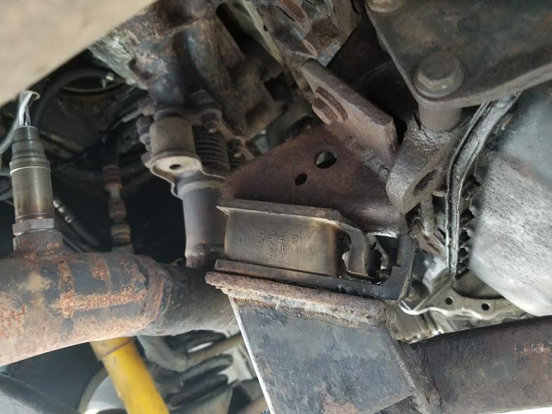

I thought I'd piggyback onto this thread to see if anybody recognizes these mounts, from my 15 degree ABA Syncro:
"6 ARP 2366." I've been searching for part numbers or photos and haven't been able to find anything. I'd like to find a better solution to reduce vibration.
Thanks!

In your first image, at the bottom steel plate bonded to bottom of rubber, is that ear touching the bracket mounted to engine?
I googled "2366 engine mount" and got some Toyota hits. 22R and t100 but thats just a total guess.
Neil.
Neil.
Thanks Neil, I just noticed that myself...I will check them after work. Both of them appear to be very close if not touching. Metal on metal would certainly create vibrations!
2366 represents the CC's of one of those Toyota pickup engines, got the same result. The more I search, the more they look like old domestic transmission mounts or maybe old Ford V8 pickup truck engine mounts. I did find a Mitsubishi mount that looked similar.
Kind of hoping one of the sages of the group will jump in and say, "oh yeah, those are from a '73 International Scout!" (or something to that effect.) Very Happy

The square mounts above remind me of vw rabbit scirocco rear trans mount.

I'm not sure I like how short those mounting arms are, as I imagine they're not much help with reducing rocking motions. I prefer to locate the arms further up the block with a wider spread to isolate motion and vibration. You're going to have a hard time fitting any other type of mount with that tight of a spacing from the arms to the crossbar.
Neil.
You're welcome. I'm amazed at what I see when I look later at images I've taken of things I'm working on.
Ha. Ok. Engine displacement. I can see that.
The metal to metal, even a small amount, creates a bunch of noise. BTDT with flipping my WBX tranny mount.
Good luck on ID'ing that mount. Looks like Mark and Casey are on it.

The top picture is a bit misleading; there's about 3/8 inch of clearance between the rubber-coated steel bottom piece and the block bracket. However, looking at the bottom picture (passenger side,) that lower piece is touching the block bracket. That's obviously a problem that I need to solve.
