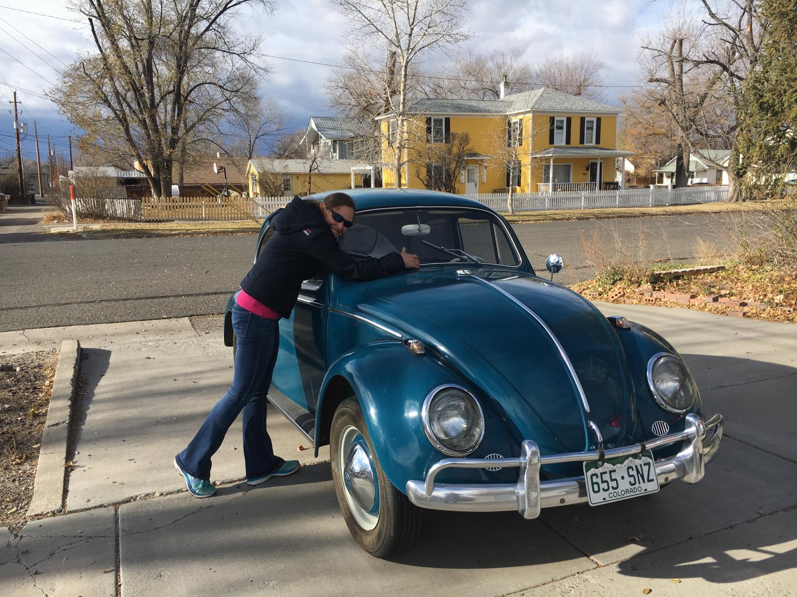

Hey everyone! We’re new to the world of classic VWs and we’ve just purchased a 1964 beetle.. my wife’s dream car for the past 30 years!
The engine is freshly rebuilt but the transmission looks like it hasn’t been touched. Ever. It’s bleeding from a few places. I’d love some help identifying what exactly they are, eapecially the transmission so I can start wrenching on it.
Engine code says H 0068580. From what i’ve read, this is a 66 type 2?
Transmission serial number is 7004967. Maybe a ‘60 beetle trans?
Is that correct?
Any info is appreciated! Thanks!

Yeah, it looks like the engine is later, but the trans may be original. It looks to be about mid 64 from this page.
https://www.thesamba.com/vw/archives/info/bugchassisdating.php
Looks to be a great find!

But the better question is where did you get the wife? Mine puts up with my bug habit at best Crying or Very sad
Sometimes it gets difficult to explain why my old cars occupy the garage while her new car says outside on the driveway.

BTW . . . welcome to the Samba forum! And, congrats on the Bug . . . looks real nice!
