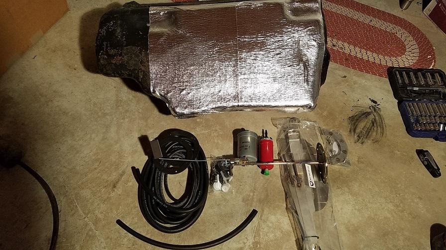

The sending unit didn't look too bad from the outside, once I pulled it out the float part was bent and there was no vent tube inside the tank. Doubtful the gauge has worked for quite a while.
All new lines, grommets, and basically any part that was associated with the tank I purchased. Hopefully my engine may never come out again so I might as well do it right this time.
I ran out of the Thermotech heat barrier, waiting for UPS to deliver the rest. Everything went pretty smooth taking it apart and putting it all back together, kept the venting tubes for reference when the new ones went back on.
Before I put the tank back I figured it would be a good time to skip ahead on the Bostig manual and install the wiring harness. This can be done with the gas tank in place, but much easier without it.
While I'm waiting for the last of the heat barrier material so I can put the tank back in, it was a good time to finish up the front end so all that is left is to put the new calipers, rotors and pads on and then I take the front end off the jack stands.. wooo hooo!!

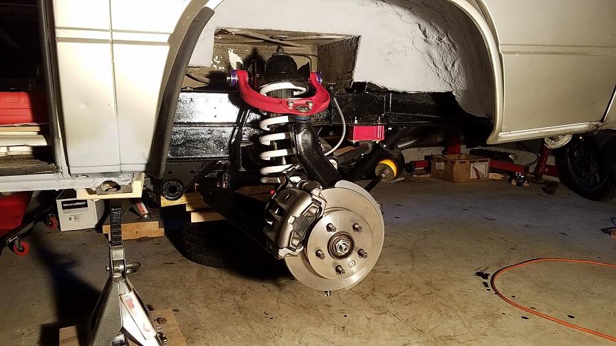

Nice feeling to have the brakes on both front and rear. Tonight I need to make the two rear hard lines that run from the flex hose to the drum cylinder (21.6" if you're curious). Had to replace a few of the hard lines on the vehicle, but most were still fine. I did go with the stainless steel flex lines, always saw a huge improvement with that simple upgrade.
My wheels and tires should be in next week, I think that may have been one of the more difficult decisions to make. I do love the look of the larger tires, and have 8 new 944 CV's... but... I ended up going with a 215/65/16 (27" tire) for all around functionality and not too much engine loss for the Zetec. Can't wait to have the van resting on its own tires.

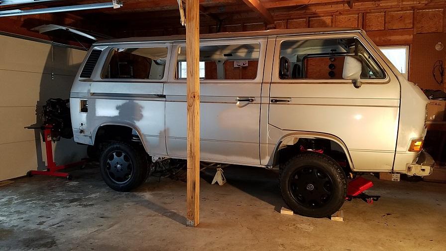

After 8 months of being on jack stands, the van is finally able to sit on its own shoes. I went with the General Grabber AT2 215/65/16 (27") on GW alloy's. I went back and forth with this size and the next size up (215/70/16) which is a 28.1" tire. The Bostig could have handled the larger tire, but for functionality and looks (personal preference), I like the size I got. Currently the front is sitting at 21" from lip to hub, should settle a little but maybe not too much. I added a spacer for the rear for the added weight of the Bostig, rear tire carrier and roof rack.
Next up... Zetec engine prep.

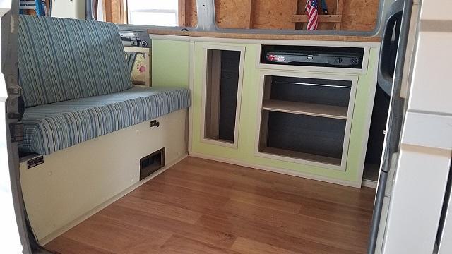

It's been a slow winter working on the Syncro, now that the weather is about to break I'll be back at it. I started building my own cabinet system, and made a half height cabinet to the rear hatch. Came out OK but there was a lot of wasted space and was never really happy with it.
I found a complete Westy cabinet system 40 miles from my house, this is something you never really find in the northeast so it was quite the score.
Just need to wire everything in and bolt it up. Slow progress is better than no progress..

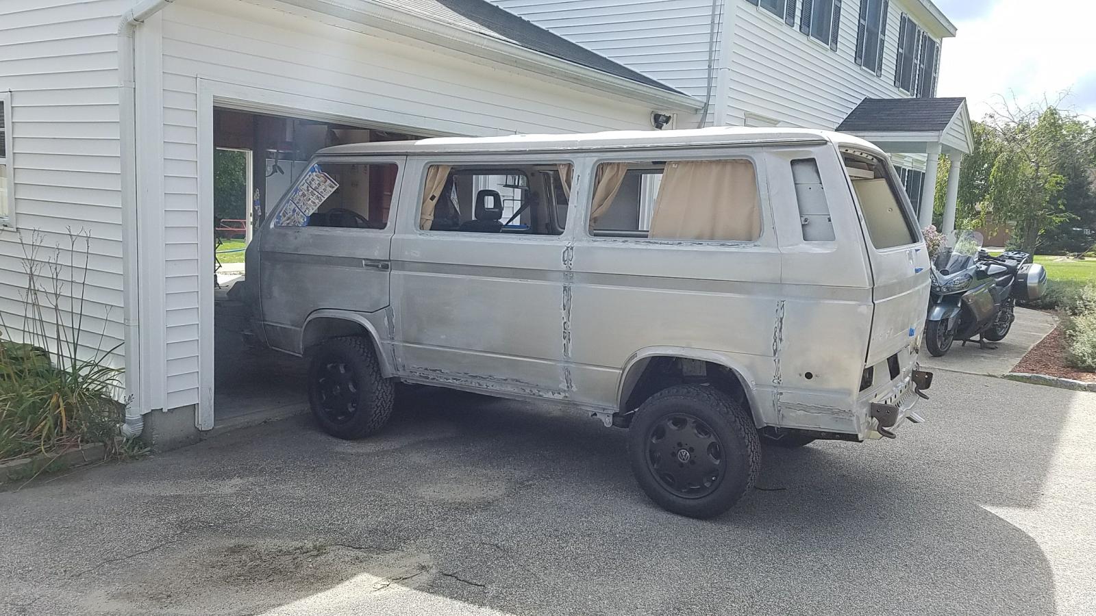

Before cold weather comes to the northeast, I want to get the Syncro painted. I went to 4 different shops in the NH and Mass area and the price range was $7,800 to $12,500 (ouch). So, what did I do?? Haters are going to hate.. but... I used Rustoluem and a foam roller after seeing a friends Ford van he did 7 years ago and still holding up fine. Quite a few articles of folks doing this and the vehicles are holding up fine years later. The trick is the prep work and taking your time
$53.00 in supplies and a few hard weeks of my time.
I started by sanding the entire van to rough up the existing paint, not real rust to speak and what little rust there was I took care of both inside and outside with rust converter and POR15 The undercarriage has been all ground down and covered with POR15 as well along with all suspension parts after sandblast.
3 coats of oil based enamel primer and wet sanded between each coat. I just finished my 8th coat of base yesterday morning and must say it came out very nice. The first two coats of base I wet sanded in between with 800 grit, took the most of it off each time, the next two coats I wet sanded with 1000 grit between each coat the next two with 1500 grit between each coat and finally the last two with 2000 grit but for the last coat I have not sanded yet. Going to let sit for a few weeks to completely harden and then sand with a 2000 grit and then wax and buff.
I mixed both the primer and the base with mineral spirits so it has almost a milk consistency (50 / 50) and ends up drying quicker than not. Rolling it on with a 4" foam roller was time consuming but if you're careful and take your time, the lines are non existent. My original color was the Metalic Silver and after a few test coats with different colors, I went with a lighter silver so the door jams almost match. All in all my shoulders, arms, and whole body ache from weeks of sanding and painting, but the end result of saving $9,947 was well worth it.
Here is stage 1, after removing 80% of the seam sealer and replacing with a quality 3M product, sanding and sand and sanding.
Stage two was the primer, lots of sanding in between each coat of the primer.
Not the finished product, but this is at the 6th coat and not wet sanded yet. Since this picture I've wet sanded two more times and added three more coats. I'll be putting the Monstaliner rock guard (black) on the bottom.
