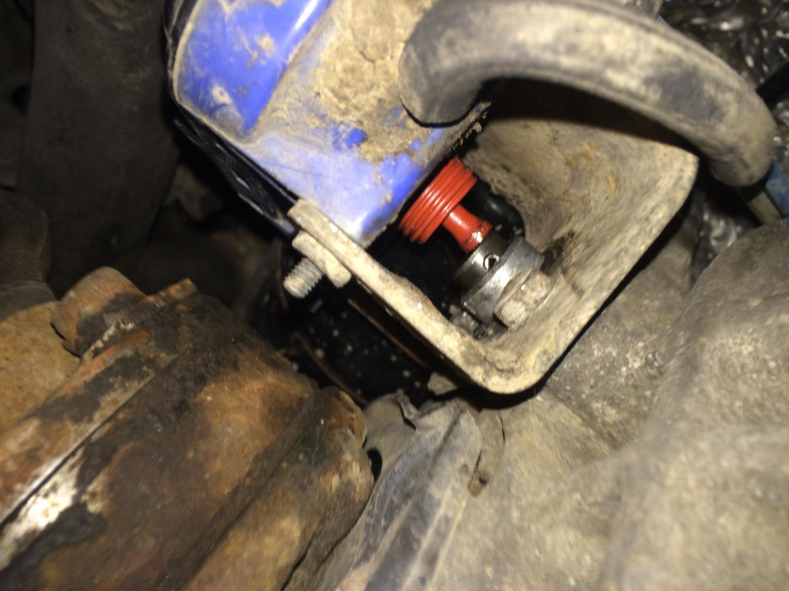

I’ve got the actuator partly remove but it won’t coem all the way off. Is there a pin or screw in the shaft that needs to be removed so it will pull off? Thanks

PostPosted: Wed Dec 27, 2017 9:10 am    Post subject: Re: Syncro Decoupler on the blink Reply with quote
The actuator for the decoupler is just like the one for the locker shown here. There is a push pin that you have to drive out for the actuator to come all the way off. You can see it in this photo it is almost covered up. Some of them have a short post and some are a 1/2" longer and are easier to get to. If you still have rubber hose over the thing, it will be hard to see.
When you are putting it back together, you can use a piece of 3/4" clear PVC hose, it makes it easier to see where the pin goes. I drill a hole through the clear PVC hose right where the pin goes and use needle nose pliers to get it started. The little hole you drill isn't a problem but you can put a dab of sealer over it if it bothers you.
But why are you taking it all the way off, is it not working, or is the pin in the decoupler not moving back and forth? If the decoupler pin is frozen, you will need to take the whole nosecone off anyway.
