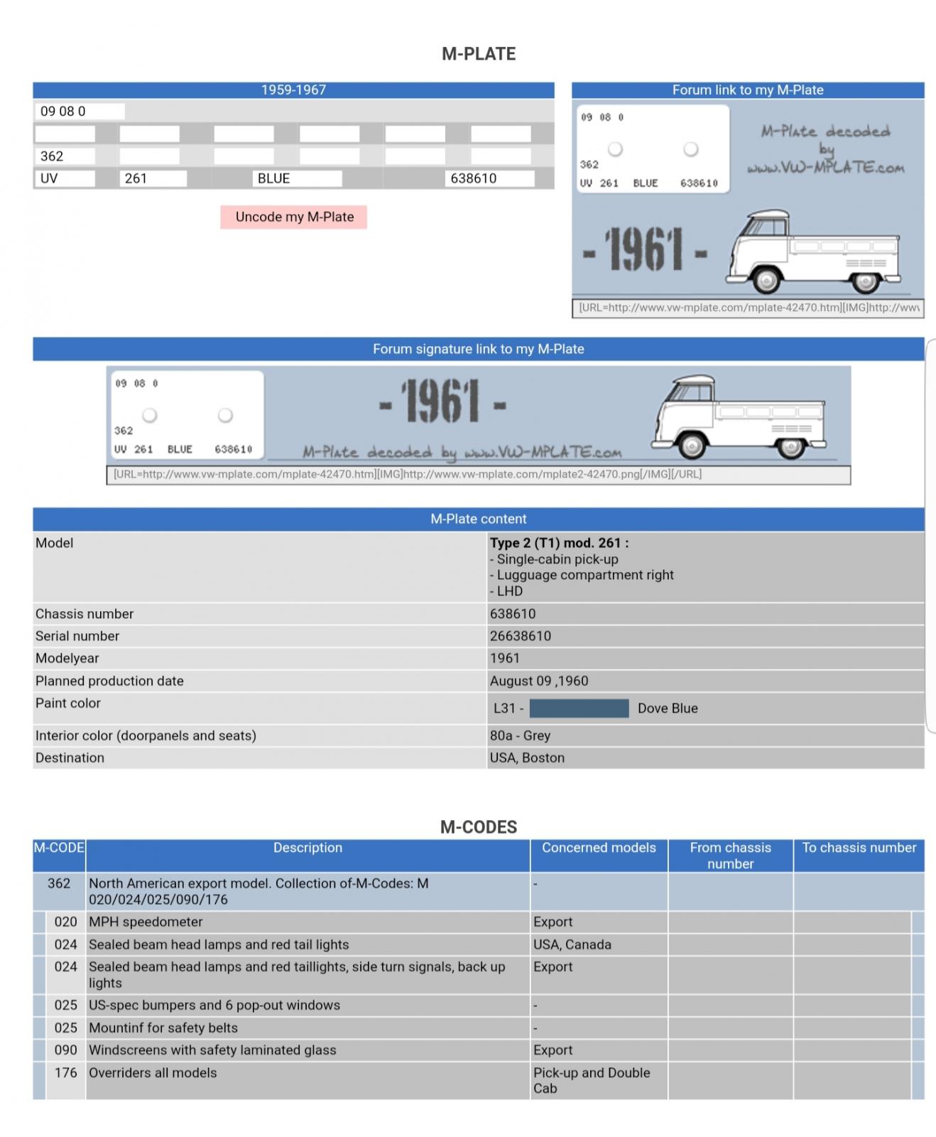

Here's the other style plate they sell I think this is correct for 62 and earlier? Not to sure. I seen photos of some originals and they look similar but not quite. Some say MADE IN WESTERN GERMANY at the very bottom.

Here's your m code decoded. Scratch the 6 pop outs

In 57 and 61 the VIN was 6 digits, and the type was not in the VIN. The VIN in the engine compartment would be 6 digits.
In 68 the type was part of the VIN. A 68 DC VIN is 9 digits and starts with 268.
in 1970 they started the 10 digit VIN; my 70 bus has a VIN of 220 xxxx xxx You can tell from the VIN what model it is, that it is not a truck... without even seeing the actual vehicle.
Yep...that's right, all right.
Yep....Found the VIN tag on the 61, behind pass seat, way lower than the other buses I've had. Before and after pics of the 61.
ya, the truck M-code plate is lower than in a bus:
That M-code decoder page also included back-up lights, which is not included for that code until partway into 1967.
The seat belt mounting points weren't included till IIRC 1963 Laughing
The 'serial number' of 26638610 is also an invention. ignore it.
