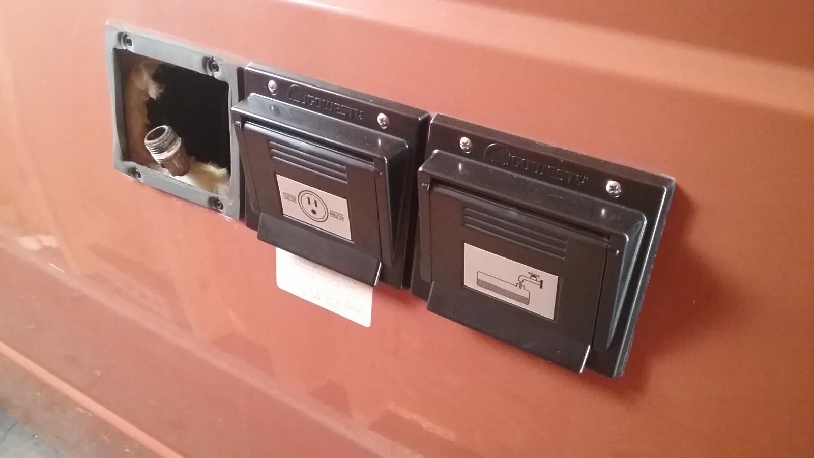

If I disconnect the city water do I need to plug the hose attachment on the faucet? Like, if I turn on the faucet (from the tank) is water going to spill out this connection or is it a separate line?

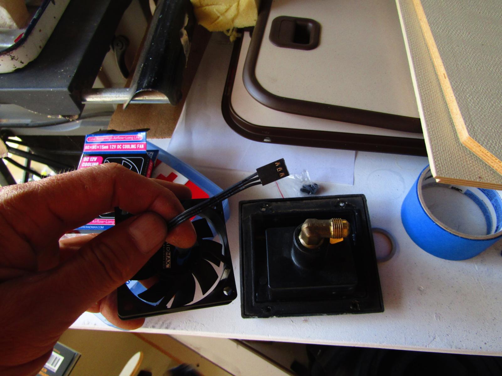

Also I bought a computer muffin fan to put in that hook up. It has three wires. ??? In the "frank condelli fridge maintenance" thread he says to wire this to the "12v constant power" at the led panel. Can anyone explain or have pics of how to do that splice? And does that mean the fan will be on anytime the ignition key is in or what?
Three wires-
Finally, there is no rust around my hook ups, nor on the body panel reinforcing rib. The rust is only on the floor and I suspect the water fill connection on the tank. Because it is lower than the overflow it will be submerged when the tank is full and mine looks tampered with? What do you think and how might I address?
Thanks for all the help!

I cut that fitting off the fan's wires, stripped them and tried putting every combination of TWO wires to a battery with no luck. Three wires? Anybody?

What size battery did you connect the fan to for testing?
If you google the fan part number, brand, you should be able to find a wiring diagram for it.
Constant power means just that. So no, it won't be switched at ignition switch. I would suggest installing a fuse between the fan and supply. On my Westy, I installed a switch to turn fan on/off.

On one fan that had 3 wires (red, black & blue) the fan ran correctly with red to + and black to -. I just cut the blue wire as far back as I could.

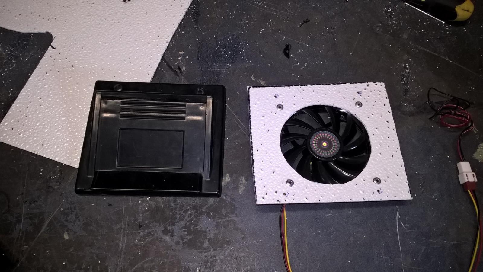

I put a muffin fan in my city water port. It works well and really gets the heat out from behind the fridge. I made a plenum from reflectix as well...this keeps,the interior of the van cooler, as the fridge heat doesn't dissipate all over the rear of the kitchen and water tank area.
Do you have an auxiliary battery? I ask because, with the plenum, I need to run my city water fan all the time, and the stock fridge fan cycles as it should (just less frequently). If I shut the city water fan off, the stock fan runs constantly. Problem could be if you do not have an auxiliary battery, your starting/main battery will have constant draw.
I wired my fan to the hot wire that feeds the little toggle on the face of the sink/stove unit. (Red to red). Then I wired this hot wire to a toggle switch I mounted on the wall nest to the side fridge vent on the left. This allows me to turn it on and off as needed. The other wire serves as the ground, I forget the color. The third wire is not needed in this setup. You will need to find out which of your wires is which.

I added a fan to the city water outlet as well. I have a 2 way toggle. Off the thermoswitch controls the fridge fan as intended. Position one overrides the the thermoswitch. Position 2 runs both fans. It is not always convenient to have the city water fan running. I posted some photos in the my gallery here. No science, but I never hear " I don't think the fridge is cold" that was not the case prior to the fan changes.

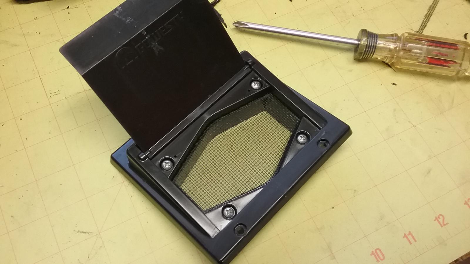

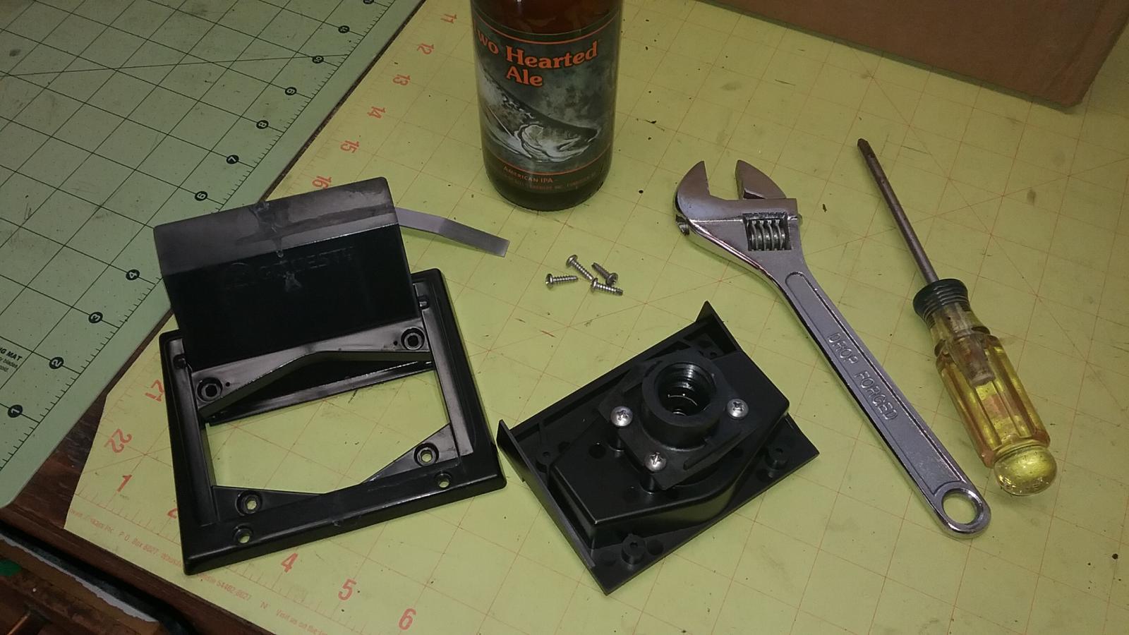

Warm January weather gave me the itch to tinker on the camper; I've wanted to do this mod for awhile. I didn't add a fan (yet) since I wasn't ambitious enough to pull the fridge to tap into a power source, but I'm curious how much of an improvement I'll get without one. I might experiment with rolling a towel and laying it across the interior vents behind the fridge to force some heat out the new exit... in due time once spring arrives.
No turning back now! Cringed a little modifying "new" parts but we'll never use the city hookup.
Cleaned up nicely with a utility blade and some sand paper.

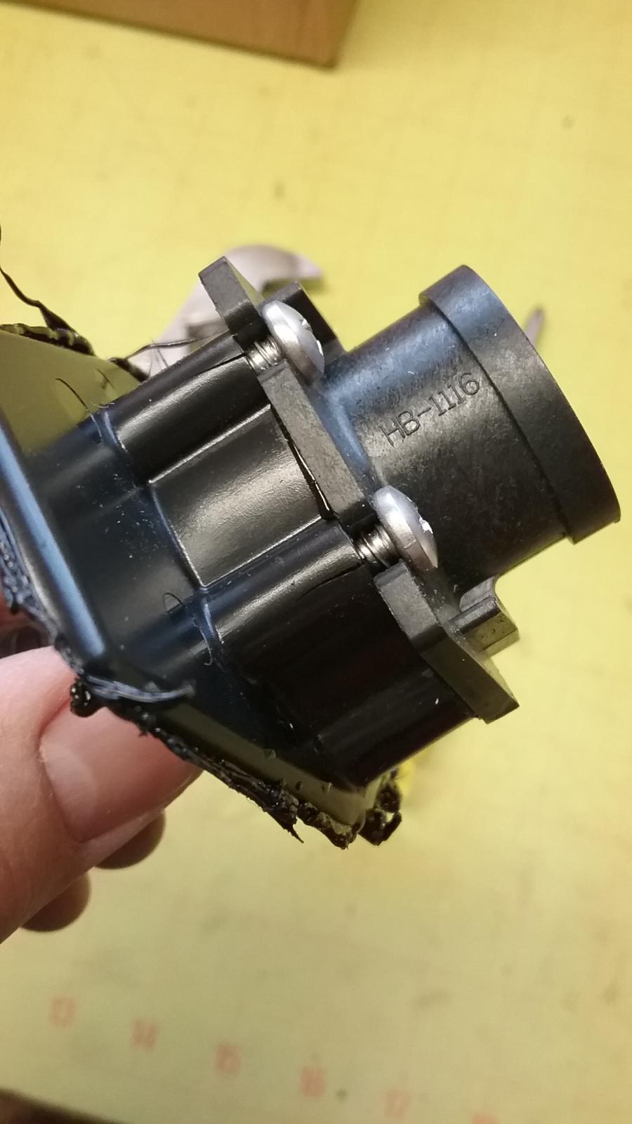

While doing surgery I noticed that the housing had a couple cracks in it at the bosses for the self tapping screws. I just put these new hookups in a little over a year ago, didn't look that closely at them to see if they were cracked when brand new. Just an observation. Everything was still snug but surprised me for the age of the parts.
