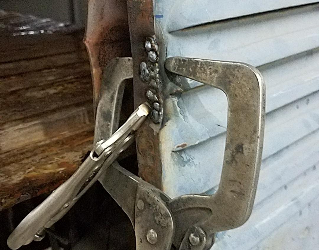

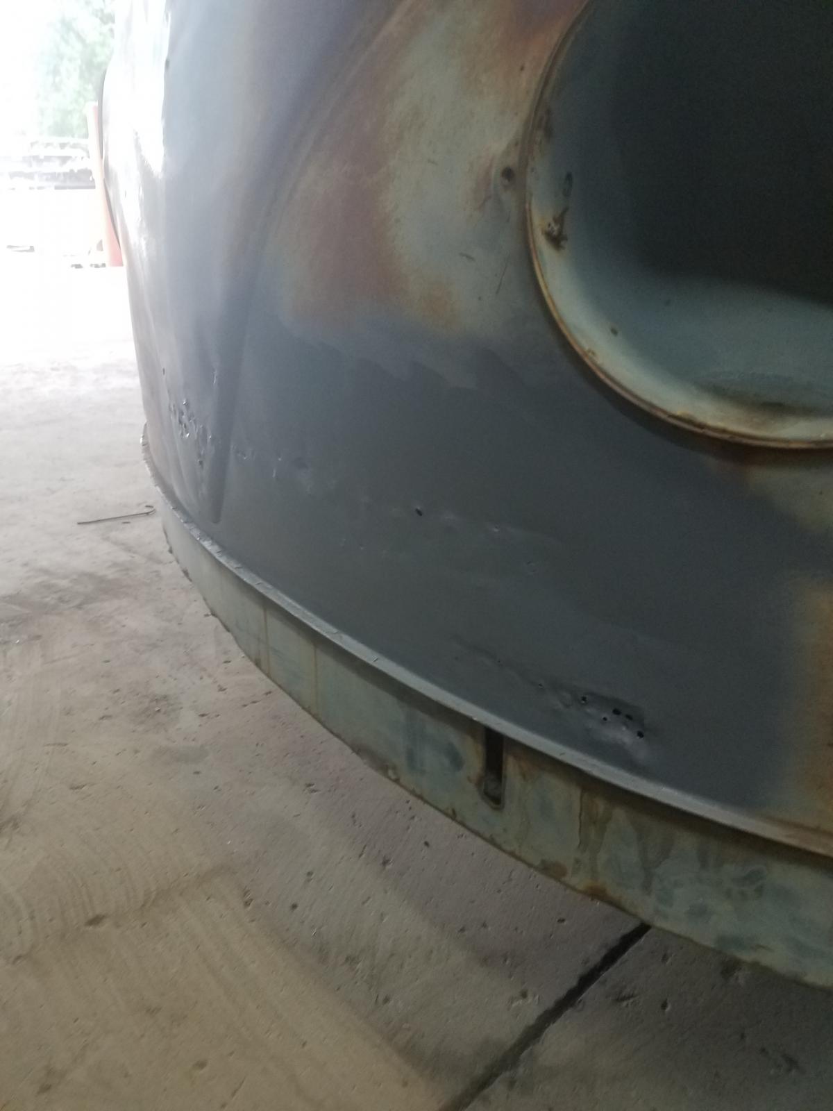

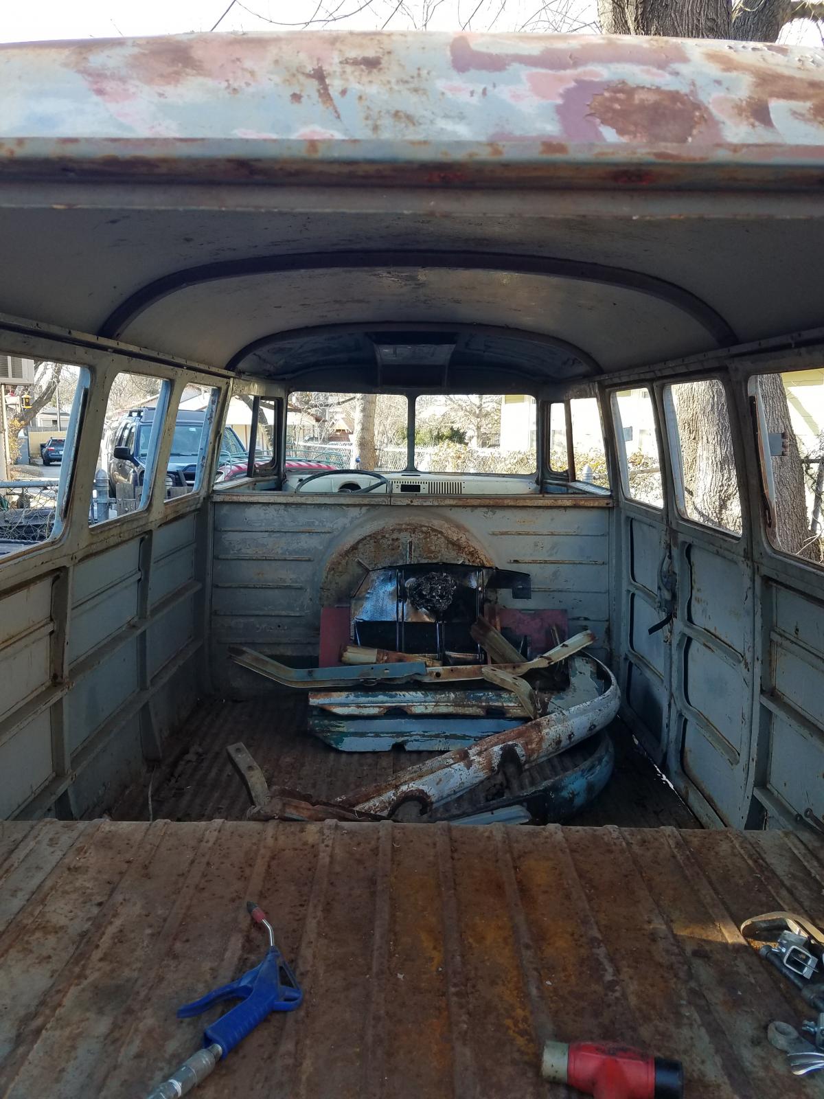

PostPosted: Tue Feb 20, 2018 12:55 pm    Post subject: Re: Adam's 1955 Wolfsburg Semaphore Kombi Build Reply with quote

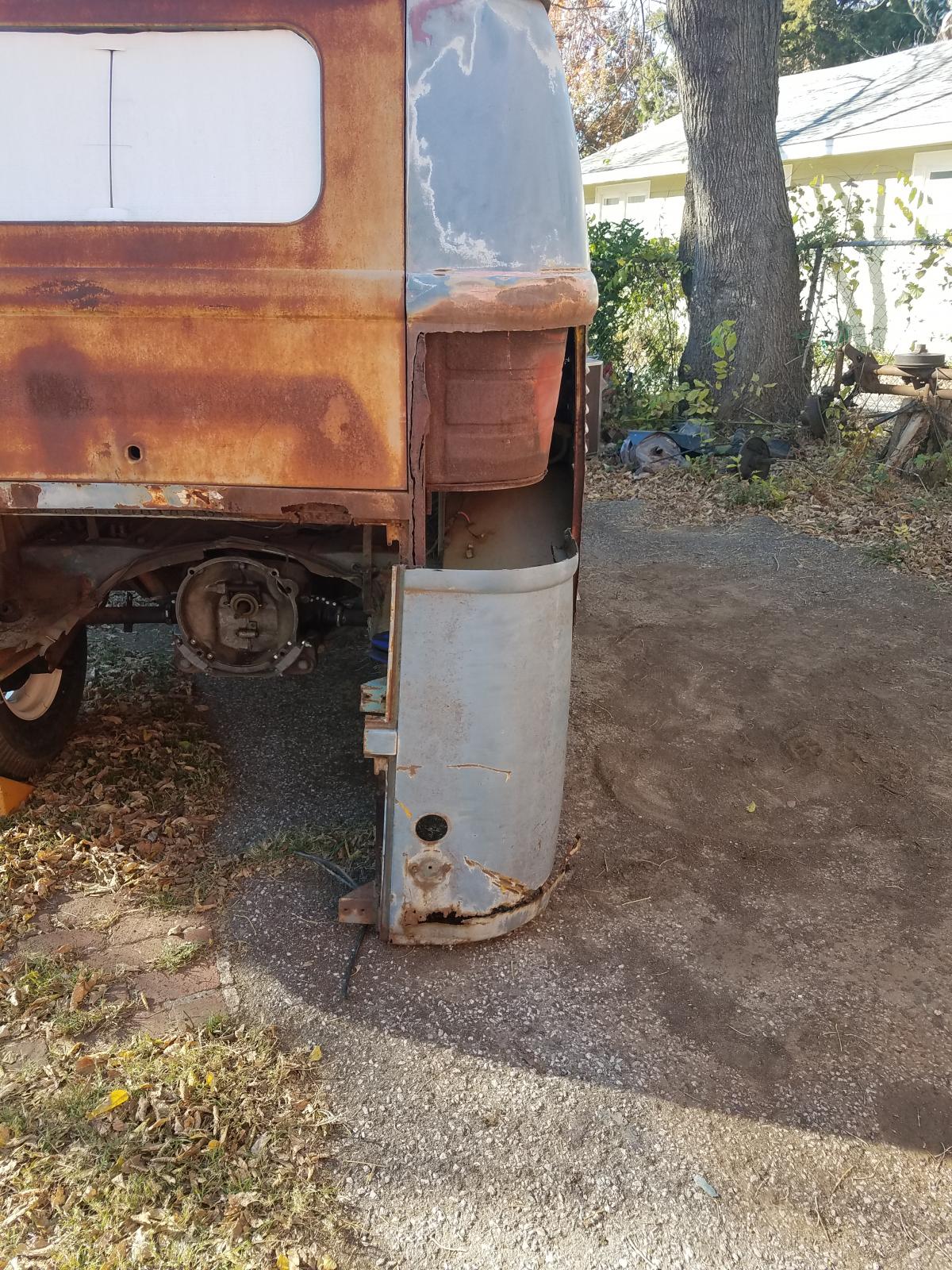

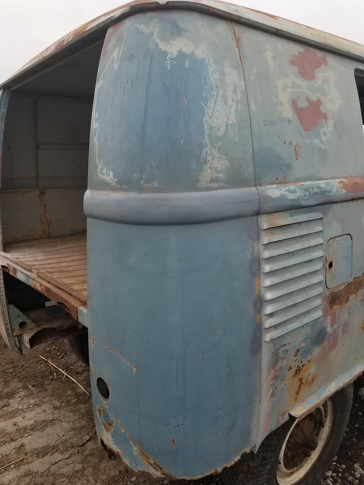

Well it's been a while since I've updated and I have no good excuse for that but I've got some progress to report.

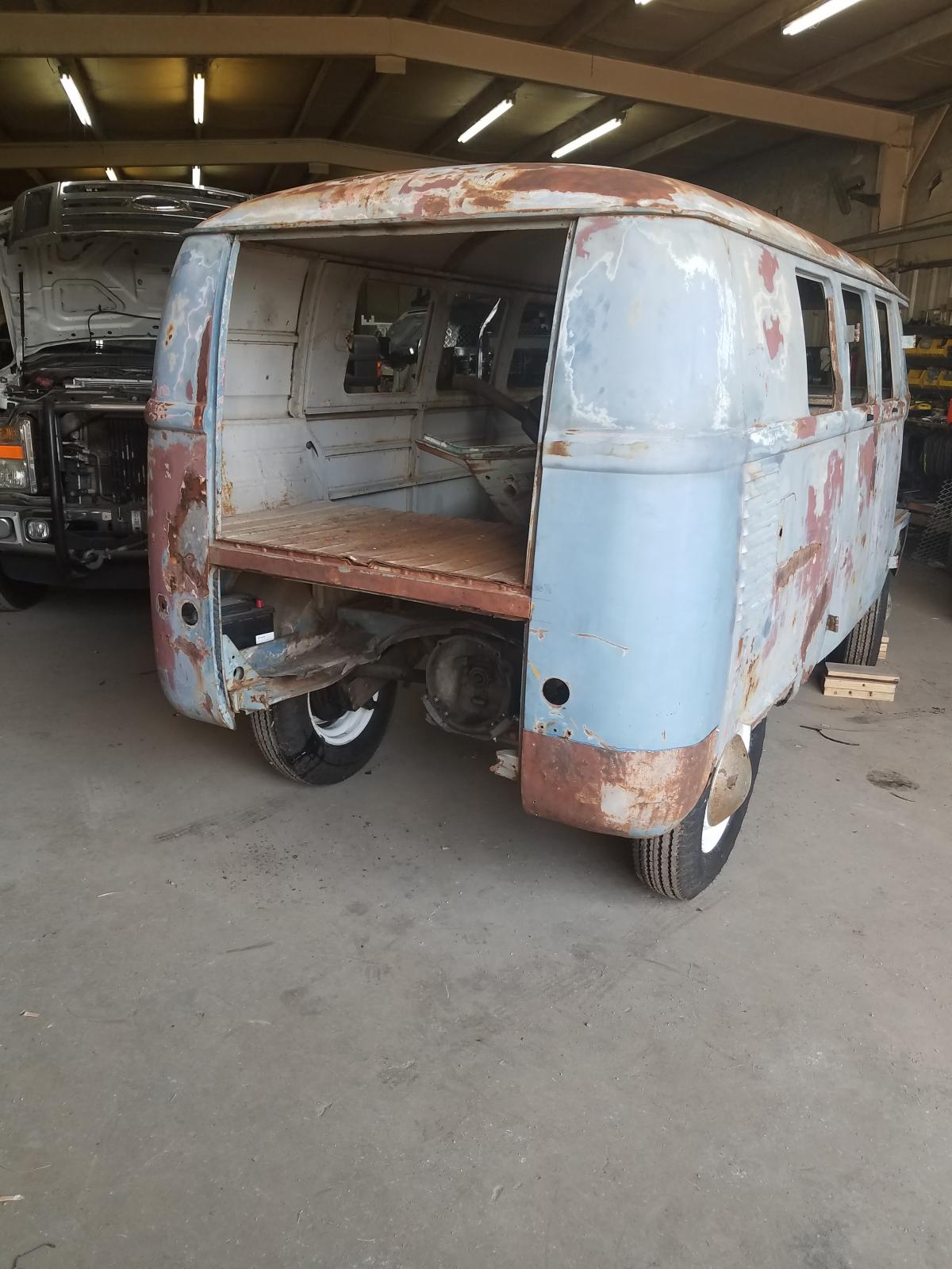

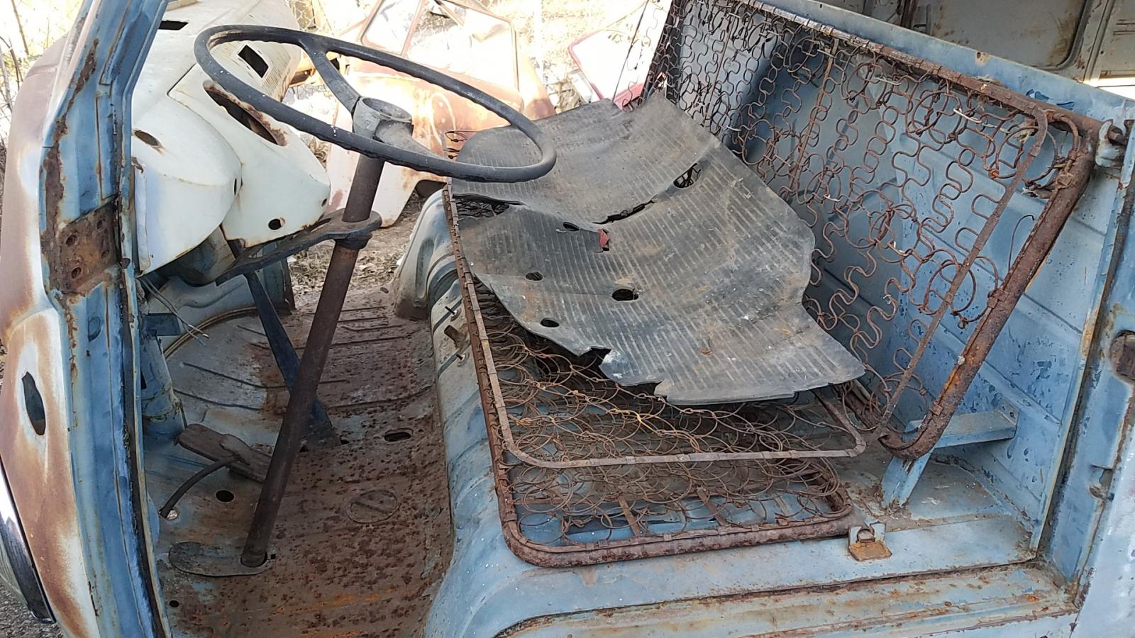

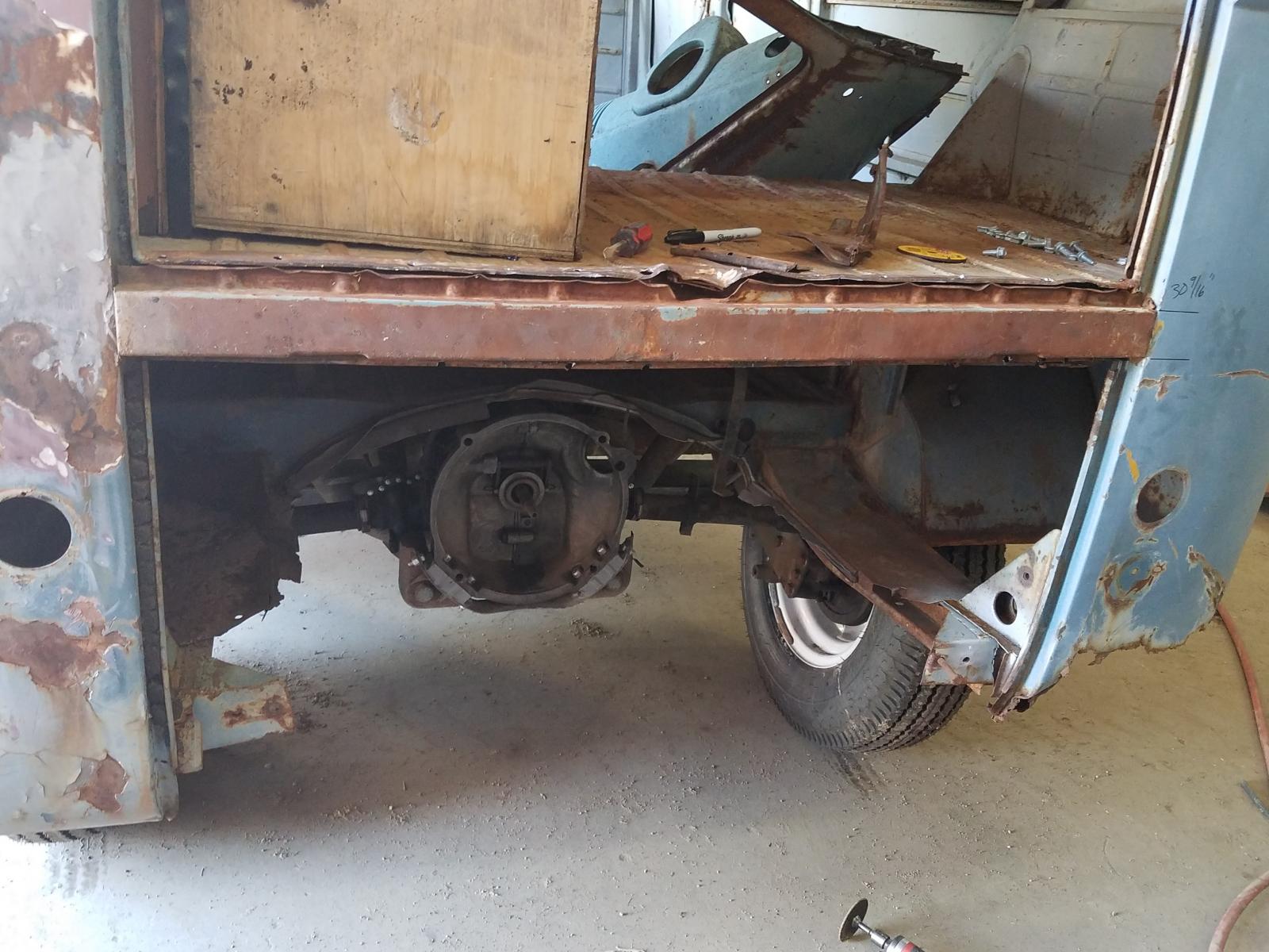

I cleaned everything out of the bus in preparation for dragging it out to work where I can get it indoors to work on it. The bus has been a storage for parts I've collected over the years for this project. I reduced it down to only the parts I'm going to be welding in or parts I need to bolt on to line stuff up.
Unfortunately the original 6 leg floor is pretty wavy.

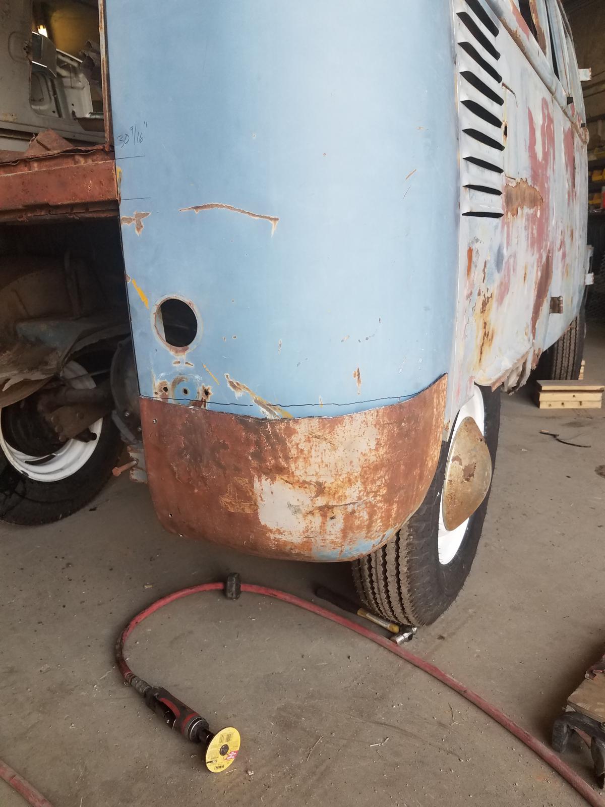

Before the corner went in I had to do a little filling where I'd gotten a little aggressive removing what was left of the old corner. I clamped a piece of aluminum angle back there to prevent blow through.
The first tac of many!

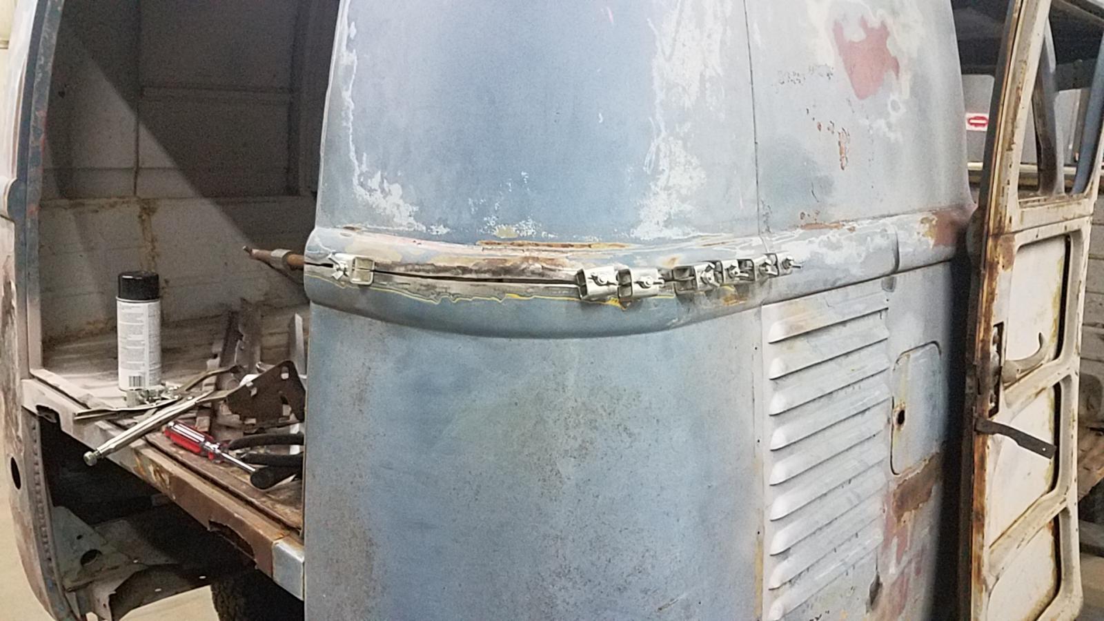

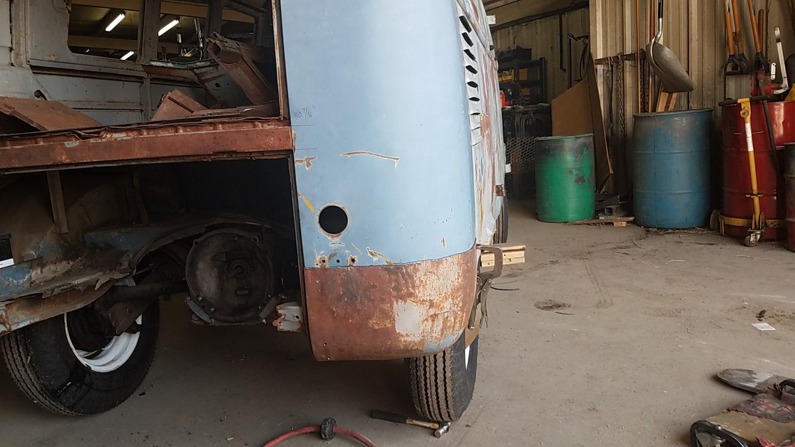

I was able to get the rear corner welded in. I still need to put the battery tray in and replace the lower corner but it was a huge step to get this done. I've looked at this bus for years with the corner hacked out.

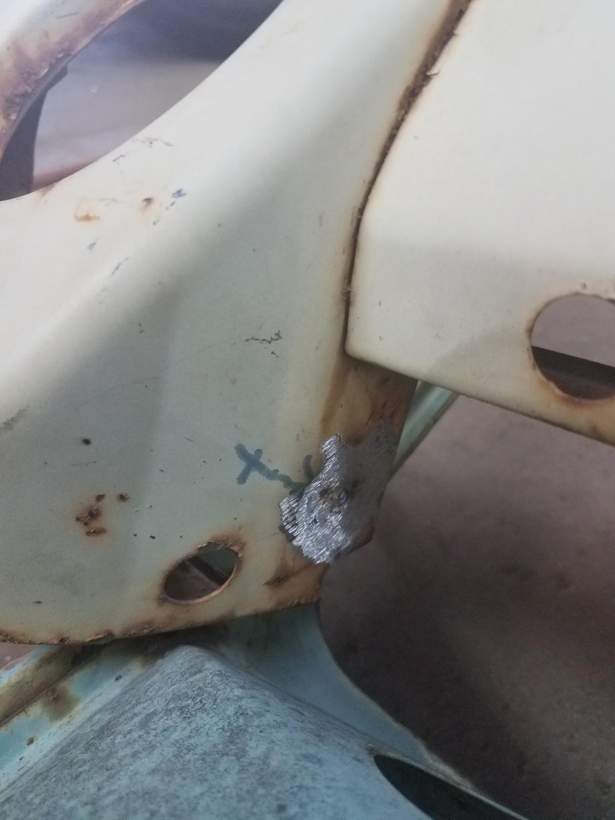

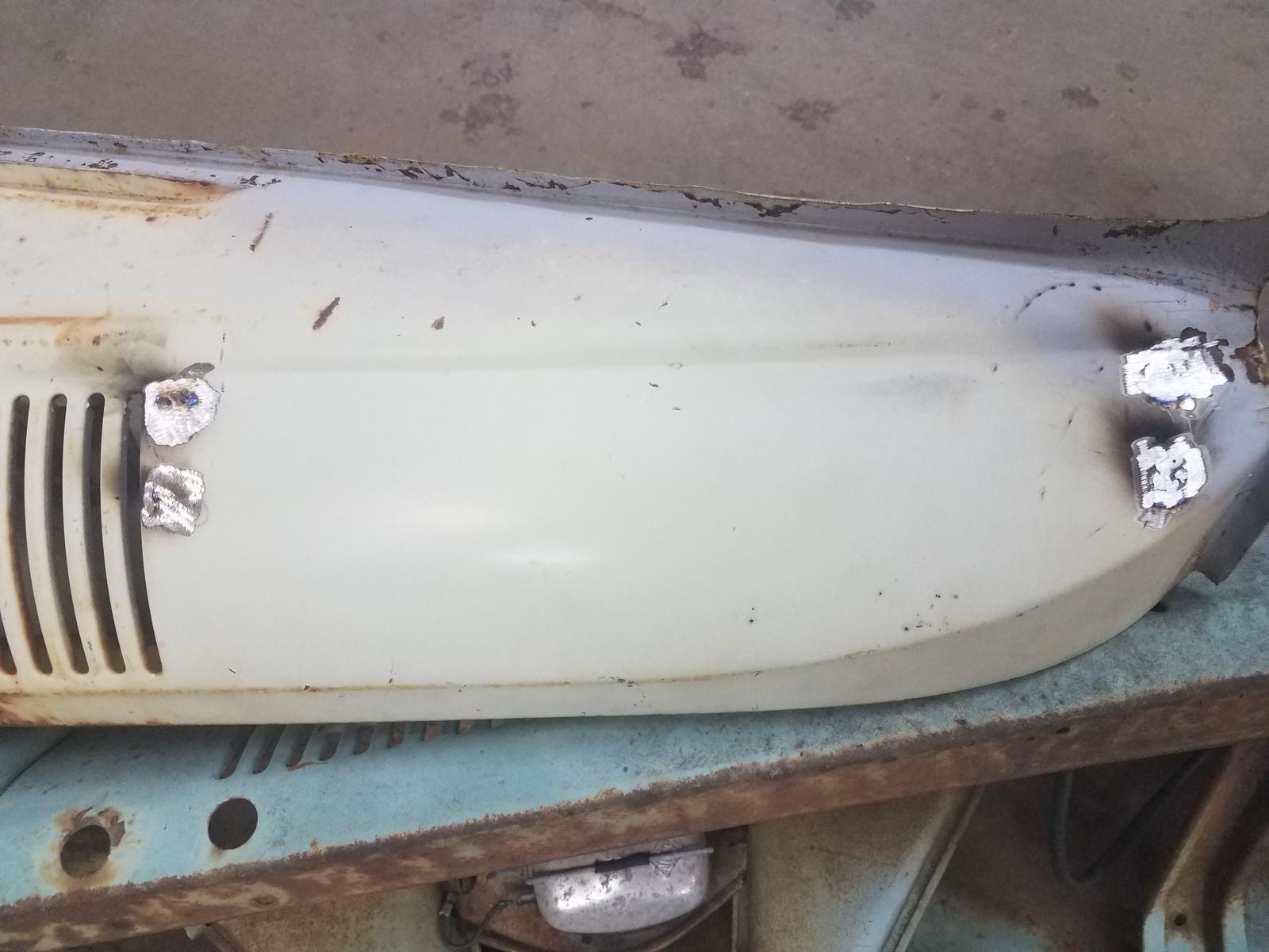

With a little time to spare Sunday evening I decided to get one of the front signal holes filled in. I think I've mentioned that this bus has had a nose job at some point in its life. Needless to say, those bullets have to go when you have original semaphore posts.

Don't know about anyone else, but I love these "peek-a-boo" pictures, when a project is moving forward (literally) from one phase to the next. Love the discoloration too! Keep it going!

completely on board with the blinker delete. Semaphores rule.
From the back it won't make a difference and up front you can see what is going on, even if the people can not

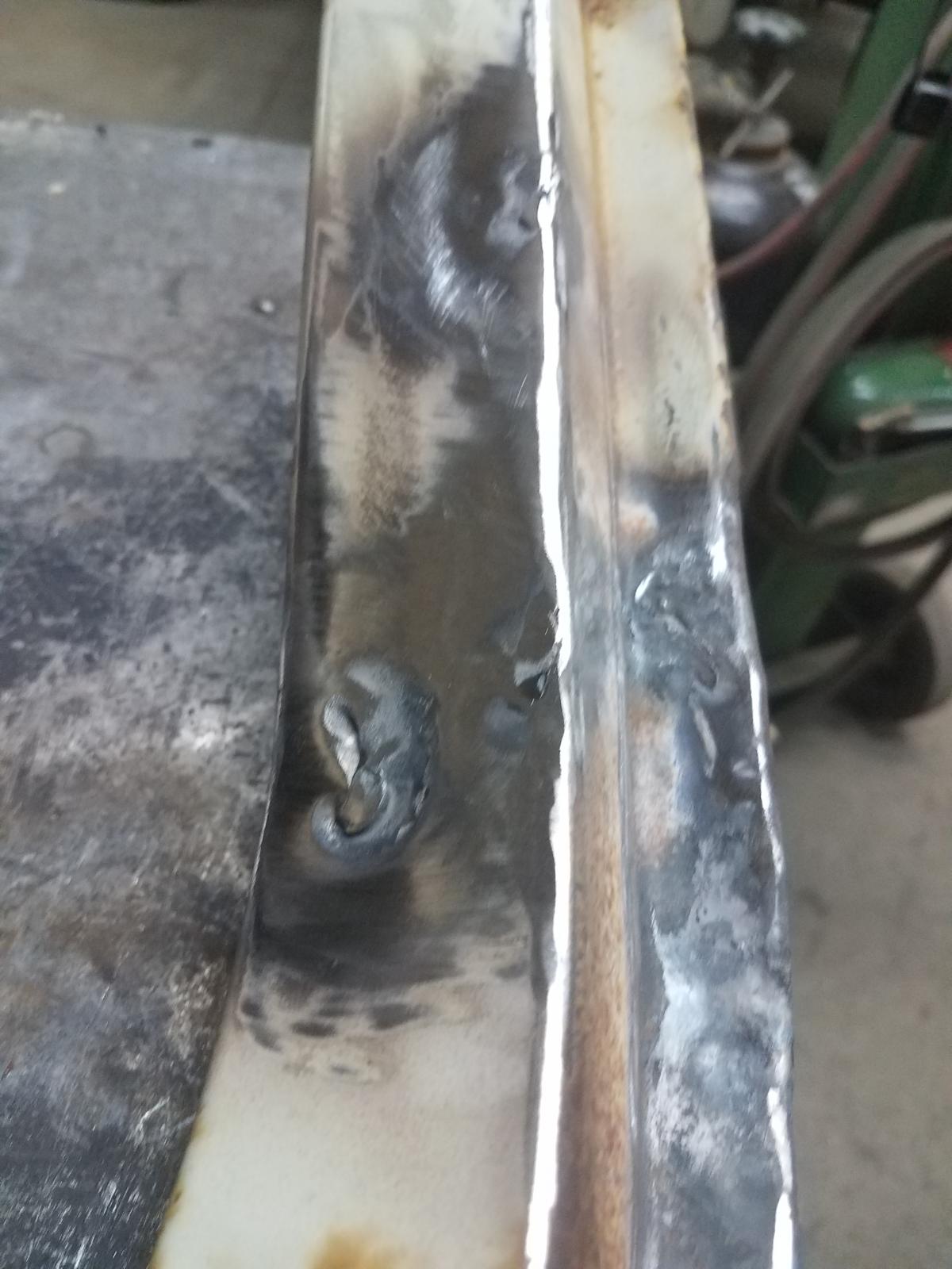

Well, once again some time has passed but I have some work to show for it. I sent some time working on the dash this weekend.
This is where I was starting from. It was real close from when I fit it years ago but definitely lacking final fit.
I went ahead and got the steering column and heater tube out of the way.
And this is what I ended up with after some grinding and cleaning and I'm real happy with it!
I still need to clean up the back side of the nose where i filled in the bullet turn signal holes and speaking of bullet holes, the donor dash came from a bus that had been used for target practice. Luckily the dash survived well enough but the parcel tray/dash support and heater Y-pipe didn't come out as clean. I heated the metal a bit and folded back what I could and I will weld them up from there.
I lifted the bus up when I needed a little brake and did some inspecting and I was really happy to see the lower shock bolts still had their lock tabs in place. It's the little things!

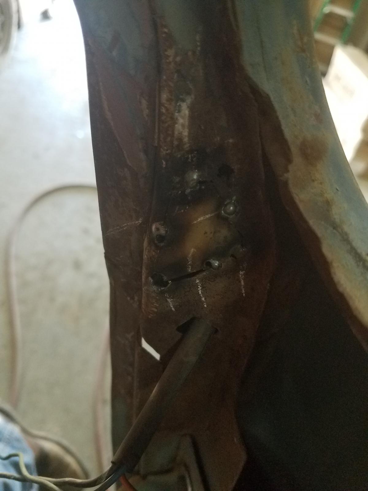

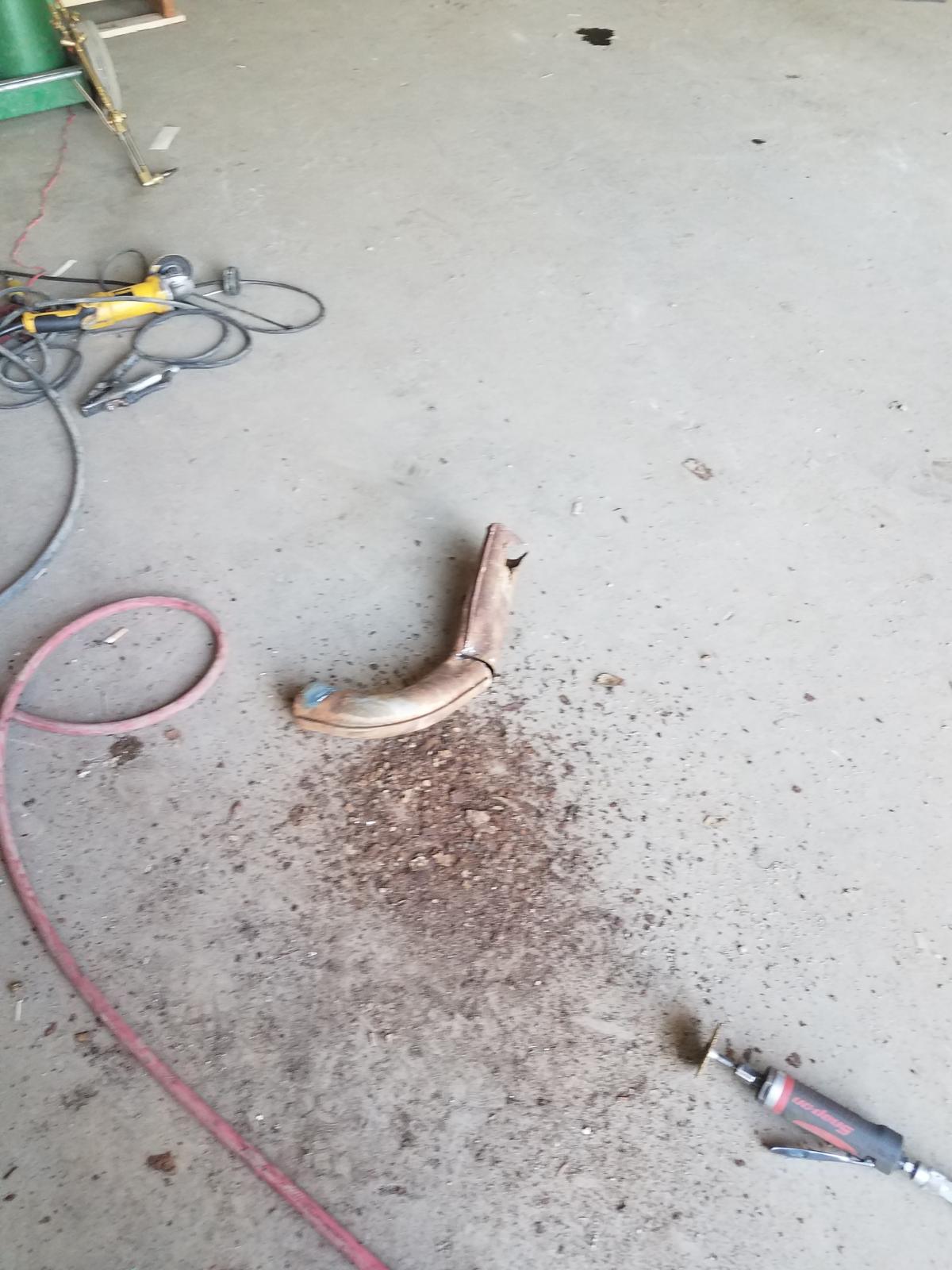

So, I'm not great with these updates so here's some recent progress.
Before getting the dash in there was some patching that was necessary in the A pillars.
Both sides got the same treatment. It was mentioned that the nose might flex without the dash and parcel tray support in there so I measured a couple of my other buses and it looked as if it held its dimension. The dash was a little gaped at the pillar though so I did a little weld line to help bridge the gap at install.
I got the unnecessary holes filled in the dash too.

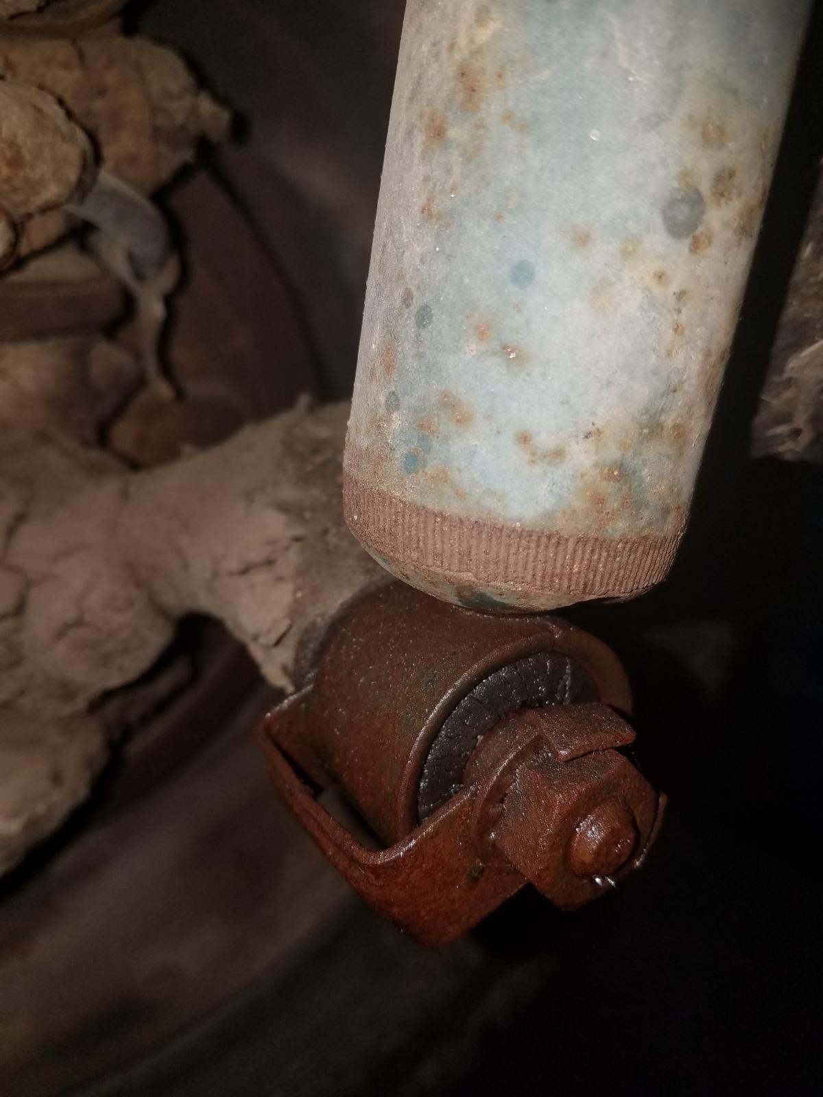

While fitting the dash and heater pipe and parcel tray support I ran into an unexpected obstacle. Things just were't fitting. Again, luckily I had other buses to measure and I found that the heater pipe had been installed almost an inch to high above the floor when the bus had a nose job. I later confirmed this when I found a donor heater pipe in my collection and could see that the one that came out had been shortened. So out it came! Probably for the better as I would soon find.

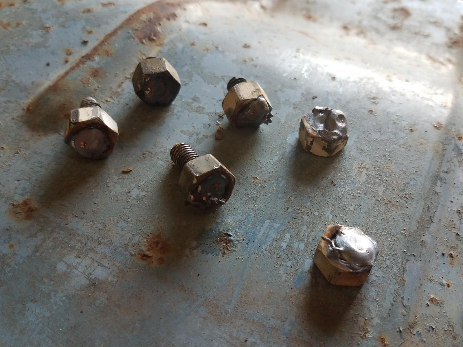

While I was down there, I decided to remove all four bumper bolts that were broken off in the frame.
