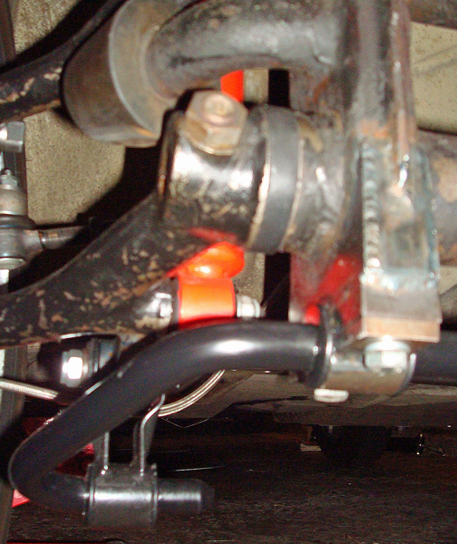

The biggest/best change I made was installing pan siffeners from Eyeball Engineering. They stiffened my pan to the point that I had to replace all my shocks with softer ones!
If you go to the trouble of purchasing/fabricating these, I would also install a truss bar (something I haven't done yet).
I had my machinist modify a later model link pin front end (with the mount for a steering dampener) so that 1) I could adjust the ride height and 2) I could use Porsche 356 sway bars.
I tried four different sway bars. The standard VW bar was too soft and the adjustable Porsche bars were too stiff. The current one that I purchased from Willhoit is just right. If make my ride feel nice and flat but I don't get whiplash every time I drive into my driveway.
http://willhoit-auto-restoration.mybigcommerce.com/porsche-356-17-5mm-sport-sway-bar/
Regarding shocks, I've tried the following: stock (nice and soft), KYB ("too much coffee" harsh), Koni for a VW Bug (way, way too stiff), and modified Koni's configured like a 356. If I were do do it over again, I would first try stock VW shocks, then ones from Bilstein, and then maybe modifies Koni shocks.

And damned that front sway bar is low!
