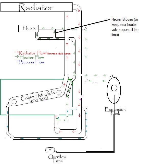

This is Tom Shiels Coolant 4 design. It is similar to the way a lot of people do it, whether you use the extra thermostat housing port or not. My coolant temps stay very steady and basically uses a simplified version of this. I made a modified drawing of the way mine is and posted it a few posts down.
When looking at this picture, you don't need that thermostat housing port. Instead the coolant hose coming off the left side of the manifold tees back into the 1/2" metal coolant return pipe that is up near the firewall on passenger side of the engine.
The bleeder valve shown to the left of the coolant tank is also not necessary (just makes initial filling easier but I've never found it that hard anyway). This design does require that your rear heater valve remain open so any air will bleed into the expansion tank. Or add a bipass (connecting the heater lines so there is always at least some flow through the expansion tank. [Without some continous flow through the expansion tank, you can develop small amounts of air in the system from loose hose clamps or whatever and that can cause the water pump to cavitate and you get intermittent hot temps and hot spots in the engine].
I think the Bipass Air Valve shown is only on certain engines (not my 2.5) and so when you remove all the extra crap, this design is simple and easy to understand.

wesitarz wrote:
... Adding a bypass between the heater lines (mine is near the gas tank) solved my temp spike issue. My VW temp gauge has a 33 ohm resistor inline, so maybe isn't as sensitive as the VDO.
This looks like another diagram from Tom Shiels website. This diagram is missing the bipass you describe and was the same problem I was having. People should be aware if they follow this, that they need a way to purge air when the heater valve is closed or you get weird intermittent things happening due to air in the system.
The two keys things for any plumbing design to work are 1) continuous air bleeding and 2) correct feedback to the the thermostat with hot coolant directly off the the manifold, but that doesn't require the add-on thermostat housing. You get varying temp symptoms from both of these if they are not part of the design, but the symptoms will be different. And the symptoms from lack of continuous air bleeding can look like other bad parts such as expansion tank cap, head gaskets, etc.

PostPosted: Sun Jun 10, 2018 9:35 am    Post subject: Re: Subaru swap coolant system drawing wanted Reply with quote
Here is a diagram of my coolant routing which is similar to Toms Coolant 4 diagram I posted at the top but I removed all the extra bits I am not using. And it works great.
The heater bipass is shown in the picture up near the heater, but on the van is a lot closer to the engine. And the 1/2" hose off the small side of the coolant manifold looks like it goes down and tees in right by the thermostat (which it could) but instead it goes up and tees in just before where the heater return line connects with the 1/2" metal coolant pipe that goes up and over the engine. It is more protected and a shorter hose going that way.

PostPosted: Sun Jun 10, 2018 10:04 am    Post subject: Re: Subaru swap coolant system drawing wanted Reply with quote
I've been running Tom's Concept #4 for ~75,000 miles with no issues. I didn't reverse the coolant manifold but I am using Tom's thermostat housing.
Good heat in the cabin and the temperature gauge sits rock steady on the the warning lamp.
