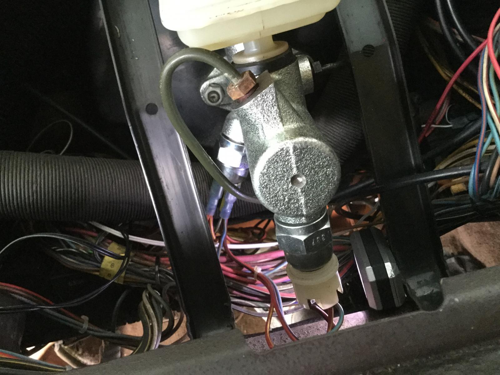

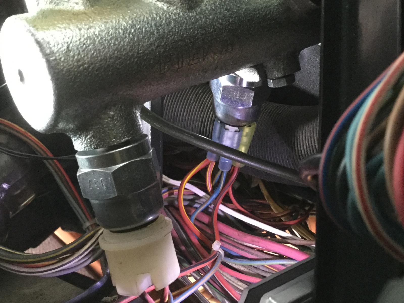

PostPosted: Fri Dec 27, 2019 4:59 am    Post subject: Re: Brake weirdness Reply with quote
Jasonerao
I found these photos of my switch wiring after i repaired the melted front plug. Hope this helps...
