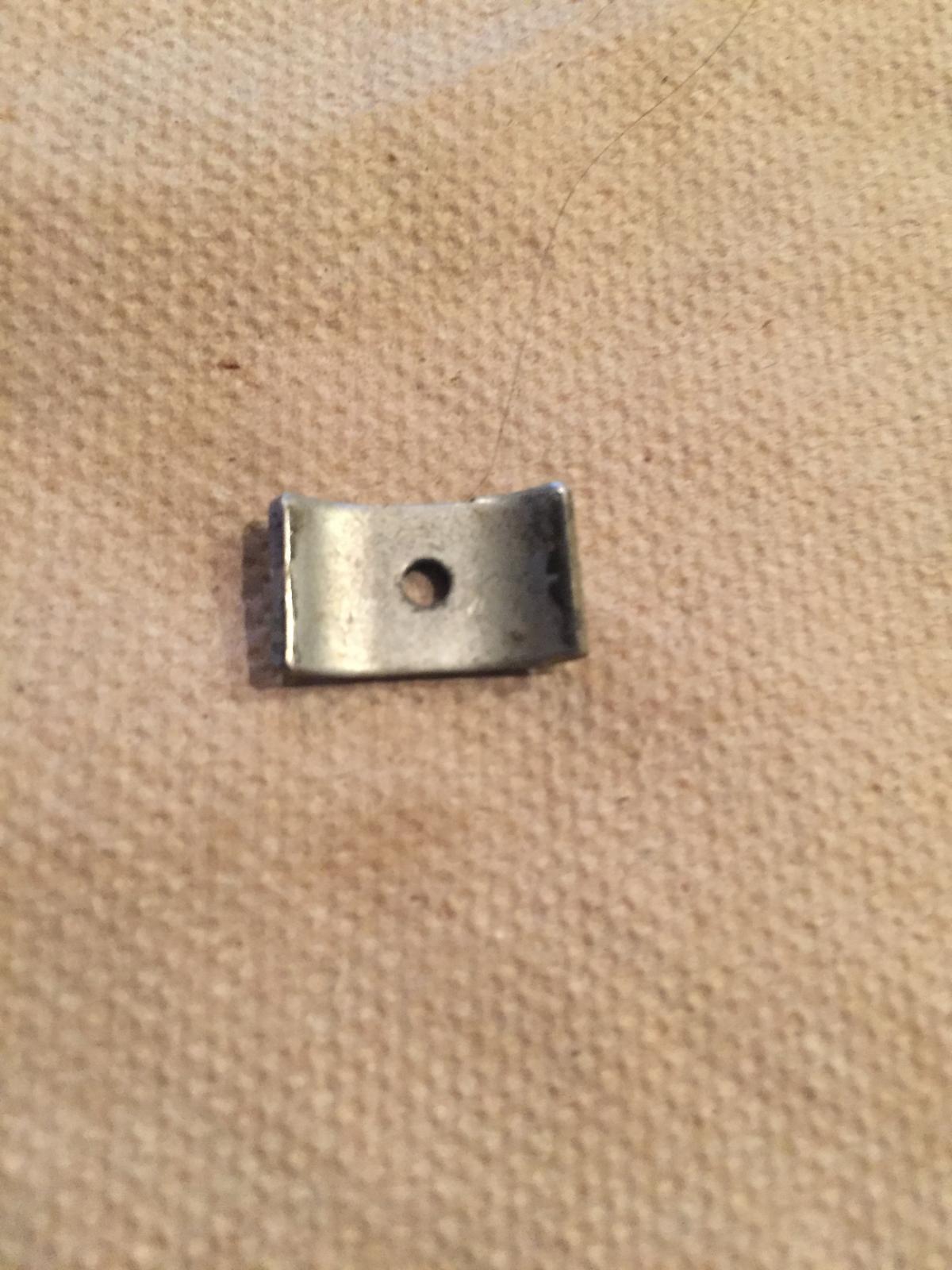

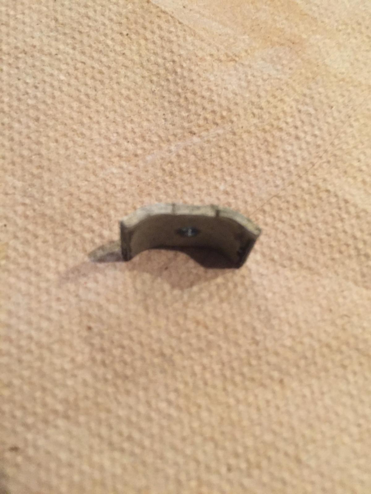

Want to confirm if this item is from the horn ring or in that section of the car. It fell out during the disassembly.

With no sense of scale- I'd guess if it's sitting on a hand towel then it's a horn wire anchor plate. It should have been held with a screw.

Looks like the plate the turn signal switch set screw threads in to, holds the switch in place on the steering column tube.

yep for the turn signal set screw
X3

Cool - thanks.
