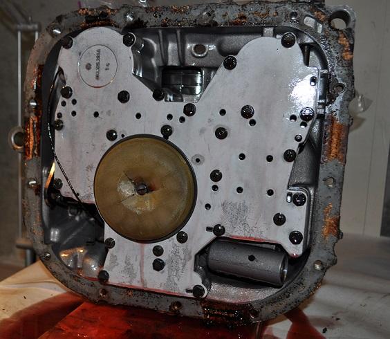

Second thought: I took the pan off and saw that my filter was ripped:
Rockauto.com carries two choices for this under 20$.

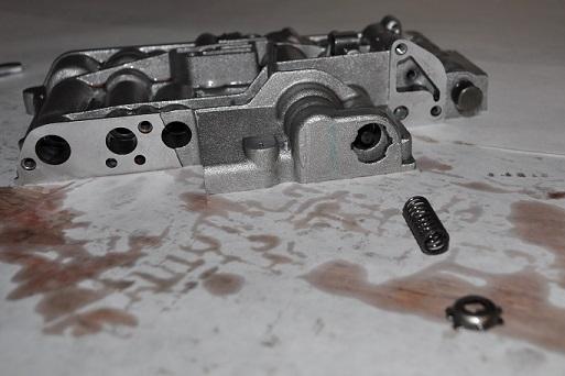

Third thought: I found it was easiest when disassembling the valve body to remove springs and then tip the valve body to remove valves. Here is the back plate removed with nothing taken out yet. There is a ton of stuff here, so be slow, label and box everything.

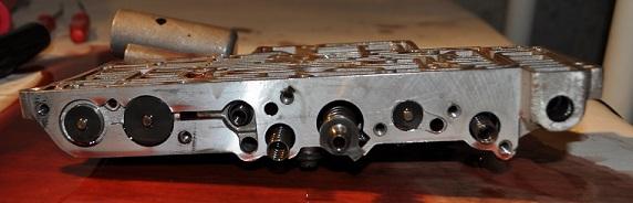

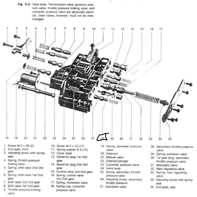

Now, a question for everybody. I am about halfway through the disassembly and have reached a sticking point. The secondary throttle pressure valve and its spring ( figure 5-4 in type 3 bentley #25 and #28 ) do not want to come out. You can see the spring loaded under some sort of clamp with an allen bolt here. The valve runs right through the spring:
How do I get that valve and spring out? Do I need to count threads and loosen the clamp?

I actually figure out how to get that secondary pressure valve out, but not its spring. Turns out the valve was just sticking in the bore a little bit. I went to Ace Hardware, got a little 1/4 inch brass rod and tapped the end of the valve where it pokes out just beyond the spring clamp. That got the valve moving, although the spring is still in there so anything you can dig up on the secondary pressure valve spring is welcomed.
One side note, I did find that a note about one of the other valves that has an adjusting screw also applies to the secondary pressure valve. It is one of those "Do not touch the adjusting screw" style of warnings, so the thing must just flop out if you pull it in the right direction? A little paranoid of bending the sucker though, so I am definitely waiting for other folk's input on that one!
After I got that valve out I left the spring in and moved on for the moment. I moved to the other side and took off the front plate. Those three valves under the front plate came out with no problems. The springs just fell out and a gentle shake got each of the valves out. Now I am on the converter pressure valve and that one is a bear. The spring cup that holds the valve spring in is an odd one. I think it needs to twist clockwise or counter to come out. Once I have the cup off the spring and valve should slide out. The spring cup doesn't want to twist easily though and it has an odd aperture. I will post some pics after I stare at it this afternoon. Fun! Very Happy

Just in case it wasn't clear, I outlined in white the secondary throttle pressure valve body.
I think I got past my converter valve stopping point! Here is the front of the valve body with the converter pressure valve cup and spring removed. The valve is still sitting in its bore, but a gentle shake and that slid out far enough to remove.
My biggest worry taking this off was the bending the spring. I don't think I bent the spring taking the cup off. In fact, I could see any way to remove the spring cup without slightly depressing it. The teeth on the cup are at varying heights, so to disengage the teeth that were keeping it from rotating you have to press the cup against the spring lightly. Anyway, I pushed the cup in with my index finger and turned it counterclockwise. I am sure there was a special tool that looked like a weird torx socket that would do it quicker and more surely, but gentle and steady finger pressure seemed to work OK.

A brief hiatus for the transmission filter to come from rockauto before I finish the valvebody cleaning. I got back to it today and got about 90% of the way through before hitting something unexpected. The Bentley talks about how valves should sink into their bores of their own weight without sticking. Every valve did that except for one, the secondary throttle pressure valve The valve sinks down until about 2mm remains and then I hear a "thunk" and it stops. I can see inside that about 2 mm of the tapered portion I circled below that doesn't sink into the last bore.
I've got a hypothesis about this I wanted to try with you guys before I actually test it. This is the only valve in the valve body that is "backwards." The spring is on the interior of the valve body rather than on the outside like all the others. What I think is that the tapered portion of this valve is a spring seat that requires a little nudge to get it to engage the spring. I think you can use the plug (part #30 in the fit) to give the valve that nudge. I have an observation from disassembly that might support this. I noted that I needed to use a brass rod on the very end of the valve to even get it started moving out of its bore. There must be a slight catch where the valve engages the spring.
What does the 003 crowd think about this idea? Give it the extra nudge?

Welllll! I tried my own solution to that one valve I could not figure out how to release. Leave it in!
