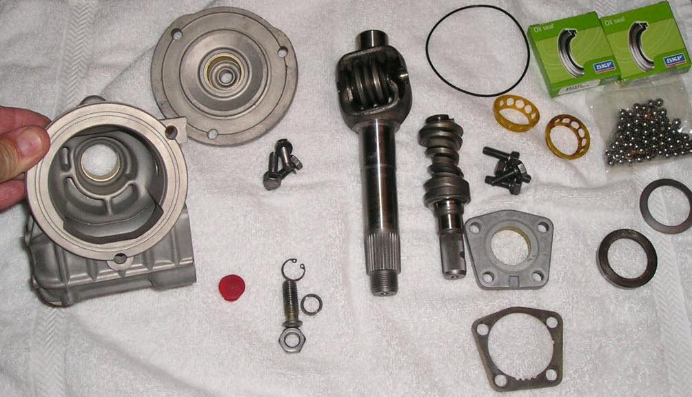

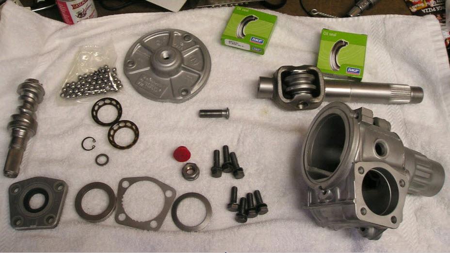

There are three genuine VW steering boxes on bays that I know of.
1) early until 1972. There is a peg that wears and no one makes them. NOS ones appear unibtainium, otherwise they would be rebuildable. Instructions in Bentley.
2) Early 1973. Made in France by Gemmer factory. Same place Ferrari boxes were made etc.
3) Gemmer licensed to ZF in Germany to make their boxes. The French and German models look near identical except the nut that holds the pitman arm on is bigger on the German box.
The late boxes are quite durable. I cleaned and restored several late ZF boxes. One was worn so I tossed it but the others were fine. The last one I rebuilt feels no different than this NOS ZF one Hoody found for me.
If you understand how they are supposed to work you can easily adjust them and determine if they are worn. Imagine that you have a gear and worn that steers the car. The gear turns the worm which thru levers turns the wheels. As you use it parts would wear and play would develop - so you might add an adjuster screw to set the play between the gear and worm. Since you spend most of your time near the center of the setup, those teeth and the worm would wear more. Right? So you keep adjusting the gearbox to keep the play out. Now one day you turn the gearbox all the way to one side in a hard turn - but now you are in a part of the gear and worm that is not worn. Since you have tightened it the gear jams and you crash. That is what happened when steering boxes were first invented. Then the engineers came up with a fix. If they made the gear and worm so it was looser to the outside and tighter in the center, as it wore and was adjusted, the outside never jammed unless the center really wore away. So with normal wear the box simply got closer to even. Think of it like a road. When the tires ride the highway gets a rut in it. What if the engineers made that area a little higher when they poured the highway? Then as the rut formed the highway would be flat. It wouldn't be until the highway was really worn that a rut formed - instead of flat to rut it would go from raised area to flat to worn.
So if you can adjust your steering box per Bentley or the Orange book to where there is appropriate drag in the center, and it is still loose outside then the box is not too worn. Just keep gear oil in it. The seals can be replaced. If however it is loose in the center but binds either side of center it is worn out. That one I threw away was like that but the others were Ok. The one I took off my bus when I put the NOS one on felt exactly the same as this NOS box.
I think most of you with 1973 on boxes just need to adjust them And the 1972 and earlier boxes someone needs to find a machine shop to make replacement pegs. They can even use an old peg to test the Rockwell hardness and match it if you get a good shop. The peg eventually stops turning and gets flat spots on its sides. If you could get a new peg you could do a lot to make it feel like new. You would spread the wear over the whole peg instead of just one tiny contact area.

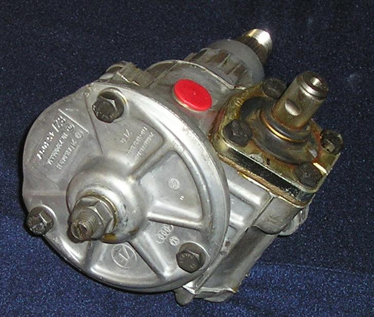

I have a 76 Baywindow and the box is fine other than all the oils leaking out of the big round 4 bolt gasket anyone know where i can purchase a rebuild gasket kit?
Thanks in advance!
SGKent Premium Member
Joined: October 30, 2007
Posts: 42364
Location: at the beach
SGKent is offline
PostPosted: Thu Nov 15, 2018 3:45 pm    Post subject: Re: Wat Spain new!!!??? Steering Box for Later Bay Bus Reply with quote
Use RTV? The boxes are unserviceable as to parts other than the shaft seals which are standard sizes. Original looks like maybe Curil was used. The top photo is a NOS box right out of the factory sealed wrapper. You can see the Curil? oozing out between the plates on the 4 bolt gold part.
