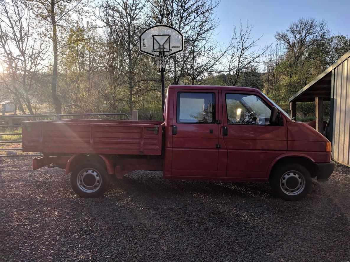

I'd like to introduce my new project vehicle. I've had it since January and gathered some ideas, but I haven't done much.... yet. Smile
It all started with an email from Frans at Dutch Auto Parts. I have bought quite a few parts from him. He supplied the parts for converting my 99 Westy to TDI. He's a good guy. We keep in touch through email. A year or so ago, he sent me an email asking if I'd be interested in a T4 (Eurovan) PICKUP. My immediate response was "YES! but I'll have to wait a couple more years so they are 25yrs old and easier to import". He then explained that Europe got the T4 in 1991 and they were now old enough. After that, the hunt was on! Very Happy
He kept his eyes open for a few good examples that were worth importing. In Europe most, if not all, of the T4 pickups are used commercially. Think about an early 90s domestic pickup that has been used commercially all its life for a minute.... Do you envision one in good condition? Yeah, me either, and generally, that's the condition of these T4 pickups in Europe. He had his work cut out for him and it took a while for him to find one good enough to send. Late last year he had rounded up an example of each style available, a crewcab (Doka), a short box single cab (Sinka), and a long box single cab (Sinka). We worked together to get them imported to do Oregon. The thought was to import them all, see which one I wanted to keep and sell the other two. I have other vehicles I can’t haul my whole family in and I decided I didn’t need another of those. The Doka was the one for me.
My plan is to upgrade this one in quite a few ways and daily drive it. My commute to work is 54 miles/day. It is currently a 1.9 diesel. I’ve only checked two tanks but I got 27.5 and 30 mpg. Not bad. I really like the additional power in our 99 Westy though so the Doka will be getting a TDI. I’m still not sure which one, but leaning heavily towards a 2.5. There are a number of other ideas I have that I’ll share later as I get time.
Writing this and then looking for pictures made me realize I don’t have many pictures of the Doka. Here are a couple though.

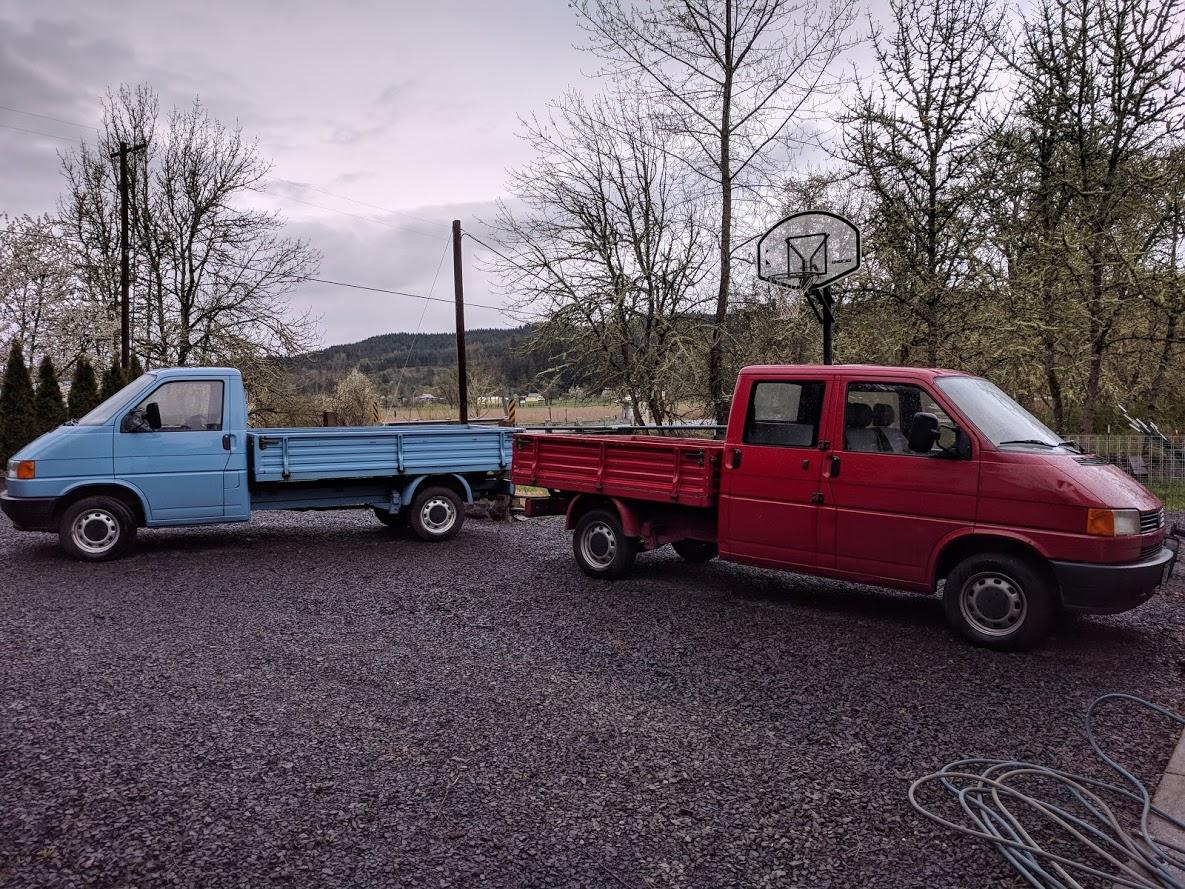

Tough Decision that I was faced with one morning... which do I drive to work? Smile
That is a cool photo, looks like a VW brochure shot

Thanks Everett. I wish I would have pulled the air hose back in the shop. Kinda made it messy looking. I just took the picture to text to a friend but had to scrape around for pictures of it this afternoon.
