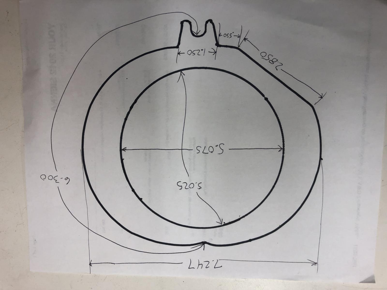

I got the part today!
It’s kind of an odd size/shape.
Maybe it would work to trace it out with paper & pencil and mail it to you?
Going way back a couple hundred years with my methods here..
Otherwise, I should be able to make a bunch of misc. measurements and take pics with a caliper and whatnot..
Let me know what you prefer.. What you want I can get.

Clatter, no need to trace it -- there's a trace drawing already circulating on this and other threads. The drawing is purported to be scaled to an 8.5 by 11" sheet of paper, so it would help me if you measure almost anything on the part, like the inside diameter of the large hole for instance or the overall size, and that will give me a sense if the scale is correct.
It's probably close enough -- I might just print one and try to install it this weekend or next. I also have an old alternator laying around somewhere and that would probably give me a sense of the dimensions.

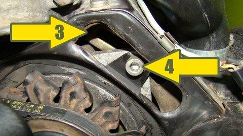

The fork wraps around the alternator adjustment bolt.

Thanks ivwshane -- that's helpful. That does mean something in my print is off. The bolt hole doesn't line up at all.
Does the seal sit on the flat on the alternator the way I have it sitting? I'll play with the geometry a bit more and print another one tomorrow

if you look at the drawing the dashed area is 90 degrees to the plane of the tab and body. It looks like you have allowed for that area twice - once at 90 degrees and once by adding it to the tab.
There are two bolt holes on the alternator. One sits at the bottom with a thru bolt. The other is the locking bolt.

Well, dag, I finally got some time after work last night.
Will put these up just for the record..
Looks like you nutted it to me! Very Happy
FWIW, that little tab always did seem kind of wonky the way it fit..
The thing is a little bit 'conical', as you can see here.
My guess is that is just error in the manufacture?
It's also tapered in profile.
This measurement taken at the thickest point, at least before the inner raised 'ring'.
Here I'm trying to account for the conical shape -and- thickness.
FWIW. Rolling Eyes
Thickness without inner 'ring' just measured without consideration of 'cone':
Here's a measurement of the actual thickest point, including the raised inner ring.
(See also blurry drawing of what I'm measuring in background).
Trying to get overall height of the mounting tab.
Like so:
Tab ID:
Laying it out:
The thing isn't really a super-precise part..
I went more dorky on it than what you might need.
Looks like it's already well handled,
But,
Since I took these pics and all,
There you go.
Glad to see that this piece isn't going the way of the Dodo! Very Happy

thanks for all the measurements clatter! that helped me fine tune. I printed one out that is probably usable, but I dialed it in a little more with your measurements. I'm printing this one out and then will try to install it to see how it fits. It might be a little thick compared to the original, but I'm hoping the sheetmetal bends with it.
here's the v2 print
and then the updated one (v3) with your measurements checking out pretty close for what it needs to be. It's 3 mm constant thickness, but i'd like to keep that if it fits for stiffness.
