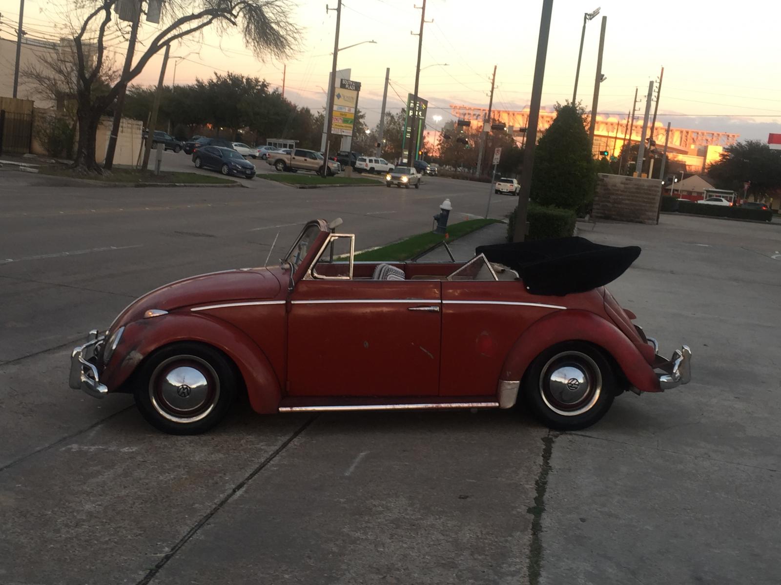

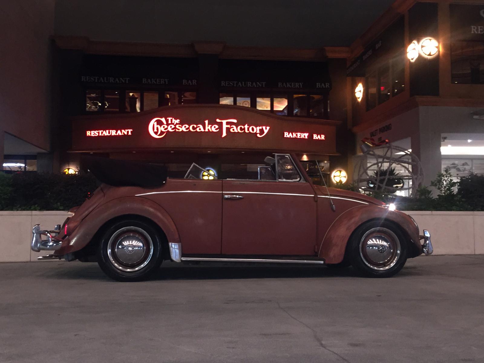

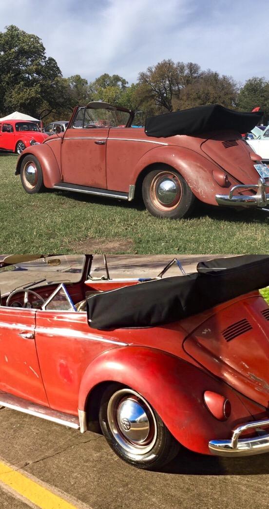

Just started removing primer off my 1960 Vert. Saw OG paint under there and went for it. It’s a only year only conv color, Paprika Red.
It’s a slow process, but feel I’ve made a lot of progress on it...two wks of work so far.
This car is ridiculously solid, and the more primer I remove the better I feel about how solid the car is. Support rails are mint, quarters are mint, heater channels etc all great. The pictures below show various stages of my progress.

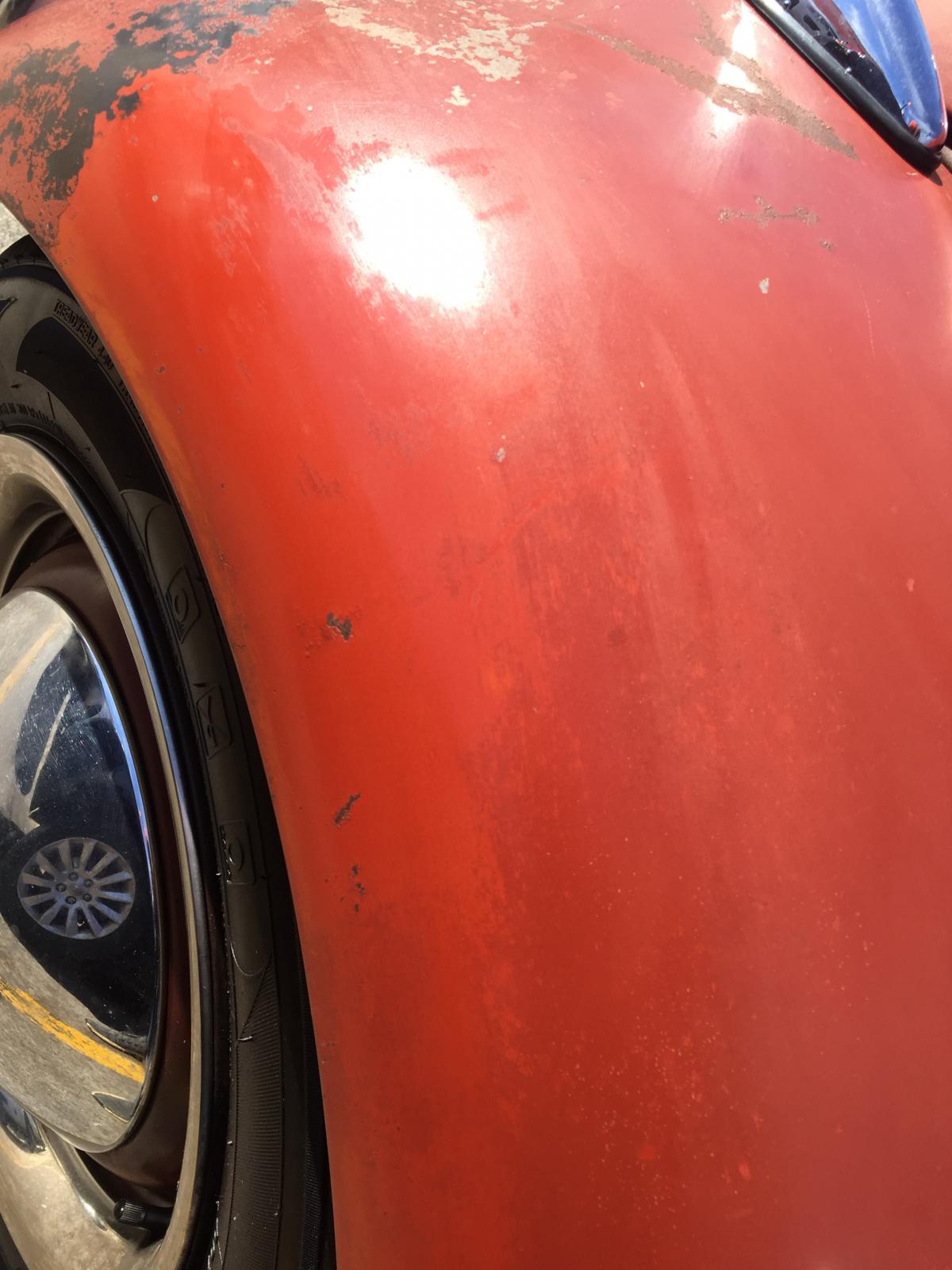

I started with pass quarter and it turned out perfect which led me to unrealistic expectations that the entire car would be perfect OG paint...wah wah.
However; almost the entire cars OG paint is there with a few bare metal areas where a PO got happy with a sander 🙄
Any feedback on how to blend in those areas would be appreciated. Also, any advice on this project would be valued.

Looks like you have less bare spots to blend then I do. I used acetone to remove primer from OG paint. It worked great and didn’t eat through any areas. The only spots I have bare metal on are from a PO getting into paint with a sander.
Hoping to blend it good and have a mostly OG paint Vert.
Any feedback is appreciated.
