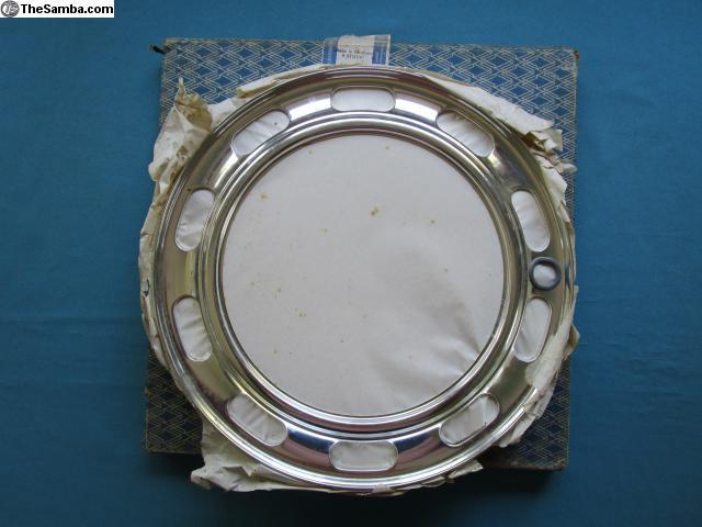

Here is an example of one:

Not certain, but that ring should fit all VW's . Flat caps and baldies.

The 141 is what are on my '66 KG, and I bought an NOS set in the original box (also 141) and they are remarkably nice. Given the wheels and wheel covers are interchangeable for '66 and '67 Type 1s and KGs, who would know unless you looked at the part number stamped in the inner edge of the trim ring. I don't know if there's even a specific one for the Type 1 with a different part number, since they are interchangeable wheels. The guy I bought my set from in England has one more NOS set, unless he sold it in the last 6 months. Message me for his info if you're interested in his contact info.
These are the ones I have.

The 141 is what I have for my '66 KG, I bought an NOS set in the original box and they are remarkably nice. Given the wheels and wheel covers are interchangeable, who would know unless you looked at the part number stamped in the inner edge of the trim ring. The guy I bought my set from in England has one more NOS set, unless he sold it in the last 6 months. Message me for his info if you're interested in his contact info.
I'd love to know who the guy in England was if you don't mind passing the info! They seem like a part you can't buy too early in the process Smile

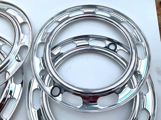

Since the late (?) 1966 and 67 bugs used a specific rim/hubcap (5 lug) are the beauty rings different also?
I got a set of rings and compared them to the beautiful rings posted and the interior portion of my rings are flat while the ones in the pics have a "bump"?
Any help?
Any help?
Dave
Post some photos
