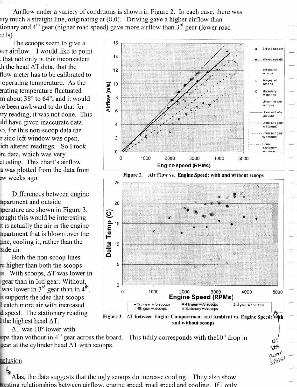

Some of you remember me mentioning a project I did for a college physics project to look at cooling in an ACVW. I wanted to see if the ugly scoops some people like to put on the vents actually cools the engine. Here's a couple scans from my lab notebook I found today.
Interesting... air flow from the heater vents goes DOWN with scoops on.

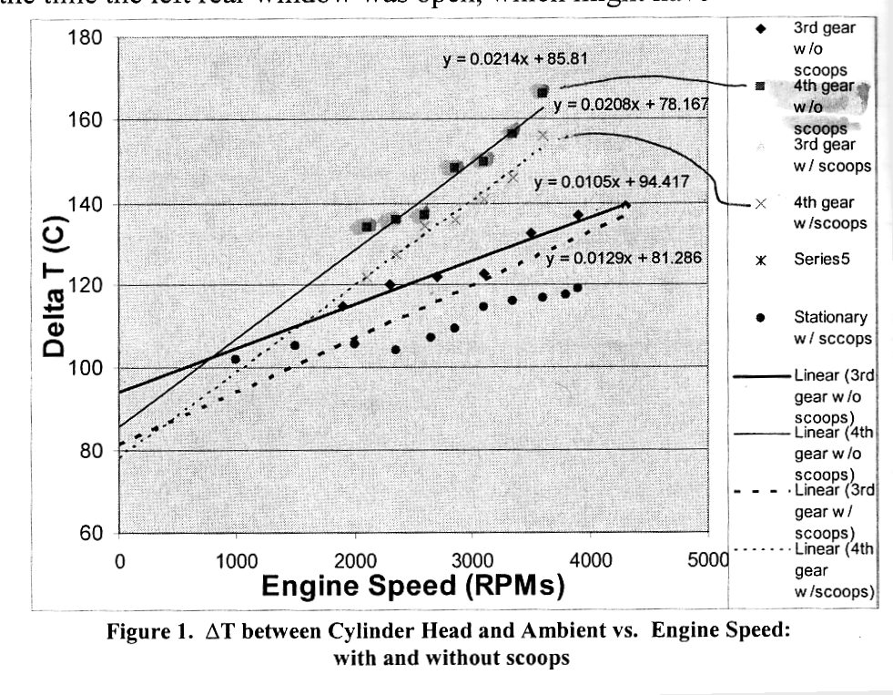

on the figure below I added straight lines with the computer program. But I think that was a mistake... the temperature at the heads does not go up directly with the rpms... so look at the points and ignore the lines

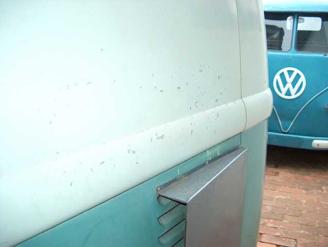

My 63 Dormobile had these fugly (but well made) vent scoops when I bought it.
I did an unscientific test of running the same engine in my unscooped Fleetline panel and the Dormer.
It consistently ran cooler (dipstick test) in the dormer.
FWIW.

The reason I did this test was because I had heard people say this or that makes an engine run cooler, but no one had any numbers to back up their claims. Just an opinion. Or a line of reasoning. And I heard conflicting views. I actually wanted to test more than just scoops, but ran out of time.
The odd thing is that the mechanism for sccops making the engine cooler was NOT what people had claimed... people seemed to think it would make more air run through the cooling system due to the scoops 'pressurising' the engine compartment. But less air was blown by the cooling system. Think
