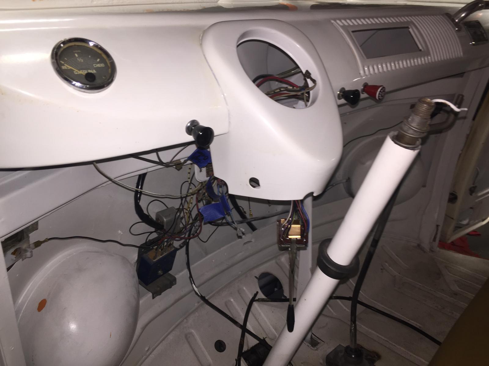

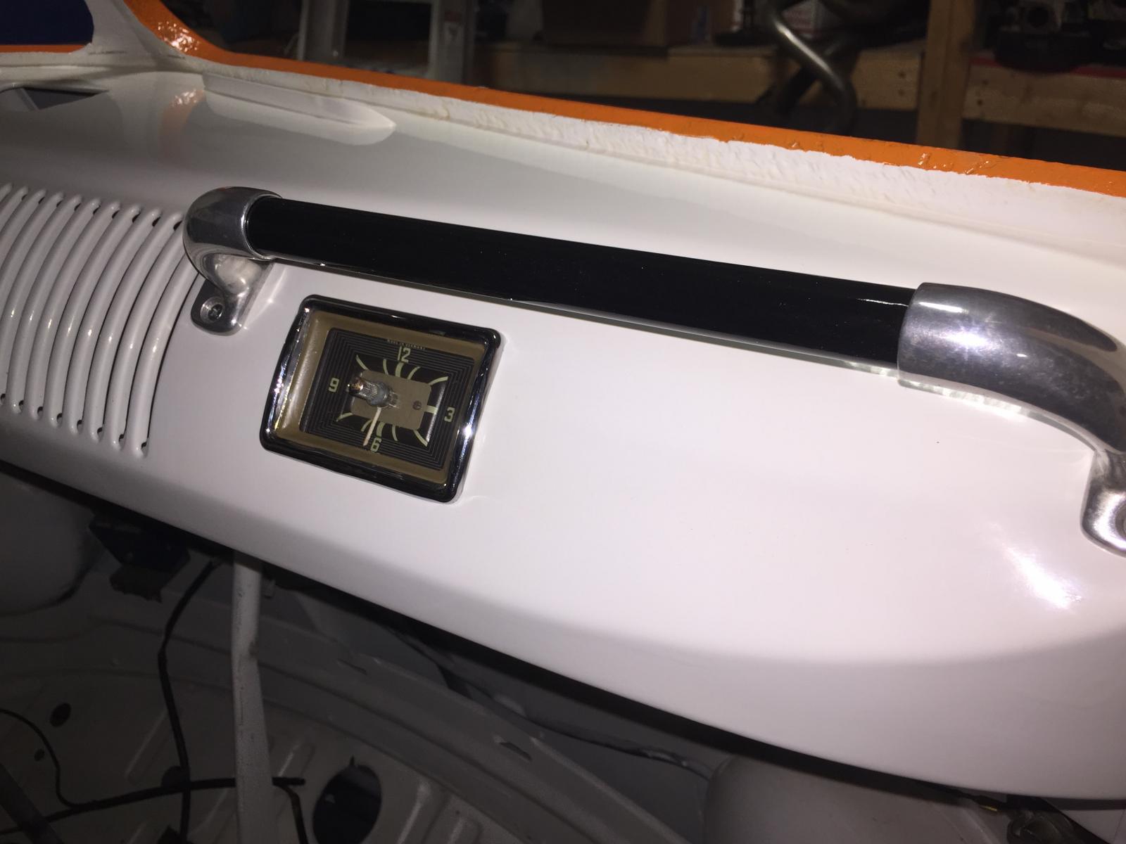

I took my deluxe clock apart and cleaned it throughly, re soldered the fuse link and cleaned all the contacts. Then i polished the bezel and painted the inner frame. The plexi glass cover was really marred, i polished it the best i could and put it back together! Its looks pretty good and works great!

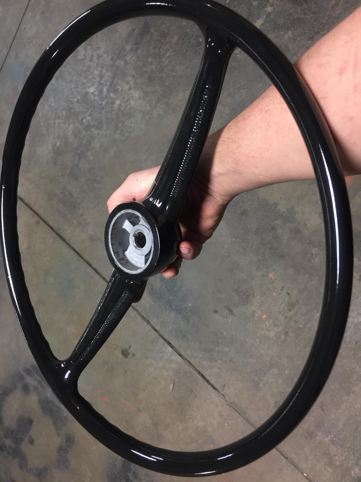

My steering wheel was shattered in like 15 different places. I put it back together like a jigsaw puzzle and used some new epoxy i found at the hardware store. I also used a dremel and where ever a crack was, i ground it out and used epoxy as a filler. I sanded everything smooth before the epoxy had totally cured. Then a few coats of filler primer then paint. Im really bad at documenting stuff. Sorry! Trust me, it was in terrible condition.
I got the dash buffed out. Got my switches installed and some gauges. I painted the knobs to clean stuff up. Ive got my entire wiring harness installed and ready for battery. I had a new VW key cut and when it gets here ill see if everything works. Fingers crossed! Lol.

Both the clock and steering wheel look killer! It has been hard for me to realize this over the past few months of putting the 15 window back together, but it really is the little details that add up to the big picture. Looking back on where you started, it must be kind of hard to believe you're at this point!! Keep it up Very Happy
I thought about doing the same or similar job on my SC's steering wheel, as the casting is long gone. But, since the steering wheel is right in your face, I might lean on someone else's skill in bringing it back to life---don't want to be reminded every time I drive of my [lack of] re-casting skills hahaha.

BusJunky wrote:
I took my deluxe clock apart... and put it back together!
How did you do the bezel removal and repressing the back of it?
Thank you, Barry!
I used a set of mirco screw drivers from a glasses repair set. I just slowly worked the back of the bezel with a tiny flathead until i was able to slide it off.
I crimped it back together using a pair of pliers, but wrapped one side of them in electrical tape so it wouldnt gouge the finish. I just went really slow. Its far from concours, but the inside of my bus is starting to look really nice. I plan to drive it every chance I get!!
You did a great job so far as I can tell! Badass work all around - keep at it![/quote]
I pulled this steering wheel from a 1956 or 7 panel bus thats rotted into the ground out at a friends house. Nearly the whole bus is buried underground and this steering wheel had been poking out like a tombstone for the last 10 years. I cut the steering shaft off and soaked the hub in PB Blaster for a week. The steering wheel was all intact when i got it, but had multiple stress cracks. After soaking a week I put the steering wheel between my legs and tapped the center shaft with a hammer to seperate the two. The hub came apart in pieces after the first tap. Thankfully I had all the pieces at hand to put it back together. Id say of ya got all the pieces, give it a go! Painting a steering wheel isnt the best way to fix it, but I put about 4 layers of clear coat on the paint. So it should hold up for a very long time before it starts looking worn out again.
That metal part has been in pieces? If so I can't tell. If it is the metal part will it stay together while steering or parking?

BarryL wrote:
Nooo! Lol. Just the coating. The hub and frame were fine. That'd be scary.

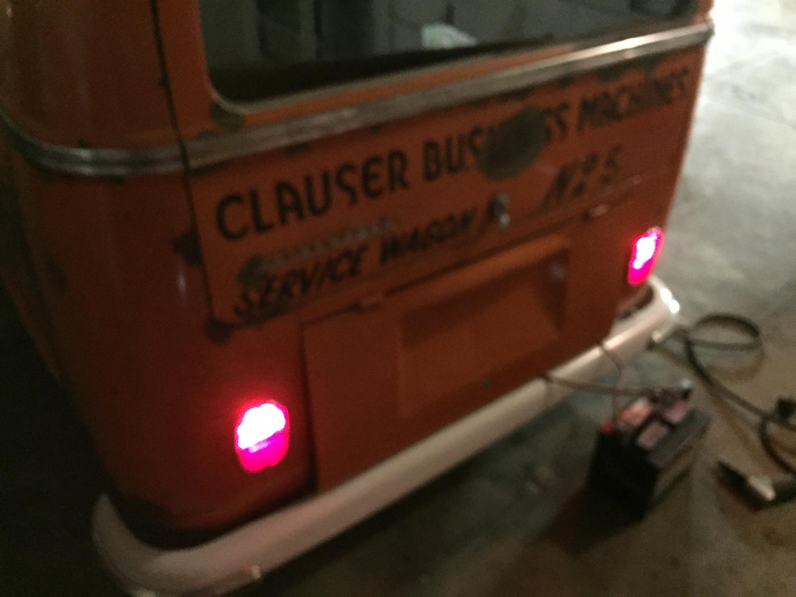

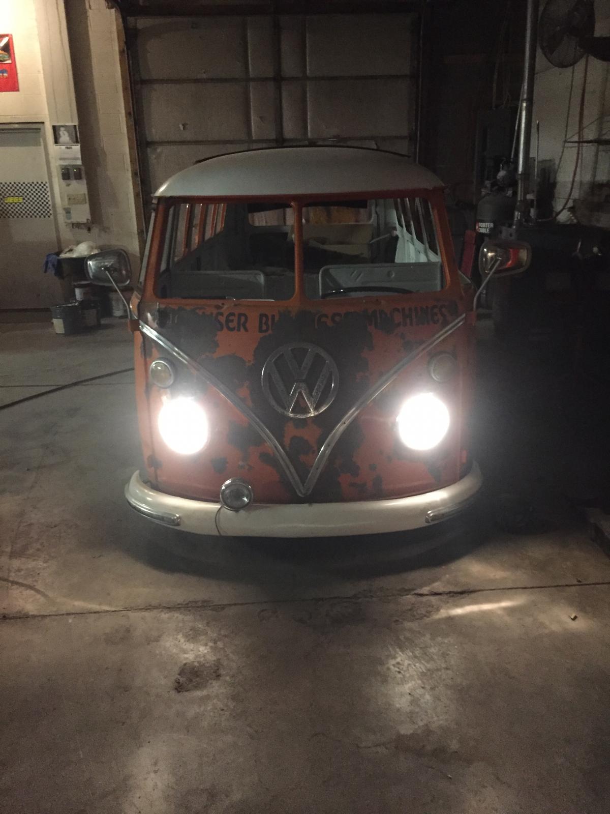

There shall be lights!!
Nothing caught fire, today was a good day!!
Everything werks.
