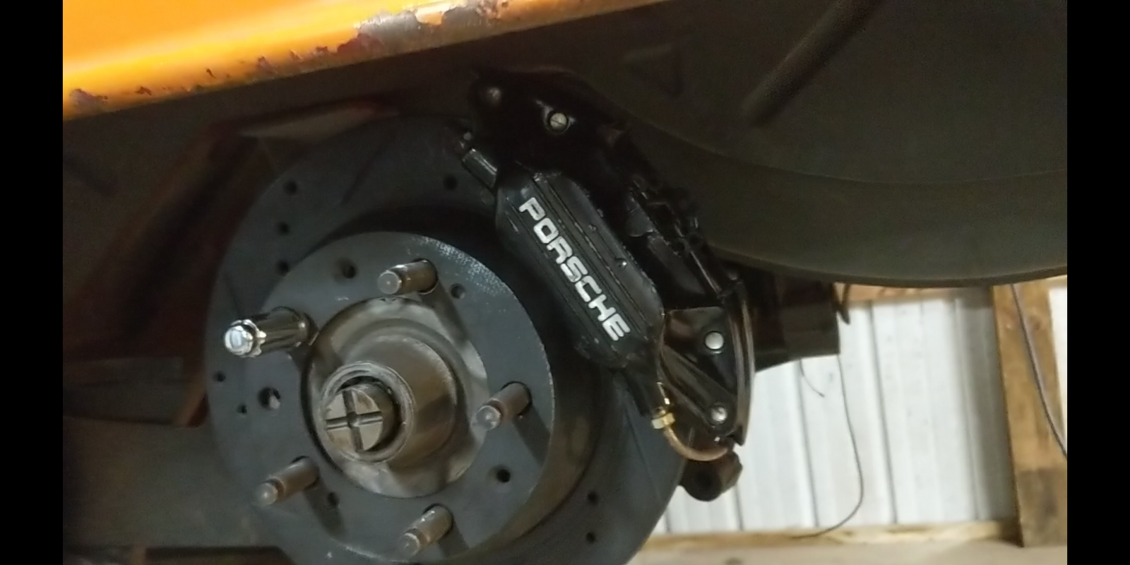

Update for this amazing bus and the incredible work done by busjunkie. The typewriter bus has found a new home with me and it's in good hands. Work continues at a much slower and unprofessional and unskilled fashion since I'm learning fabrication and methods. But I've been tackling the brake system and tracked down a great set of Porsche 944 turbo calipers from an 86. Ordered new brake lines, 67 MC, hub spacers for the caliper adapters and getting some custom SS brake lines worked up to make it all work. Here's some photos of my shitty fabwork. First time welding/fabwork. Also...it will be turbo'd...

That brake bracket looks scary to me. You may want to have someone with a bigger welder tackle those welds. You have no penetration.
those looks more like reminders to go back and weld this.....
regards
Uli
Culito
11010101
Joined: December 07, 2006
Posts: 5882
Location: Columbia Missourah
Culito is offline
PostPosted: Wed Mar 18, 2020 11:57 am    Post subject: Re: The Typewriter Business Pumpkin Bus Reply with quote
mandraks wrote:
It's probably fine if things are bolting through the bracket, and those tacks are just to hold the nuts in place.

johnnypan wrote:
cru62
Joined: December 31, 2002
Posts: 4121
Location: Margaritaville.....24/7
cru62 is offline
PostPosted: Wed Mar 18, 2020 1:02 pm    Post subject: Re: The Typewriter Business Pumpkin Bus Reply with quote
Culito wrote:
mandraks wrote:
Suspenders AND a belt. Weld that schiesse up!

I knew I should have never posted pics of the bracket haha ....I ground off the primer and redid them today. I cranked up the voltage and went all the way around instead of tacking them and it's much better all around. They were just tacks to hold them in place since it was bolted through the bracket with threads in the bracket and in the nuts. I took your advice though and redid them anyway since I'm self isolating in my garage lol.

I'd also question the tensile strength of those gal bolts...
All hardware is going to be grade 10.9. For now I was just using whatever metric I had for mock up. I'm also going to weld a rib between the caliper mounting spacers on the bracket.
You're welding 1/4" plate at least. You're machine should be MAXXED unless you have a very heavy duty welder. Not having seen your equipment, that's a struggle for a standard 170 amp/220v machine. A 110 machine is not going to cut it.
You can do a root pass then multiple passes if the material is beveled properly. From what I'm seeing you need to do a little bit more studying on welding thick materials. I'm not trying to be an ass, but things like brake brackets are important. It's not like a weld on your rock and roll bed breaking while your getting down.

You're right...I appreciate the advice. I'm going to reassess my approach and probably have a local welder redo them. Always love constructive criticism especially on brake brackets. I have learned a lot and enjoyed figuring it out though.
