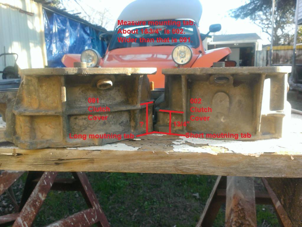

002 to 091, 091 to 002 information
The shafts in that photo are not labelled correctly.
The 002 tranny came with two different input shaft depending on which engine it was being used with.
The correct information from the source you link to is:
091 311 105 A, INPUT SHAFT ,1968-71 TYPE 2 BUS WITH A TYPE I ENGINE, 002 BELL HOUSING, , SHORT SNOUT (287MM OVERALL LENGTH)
091 311 105, INPUT SHAFT, 1972-79 TYPE 2 BUS WITH A TYPE IV ENGINE, 002 OR 091 BELL HOUSING, , LONG SNOUT (298MM OVERALL LENGTH)
As you can see there is almost no difference in the depth of the bellhousings, the difference is mainly in the shape instead.
