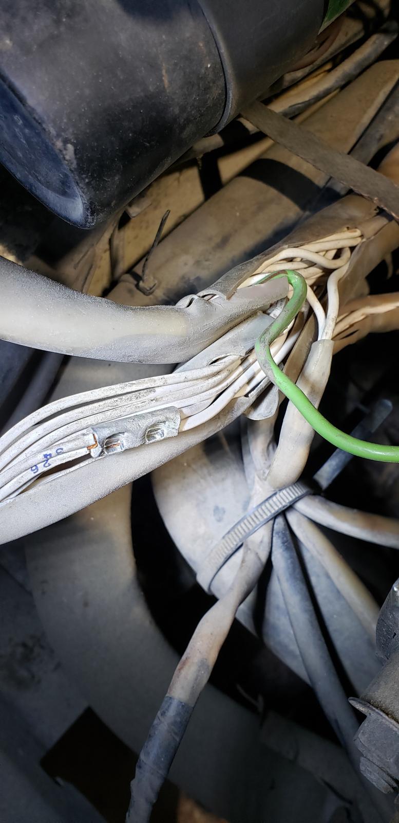

I have searched and searched, cutting open many sections of the harness (the tan color) and have only found a crimp connector with three wires going to it. Even feeling the length of the harness for any type of connector or bulge with no luck. The othe sets below that all go to ground or Hall sensor. What a pain.

PostPosted: Tue May 21, 2019 9:47 pm    Post subject: Re: 1983 1.9 Water cooled- Hall sensor in relation to injector spray Reply with quote
Those tiny numbers on the wires in your photo mean something. I think that is the crimp splice you are looking for.
If you look at the wiring diagram for the year that harness is from you should be able to find white wires shown there with those numbers on them. I'm afraid I owe you an apology. I haven't looked closely at the Digijet wiring in awhile. It seems from the diagram that the injectors get power from the fuel pump relay and thus don't have power all the time just because the key is on. They only get power when the fuel pump relay is turned on. Same for the aux air regulator.
Mark

PostPosted: Wed May 22, 2019 6:24 am    Post subject: Re: 1983 1.9 Water cooled- Hall sensor in relation to injector spray Reply with quote
Mark
After looking at the wiring diagram those are the wires from the relay to the injectors. I was looking for bullet connectors to begin with and not a crimp. It was getting late and I thought I only saw two wires Rolling Eyes . After staring at all these white wires for a while things sometimes run together. I will test them this evening and see what I come up with.
No worries Mark, I will have to check them again.

PostPosted: Mon May 27, 2019 7:34 am    Post subject: Re: 1983 1.9 Water cooled- Hall sensor in relation to injector spray Reply with quote
The six wires going to the crimp connection between the fuel pump and injectors looked good and clean. I went ahead and cut them back and reconnected them. No change.
I then went back through all the tests per the Digijet Pro Training tests and have come back to the conclusion that it is the ECU. I have located one that came out of a running van and will hopefully have it later this week.
