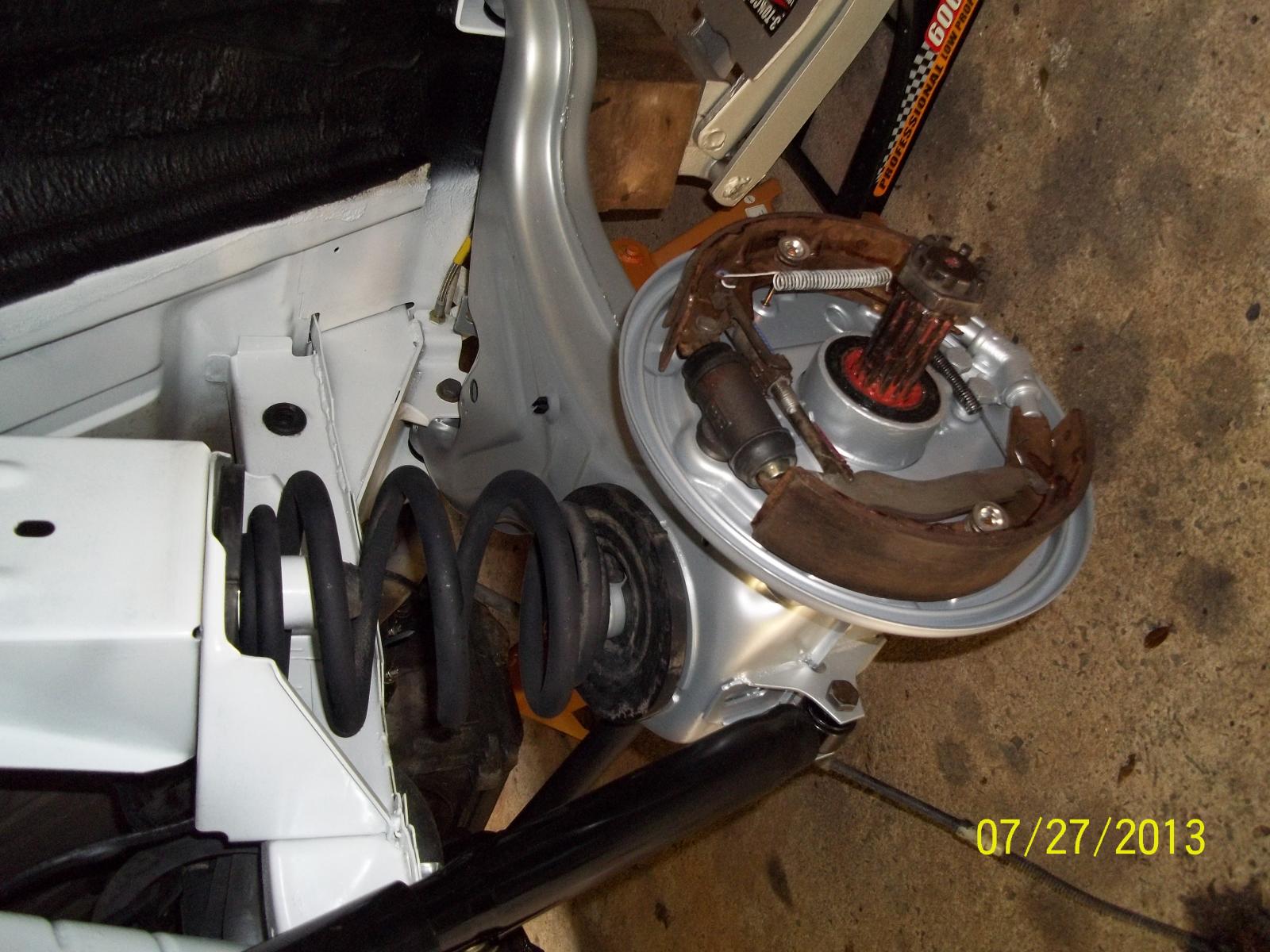

Started this project last night and no way is it a 2 hr. job for both sides. My spring, drivers side, is no where close to going back in. I am trying to put 3 3/8" spacers in. To get it out, I did the bottle jack thing, but with a jack under the brake so that it wouldn't put too much strain on the CVC. Somehow I got it out but now from the looks of the pic:
I have about 2" to lower the control arm to get the spring in. I do not want to tweak the CVC and have to replace something else. Will disconnecting the CVC get me that 2"? And if so, since I have never dealt with CVC's before, do I just take the bolts out and it comes down/away from the transaxle? Any special tools after I take the bolts out?
Thanks for any advice.

Take the shock off. Use a pry bar under the spring to force it in. If that doesn't get you there, you need to undo the axle nut or break the shaft at one of the joints to allow more movement. With the shocks undone, it is a quick job.

First thing I did was drop the shock off. I think I want to disconnect the axle at the transaxle. do I just take the bolts out and it comes down/away from the transaxle? Any special tools after I take the bolts out?
Disconnecting the CV joint at the transaxle side will get you ALL the extension you need to fit even the tallest spring in without use of a spring compressor. (You may still need to pry a little to pop in a tall tall spring)
Make sure you have the proper bit for the CV bolts.. They are not hex.. but a star. Using an allen style bit will likely strip the bolt and leave you as one unhappy camper.
Cover the CV joint in a plastic bag to keep debirs out. I use any plastic bag with a rubber band to hold it. The axle will rest on the swing arm housing.. The CV will hang from that..
Once the spring is in, make sure you have it in place, rotated so that the pig tail sits in the indentation.. in the lower pad aligned in perch... AND in the upper pad.
The springs like to work around a little as you recompress the set up.. So take your time and verify that its all properly seated.
When reconnecting the inside CV joint, you may need to rotate the wheel some to get the bolt holes to line up again.. Be patient and don't force anything. I jack the 1/4 under the swing arm.. leaving the wheel to rotate freely.. insert bolts and snug.. but do not tighten...until they are all in.. Lower the van to the ground.. Then take them to torque spec in a star pattern.
Other than the CV bolt bit.. there are no other special tools needed.
