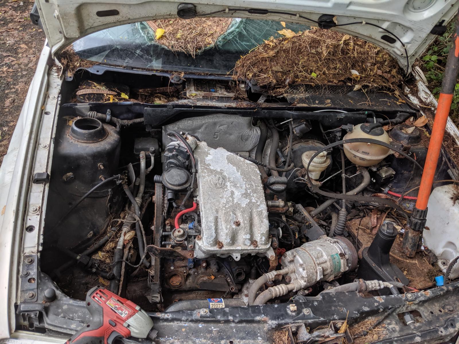

I went yesterday looking at the abandoned Jetta, I will pull the entire engine today. Some tweaker was living in the woods next to it, so I promised him 50 bucks he asked for it rather than arguing about it.
I will prolly end up using the cam in the 1.8 head too.
The block had been repainted blue on the ABA. It looks like it was a clean car with a clean engine, maybe I'll be lucky with a rebuilt bottom end Smile

I took a look at the engine harness, it`s in decent shape, a few cut wires I gotta figure out. The 2 catalytic converters are gone but I have a nice pig tail.
This one is factory plugged
This connector ripped next to the brake fluid level sensor, unknown
This electronic thingy half broken, unknown

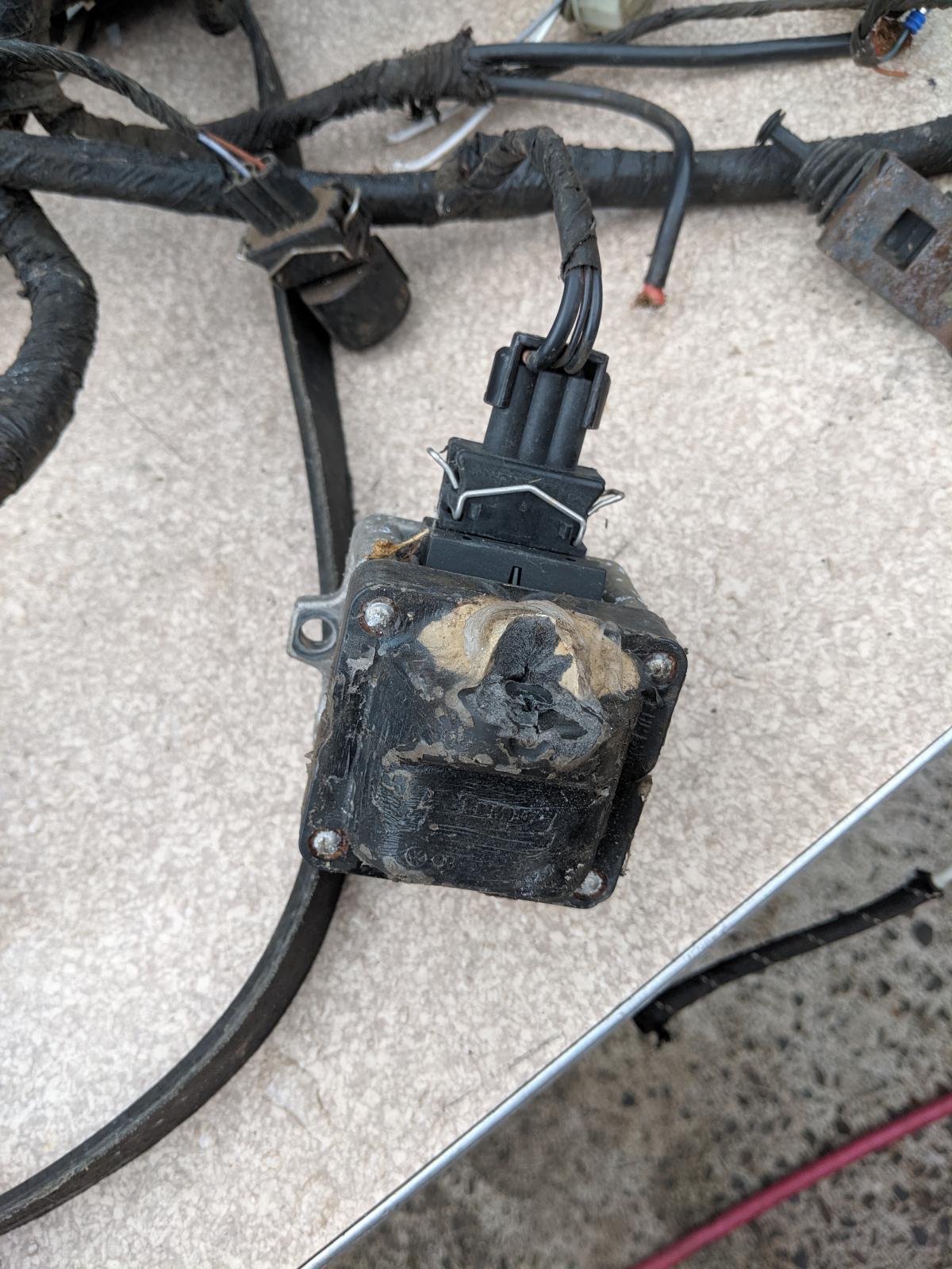

New coil needed, it prolly quit working bc of it and the car ended up there....
Crank sensor in white and knock sensor in blue are broken. Good thing they are color coded
I`m not sure yet what this one is for, next to a ripped 4 wire connector. That`s not the coolant temperature sensors.

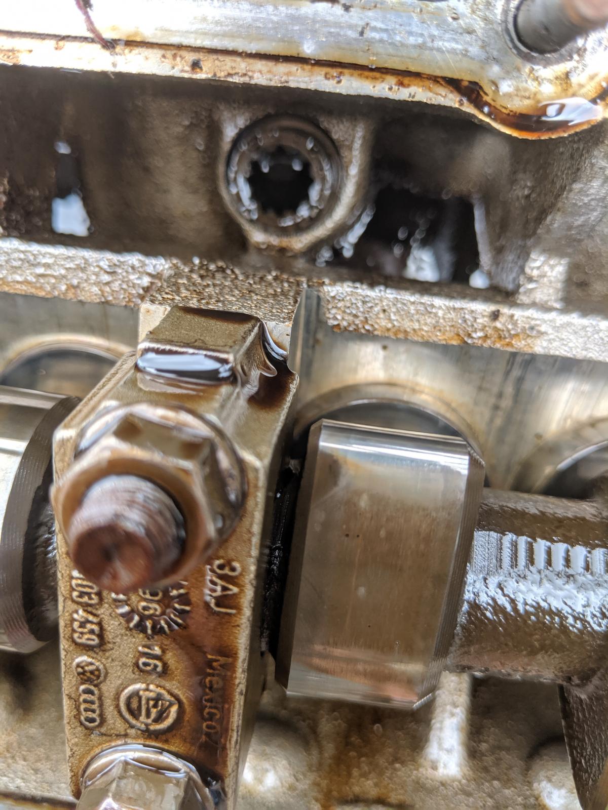

The engine is actually in great shape, the keyway of the oil pump is mint. It looked like it had a fresh rebuild. Not sure if it got done right though....
Camshaft looks new
One cylinder had light scraches on the spark plug area, and on the corresponding piston, nothing was in the cylinder. Like somebody scratched it with a screwdriver, but from inside. Weird.
I will prolly take it apart and hone it, get new rings and call it good. That`s gonna be the beginning of the back burner project, don`t expect updates soon Embarassed

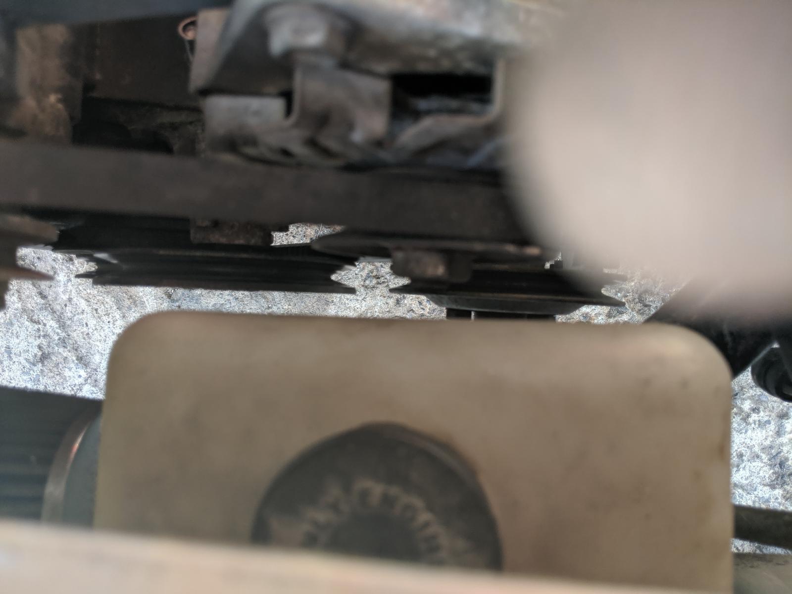

PostPosted: Fri Jun 28, 2019 1:19 pm    Post subject: Re: Making a Frankenstein Tiico with ABA engine and EFI ? Reply with quote
marks on piston from someone trying to confirm TDC of #1 ? (timing belt job?)
Looks like an OBD2 harness so I really shouldn't do any WAG'ing here but 2 conductor plug with white-green wire could be for IAT sensor.
2 wires near brake fluid cap maybe for coolant level sensor?
Neil.

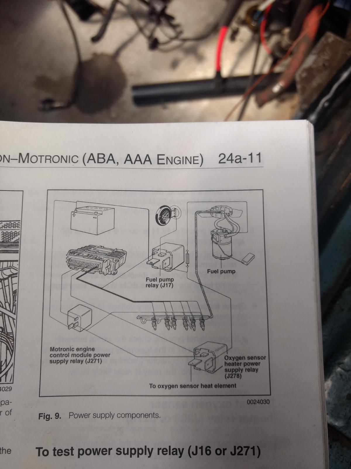

PostPosted: Fri Jun 28, 2019 5:49 pm    Post subject: Re: Making a Frankenstein Tiico with ABA engine and EFI ? Reply with quote
http://www.a2resource.com/electrical/management/motronicvr6aba.html
This should help with ID'ing the wires.

PostPosted: Fri Jun 28, 2019 9:06 pm    Post subject: Re: Making a Frankenstein Tiico with ABA engine and EFI ? Reply with quote
Neil.
Hi Neil!
No, it`s not the IAT, it was still connected on the manifold Smile
Coolant level for the other one is a good guess, you`re probably right as the tank was there but dangling aside.

PostPosted: Fri Jun 28, 2019 9:07 pm    Post subject: Re: Making a Frankenstein Tiico with ABA engine and EFI ? Reply with quote
I couldn`t have asked for a better ressource, thank you so much for that Cool Cool

PostPosted: Sat Jun 29, 2019 11:29 am    Post subject: Re: Making a Frankenstein Tiico with ABA engine and EFI ? Reply with quote
That broken three wire connector plug appears to be the speedo sensor on the trans.

PostPosted: Sun Jun 30, 2019 9:26 am    Post subject: Re: Making a Frankenstein Tiico with ABA engine and EFI ? Reply with quote
Thanks Casey!
The round thingy with an electronic board?
