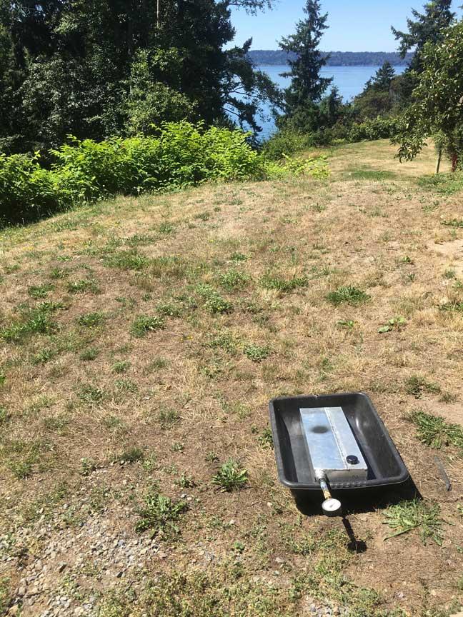

I'd be curious what a pressure gauge fitted to the filler cap would read if the container was left out in the sun for half a day.
OK Steve here we go.
In a black plastic tub.
Any guesses what the pressure and temp will be?
Seattle Forecast Friday, July 26: sunny & 85°F
....KTMs, GasGas, SPOT mtb
DanHoug
Joined: December 05, 2016
Posts: 5745
Location: Bemidji, MN
DanHoug is offline
PostPosted: Fri Jul 26, 2019 5:26 am    Post subject: Re: 2 gallon fuel tank (...a get outta jail card) Reply with quote
just be sure to leave headspace for liquid expansion!!!
-dan
www.thefixitworkshop.com
Sodo
Joined: July 06, 2007
Posts: 10658
Location: Western WA
Sodo is offline
PostPosted: Fri Jul 26, 2019 12:48 pm    Post subject: Re: 2 gallon fuel tank (...a get outta jail card) Reply with quote
Dan the tank is filled to 1 3/4" from the top.
So there is airspace at the top, "double" as explained a few posts back (7/24).
It's filled to 93% capacity, 7% empty space.
2.04 gallons (of 2.2).

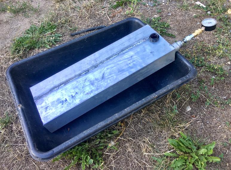

OK so here it is in full sun, probably since 11:00 AM.
Flat black "IR target" on the shiny Aluminum is 79°F.
Indoors, my shaded shop floor was 77°F (concrete).
Black plastic tub surface is pretty hot.... 151°F
I unscrewed the cap very slowly and there was no "audible PFFFFTTT"
Inserted the pressure guage and will check for pressure in a few hours.
Any guesses on the pressure & temp rise?

I know y'all are at the edge of your seats!
Here we are at 1:30.
We have needle liftoff!
I've got the fire department on speed-dial.

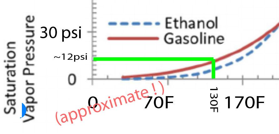

Although nobody is really suprised that it's obeying the vapor pressure curve
..... appx 2-4 psi at 97°F
I'm not.
But somehow, if that tank was sitting ontop of my van in Death Valley
....it helps to have seen the guage with my own eyes.
Added a Kolpin gas tank to the test-fixture.

Anyway I'm less concerned about the aluminum tank that I was before
so I'm at least thankful for Steve's "easy test" suggestion. Wink
The bloated plastic tank looks like its struggling.
But note it hasn't even blown the little yellow cap off.
Those just barely snap on, you can knock it off just walking by.
