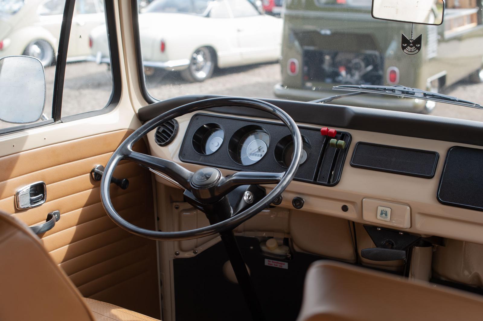

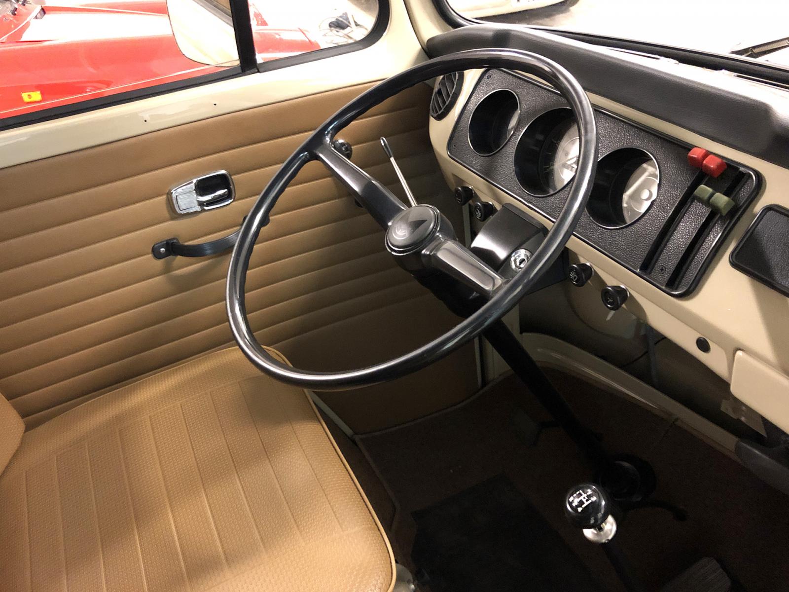

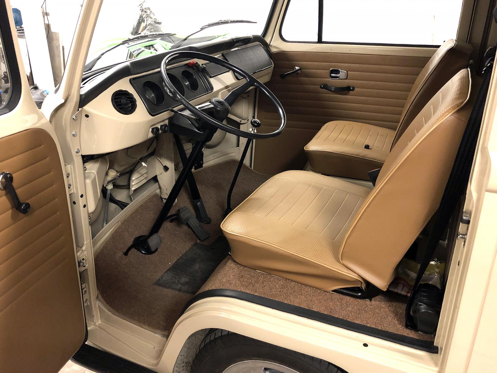

I previously made some shims for the drivers door because it was sagging a bit. I got those installed and you now no longer have to lift the door to get it properly shut. Then I started tackling the rubber seals. I don't know if the problem is the seals or the doors/body, but it's been way too tight on the front resulting in doors that are difficult to close and bounce out when you open them. So trimming, testing, trimming testing etc, before gluing them back on and setting them in with silicone. Not perfect, but feels much better.
Finally the door cards. I've had them since I got the seat covers, but never got around to install them. When I was about to post pictures I realized I might not have shown how it looks from the inside - probably because it's been looking crap. Did manage to find an old photo, though, so this is what I've been driving around with.
To this! (please excuse the poor phone/garage pictures):
Radio delete, glove box cover and inner door handles are new.
Also touched up with some paint around the horn button, and doing something fun with the button itself. Next up is kick panels and rear view mirror, then the cab will be done for now.

A couple of more evenings in the cave and I got the mats under the seats installed - another shitty, time consuming job, but now it's done.
Installed seatbelts from VW Heritage, and they were disappointing. Installation was simple enough, but they look way too modern and are way to tight to be comfortable.
So installing the new shifter from Vintage Speed was more entertaining. I haven't driven with it yet, but it feels much better than the original. Don't have to lean forward so much to find 1st and 3rd, and the reverse function is nice too. Looking forward to have a go with it.
Branded the horn button, so now I just gotta sort the kick panels and rear view mirror and the cab is good to go.

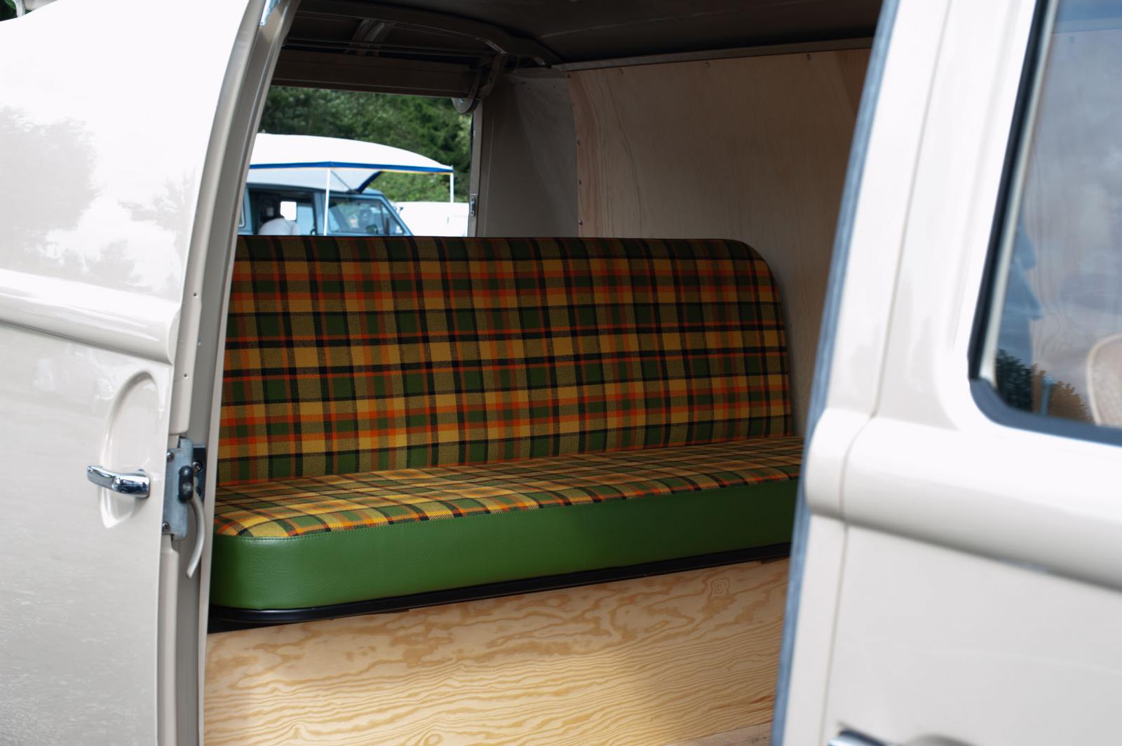

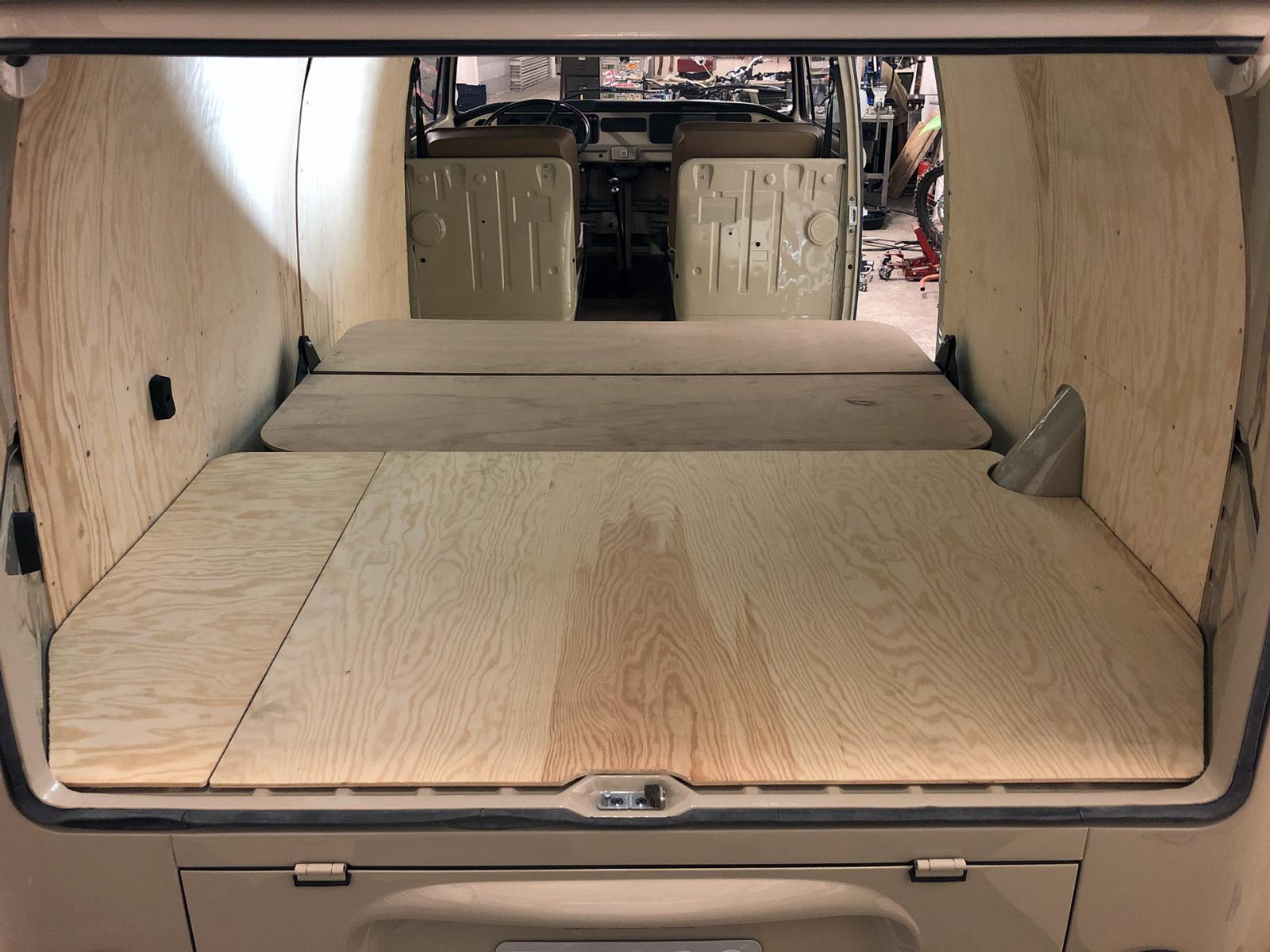

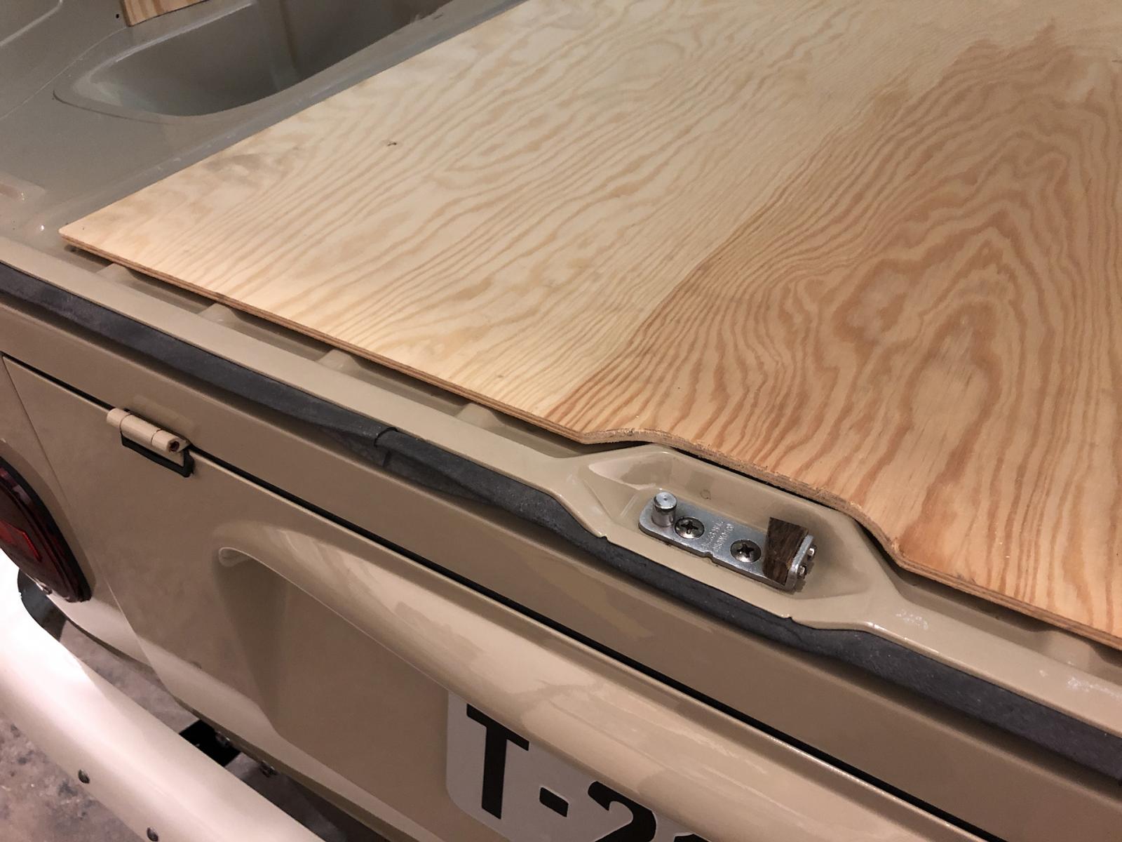

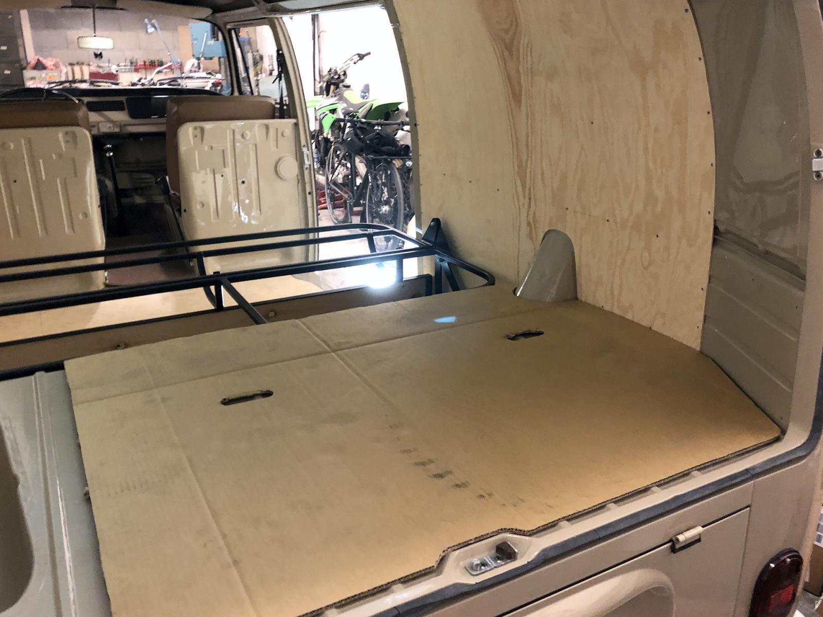

Yes, I did indeed make cardboard templates first. I think relying on other peoples measurements would be a risky route, and there are some oddities with the shapes. It's a tedious task making those boards and it kind of sucks that the height is 128cm, so you can't use the width of a plywood board that has the most bendable direction. Anywho, they are in, I just need to make them pretty.
Chugging away I made the boards for rear cushions and the tailgate. Now everything is ready for delivering to the upholsterer tomorrow, then it's xmas time on Thursday, just in time for the SCC meet.
Here I'm putting some lacquer on the tailgate board. It looks gloss because it was just put on, but it's a matte floor board lacquer that gives a nice and pretty tough finish. This is what I intend to use on the walls unless I change my mind after the other colors are installed.

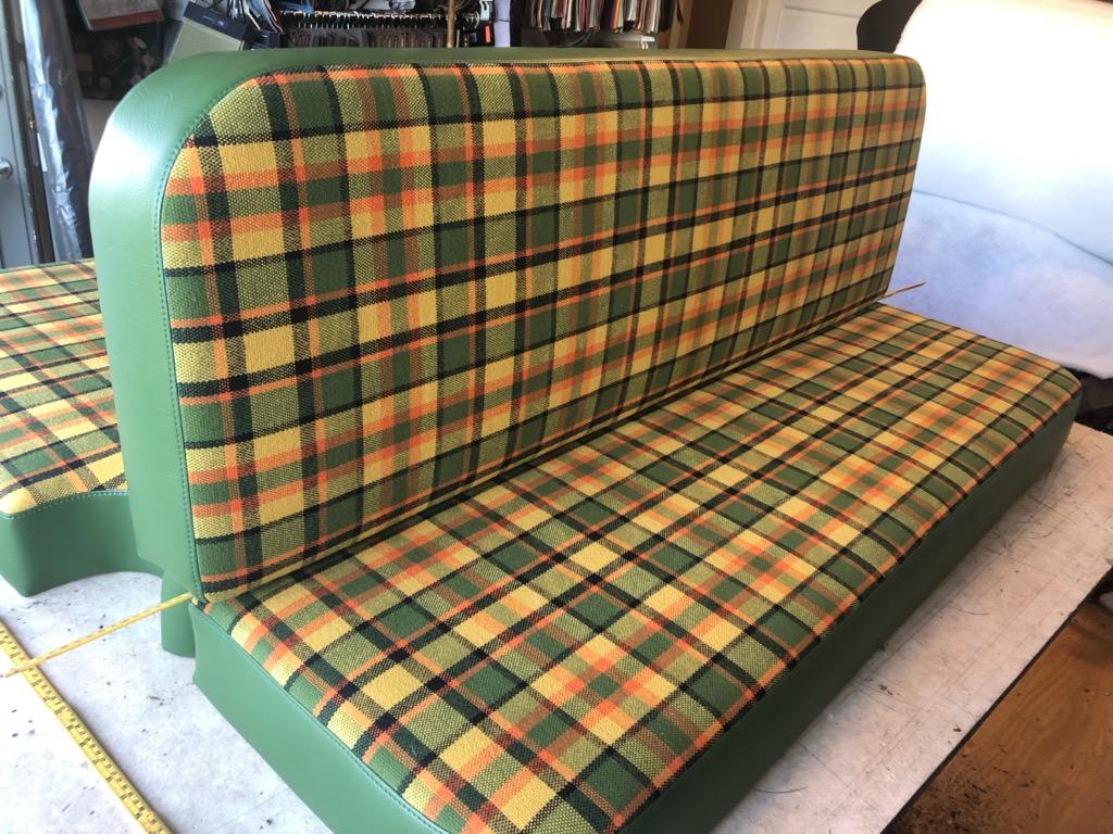

This morning I drove to an upholsterer in a nearby town and we chatted for half an hour on how to make the cushions.
Six hours later I got this photo. Stoked! Will pick them up on Wednesday.

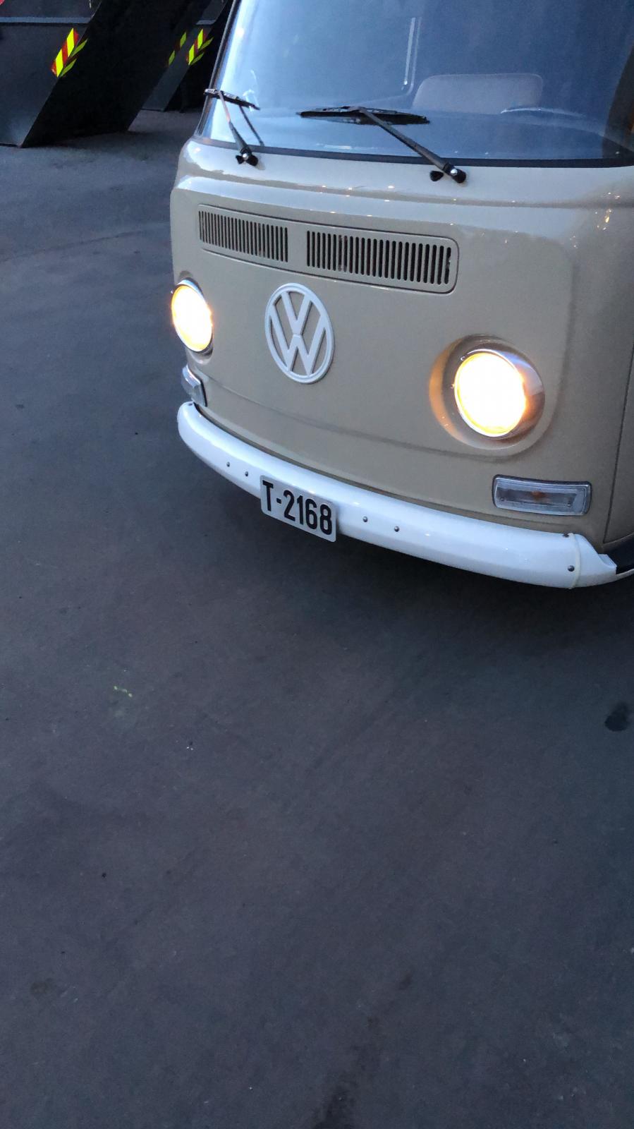

Wrapping up bits and pieces, and lowered the front a couple of notches. Now I can’t decide wether to follow up at the rear or come a notch back up the front. Had a nice little test-drive with a mate. Tomorrow I’m picking up the cushions from the upholsterer – can’t wait!

PostPosted: Wed Aug 14, 2019 3:05 am    Post subject: Re: 68 panel - a long story short ish Reply with quote
Stance is perfect. Leave it like that. And if in doubt mount slightly meatier tyres to the rear Smile
Edit: doublechecked, a tad lower in the rear would be fine Wink

Wish I could fit more rubber at the back, but I got the Vredestein Sprint Classic at 185/70-15, which gives me about 10mm of clearance. I might be able to squeeze in 195, but the Sprint Classic doesn't come in that size. I have my temporary 195/65 at the front (I know..), so I'm planning to get two new tires - either have the same rund baut or try to find something bigger at the back.

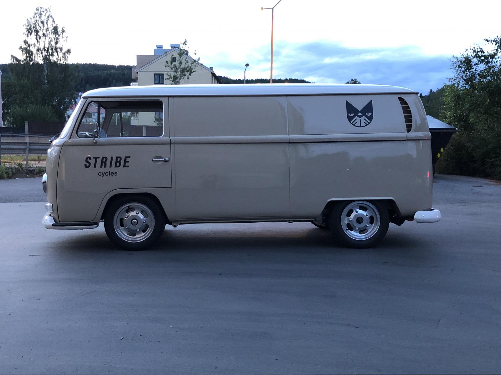

Had a good time at SCC, but rain from morning to bedtime on Saturday put a tiny damper on it. It didn't hurt to have a dry bus to jump into instead of crawling into a wet tent, so very happy about getting that done. Didn't take that many photos, but here's a few.

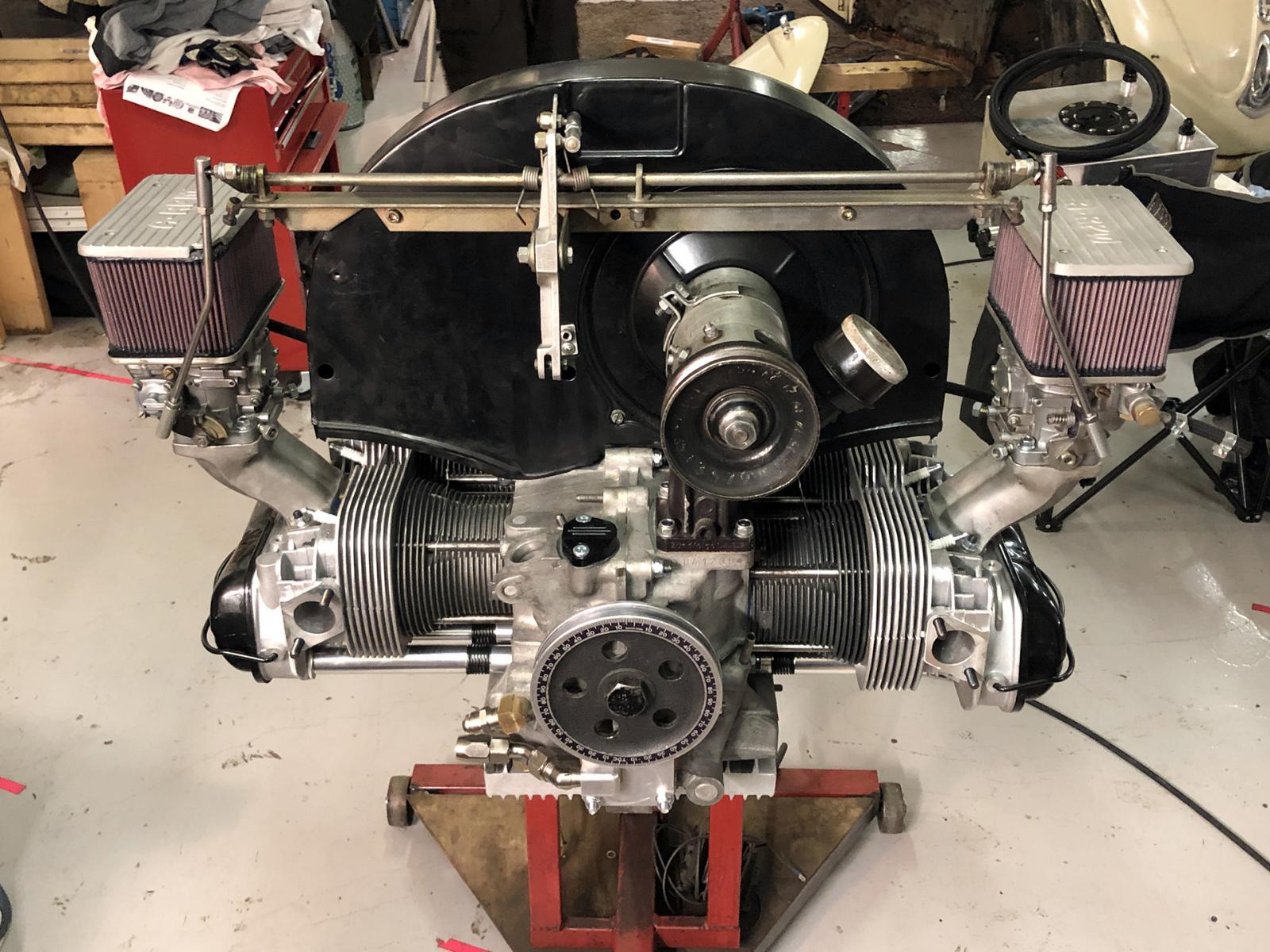

PostPosted: Thu Oct 03, 2019 1:35 am    Post subject: Re: 68 panel - a long story short ish Reply with quote

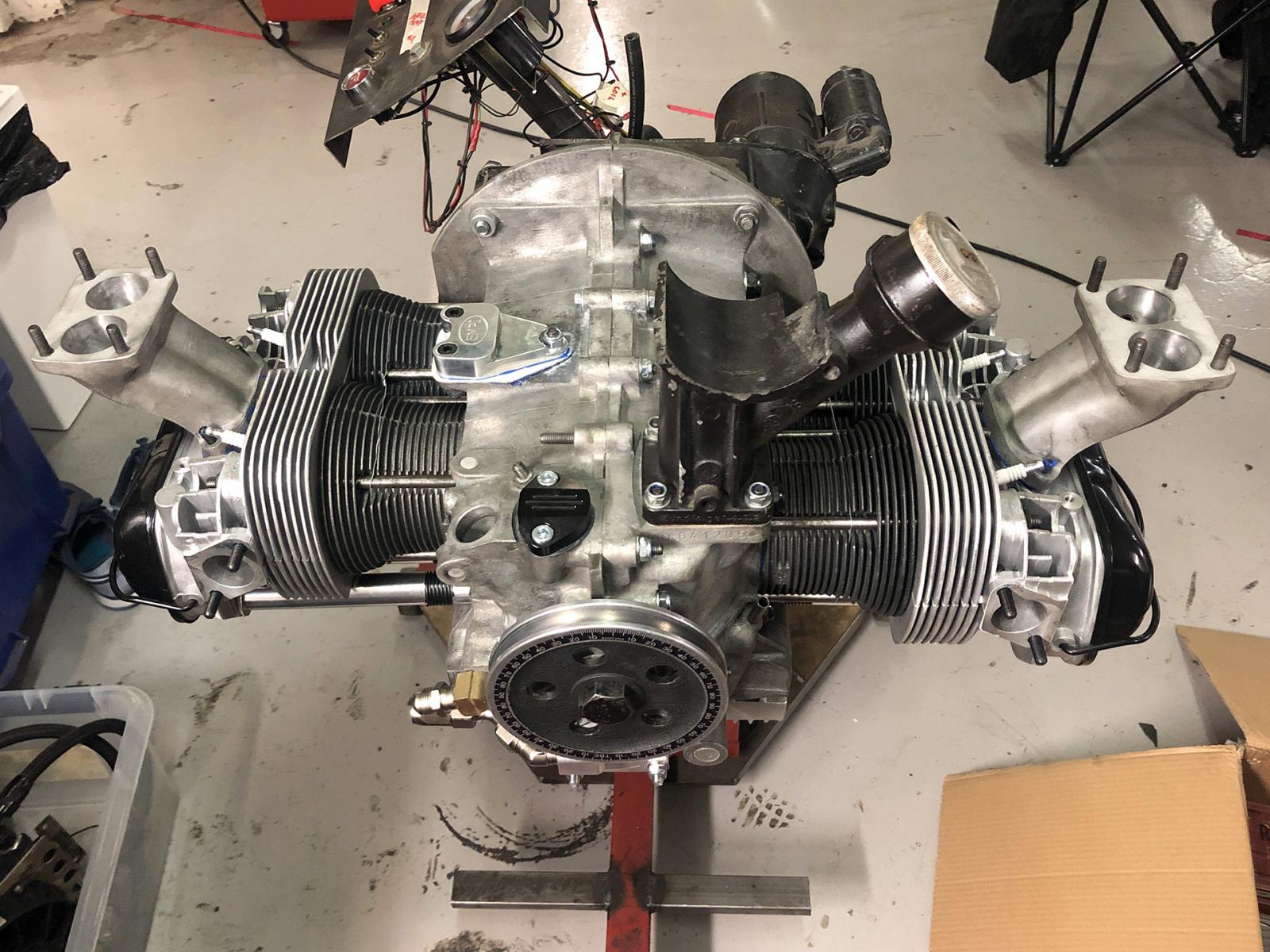

Been a while. Haven't used the bus much since the meet, but went on a nice cruise with two of the other guys I share the garage with a couple of weeks back.
Last night Anders and I went to get working on the engine again. We assembled the Webers and fitted some temp parts to get it ready, and in the AM it was time to fire it up.
Exciting for sure!
Everything went smooth, so I'm a happy camper.

One of my favorite busses I’ve seen.
Looks like some good power is going to be scooting that thing around. Mind you’ll probably have to remove the carbs and linkage to get the motor in.
I had to pull my Weber 40’s and linkage to get the thing installed in my 68. I also had to cut out the original oil air filter box stand, which to guys use to larger motors are familiar with, I didn’t know I had to modify that to make things work.
What kits are you using on the front cab doors and seats?

Yes, I was thinking they might had to come off to get it in. Noticed the air filter stand thing in your thread a while back, so will need to address that too.
Door cards and front seat covers are from TMI.
