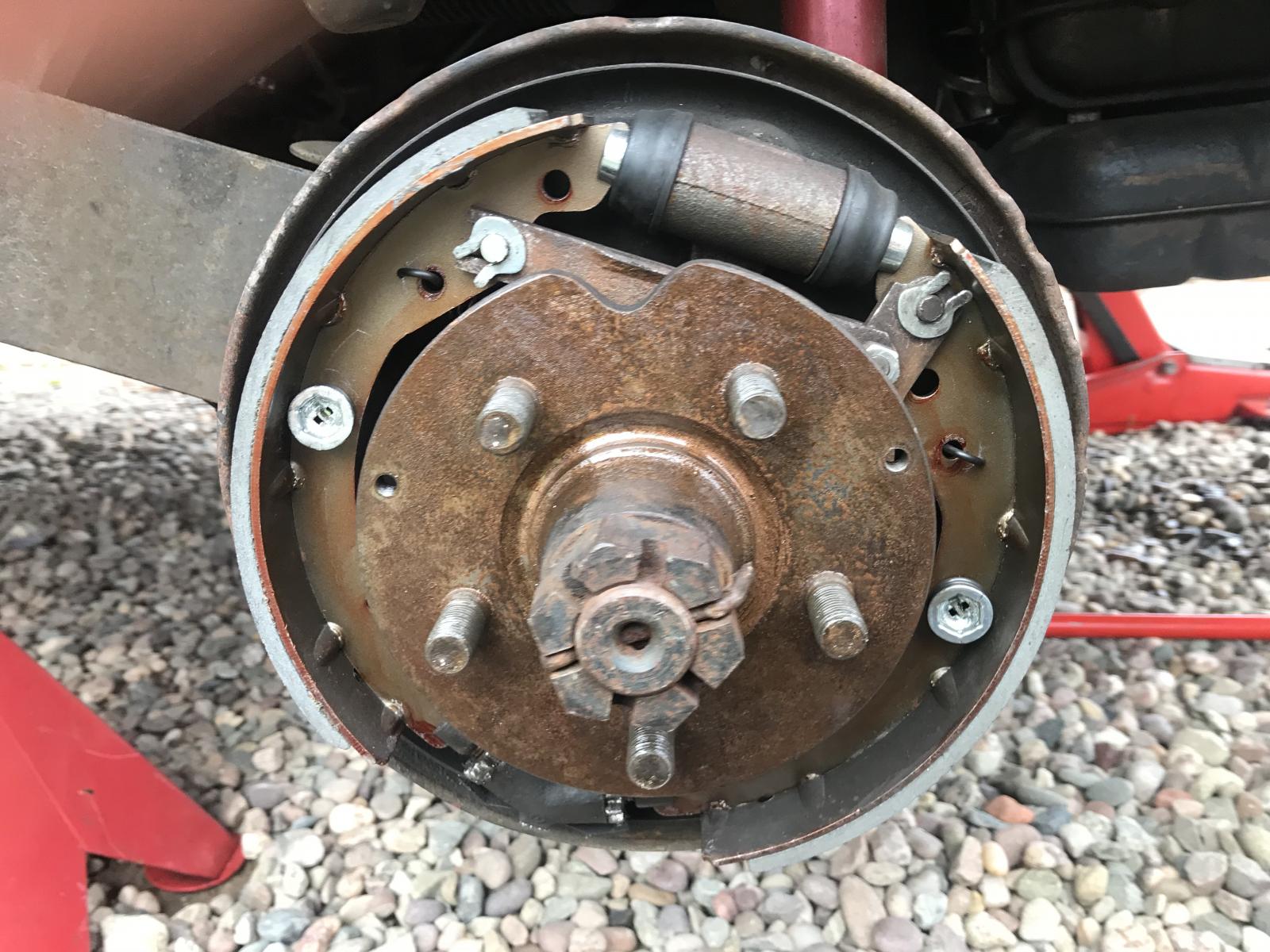

Does anybody have explanation for these braking issues? Here are some photos of the rear brakes:
RIGHT REAR
LEFT REAR

Looks to me like the parking brake got tightened up before the shoes were properly adjusted. Back the P. break all the way off and then adjust your shoes up using the correct procedure.

The cylinder in this picture looks to be a bit expanded which would be caused by he parking brake cable being too tight.

the rear pistons appear slightly extended as Mike said. Loosen the bleeder and see if they retract. If they do then a rubber line is swollen, or something is going on in the master. The condition of the front rotors tells me that these brakes have been down for awhile.

Notice the non-stock bolt and nut connecting the push bar and p.b. lever in the photo. Stock was pin #211-609-831 with
clip 211-609-833. There's a thread and photo about this clip at https://www.thesamba.com/vw/forum/viewtopic.php?p=1977134
The hitch at the brake pedal sounds like some kind of mechanical obstruction in the system somewhere.
It's been my experience that poorly adjusted rear brakes will certainly render them barely functional, but the effect on overall brake
performance is barely noticeable, because the front disk brakes do most of the braking. Therefore, "very bad brake performance"
as described would likely have more to do with the front brakes. I would be looking very closely at those very worn disks. There's
only 1.5 mm of allowable wear on those, per spec.

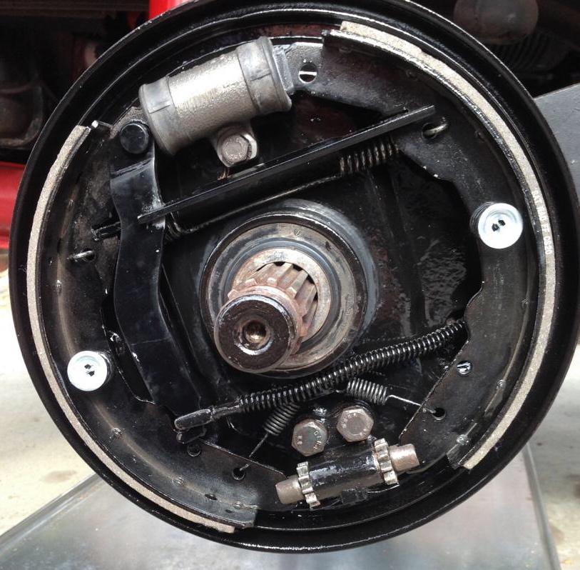

This is your brake
Here are a couple of pictures taken from the Samba gallery, note the difference in how far in the lower end of the parking break lever is sitting. Yours is way too tight.

Here's a thread that contains a photo of the 72-only pin that goes along with the clip mentioned above:
https://www.thesamba.com/vw/forum/viewtopic.php?t=509977
The p.b. lever is also a 72-only item, but one can't see what the OP has becasue the wheel hub is hiding it in
all the photos. Wildthings is right on, either the p.b. cables are inappropriately tight, or there's some
sort of interference due to non-stock parts being used.

The problem is - the front shoe rubs waaaaaay before the rear one does. I could back the front-facing shoes off by the 3 clicks and then increase the rear-facing shoes by another 30 clicks before that shoe begins to rub!
What is the correct method for the 1972 brakes?
Now, regarding the things I've done to this braking system to try and solve the issue of the rear right brake rubbing (and other issues):
Replaced Parts
- Rear drums
- Rear shoes
- Rear brake backing plates
- All drum brake springs and clips
- Both rear brake cylinders
- Handbrake cables
- Most of the copper brake lines
- All of the rubber brake lines
- Front brake discs
- Front brake pads
- Brake calliper rebuild kits (front brakes)
- All wheel bearings (front and back)
- Master cylinder
- Brake servo (booster)
I have also reconditioned the rear brake pressure regulator, rebuilt the (brand new) master cylinder, dismantled and rebuilt the front brake calipers, adjusted the brake servo locating rod, and obviously changed all the brake fluid (a thousand times). And, finally, I added shims to the rear bearing housings to bring the drums further away from the new brake backing plates which notoriously rub due to bad manufacturing. It definitely helped when I added them. Maybe I just need a couple more shims on each side.
And guess what..
I just went on a long trip around the UK for five days. The bus seemed fine at first but I had a difficult moment on a hill. I needed to adjust the handbrake more. I tightened it slightly.
Over the next few days I noticed that the engine was getting very hot and so were the drum brakes (particularly the right rear). I was also losing a lot of oil (probably because it was burning off).
Despite this, the van happily flew along the motorway at 80mph. Yes, some days the ambient temperature was hot, but some days it wasn't. And yes, the engine and brakes became hot very quickly into any journey; not just after the high speed trips.
In conclusion, I'm stumped. This is why I have asked the first question. I think there is an issue with one of the shoes (probably the front) connecting with the drum way before the other shoe. That shoe is probably already rubbing and it didn't take much of an increase in the handbrake tension for the rubbing to worsen.
This would also explain why, despite the shoes rubbing, the handbrake is still ineffective on steep hills.
As always, any advice is appreciated. Thanks for all your help chaps.
