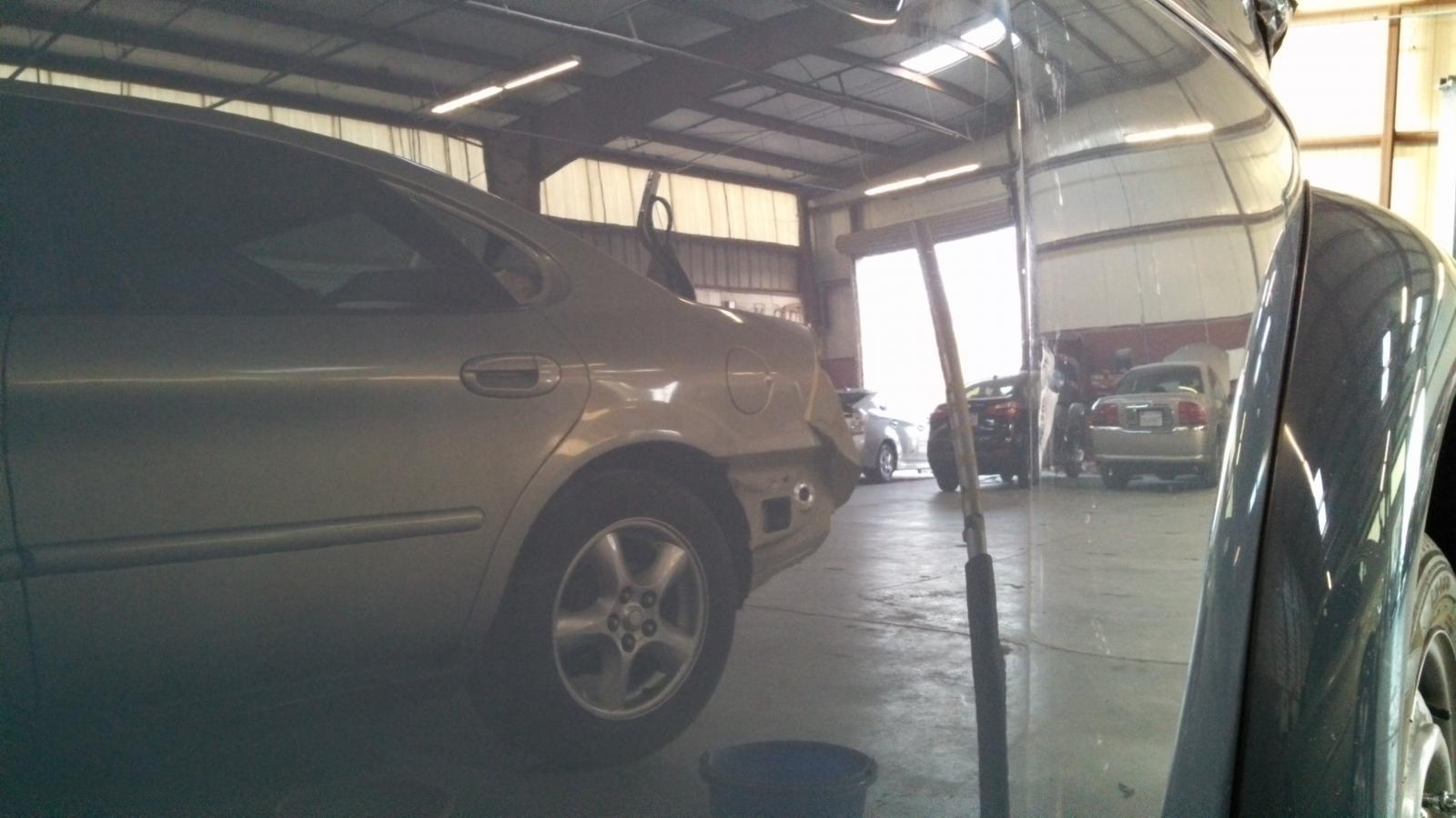

Providing you have put on enough clear or single stage you can achieve results like this with some patience and elbow grease. I put four coats of clear on this car. Then I wet sanded flat with 800 grit. After it was flat I went through the stages and sanded it with 1500, 2500 then 3000 and buffed it to look like a mirror.
It is long process but the results are amazing. Anyone can do this it is merely practice.
