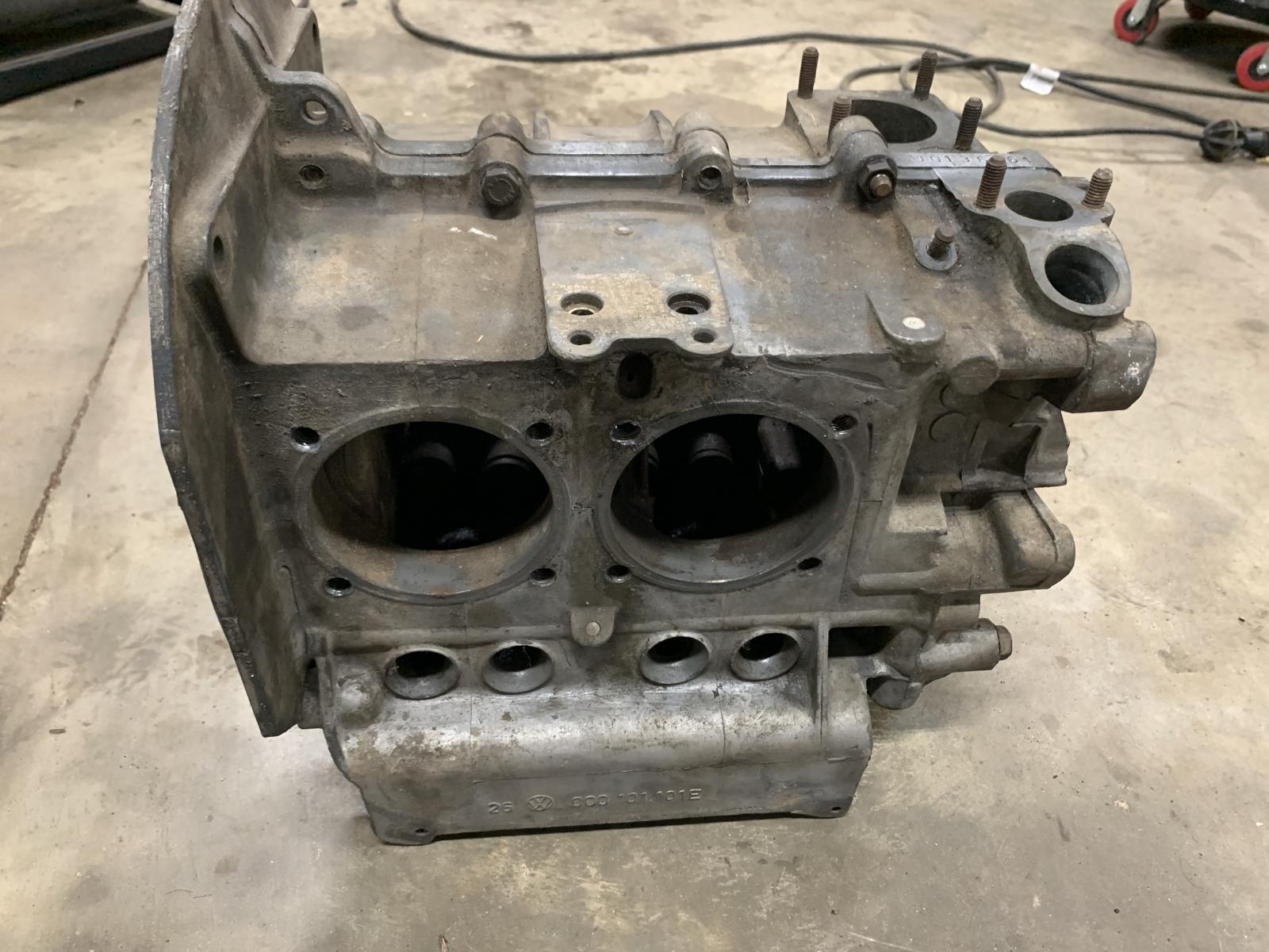

I bought this engine case in a parts lot.

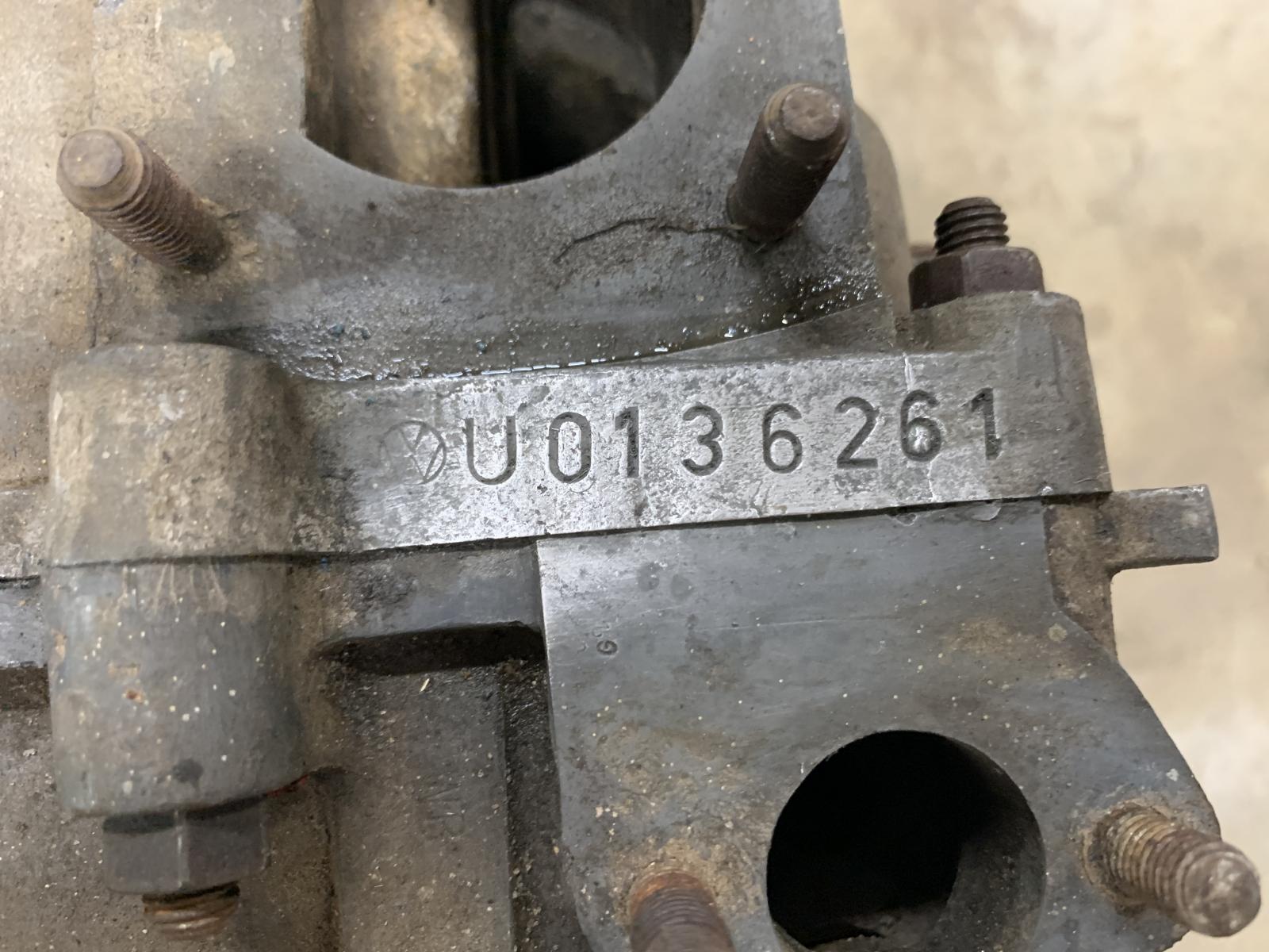

There is no Engine Serial number like where they are typically stamped, but instead on the middle of the case itself. Engine number: U0136261.
When I look this up in the technical VIN/Chassis numbers, it says it's coming back to a '69 Type 3 (Built in Nov 1968)
However, I thought 68-up had pancake style engines, not the uprights?
Any help appreciated. I am interested in learning a lesson! Thanks!!

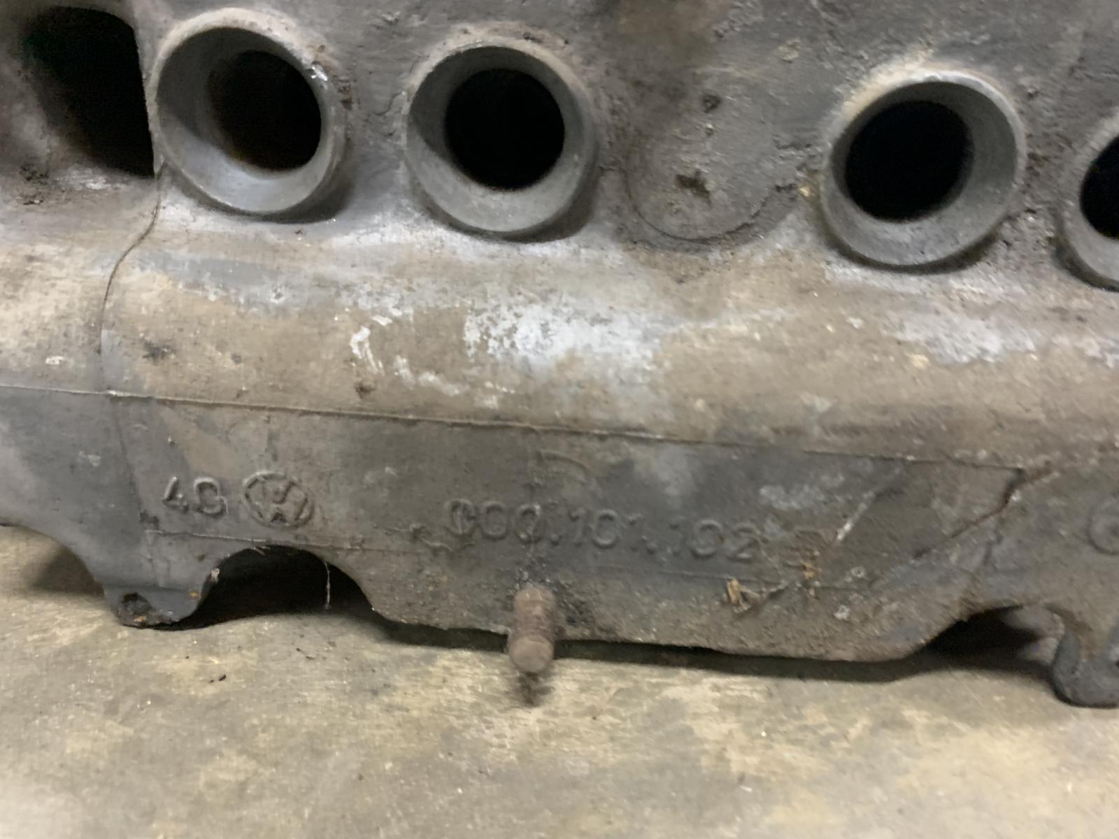

Right- it's a 1969 fuel injected Type 3 case. Type 3 was based on a Type 1, but had the oil fill hole at the bottom right rear of the case, no dipstick tube, and should have the 3 bosses drilled out and tapped at the rear of the case for the engine carrier bar.
What's the story on this case?
Excellent info. Thank you!
Not sure of the story. It's the only Type 3 item I got in the lot. I will be putting it for sale, eventually. Thanks!
