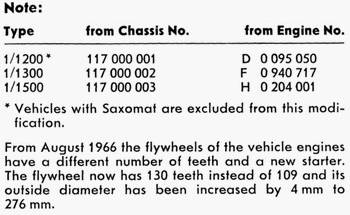

The number of teeth is the same. It's the diameter of the gear that changed. This changed rolled out during model year 1966 on the Ghia model. The SR11 starter is the normal 6V starter used with the smaller diameter ring-gear-flywheel. The SR13X was the first stab at a starter with the larger diameter ring gear flywheel. and was self-supporting, the 12V SR17X Autostick starter somewhat derived from this.
This note doesn't reflect the early rollout on Ghias, but the change overall for model year 67:
Starter gear sizes:

Thank you, that was the info I was looking for, for those that may come and read this latter I wound up going with a 6V duralast (autozone) starter and spinning it with 12, sounds like a little demon when she starts, but starts faster then ever and whenever I turn the key.
