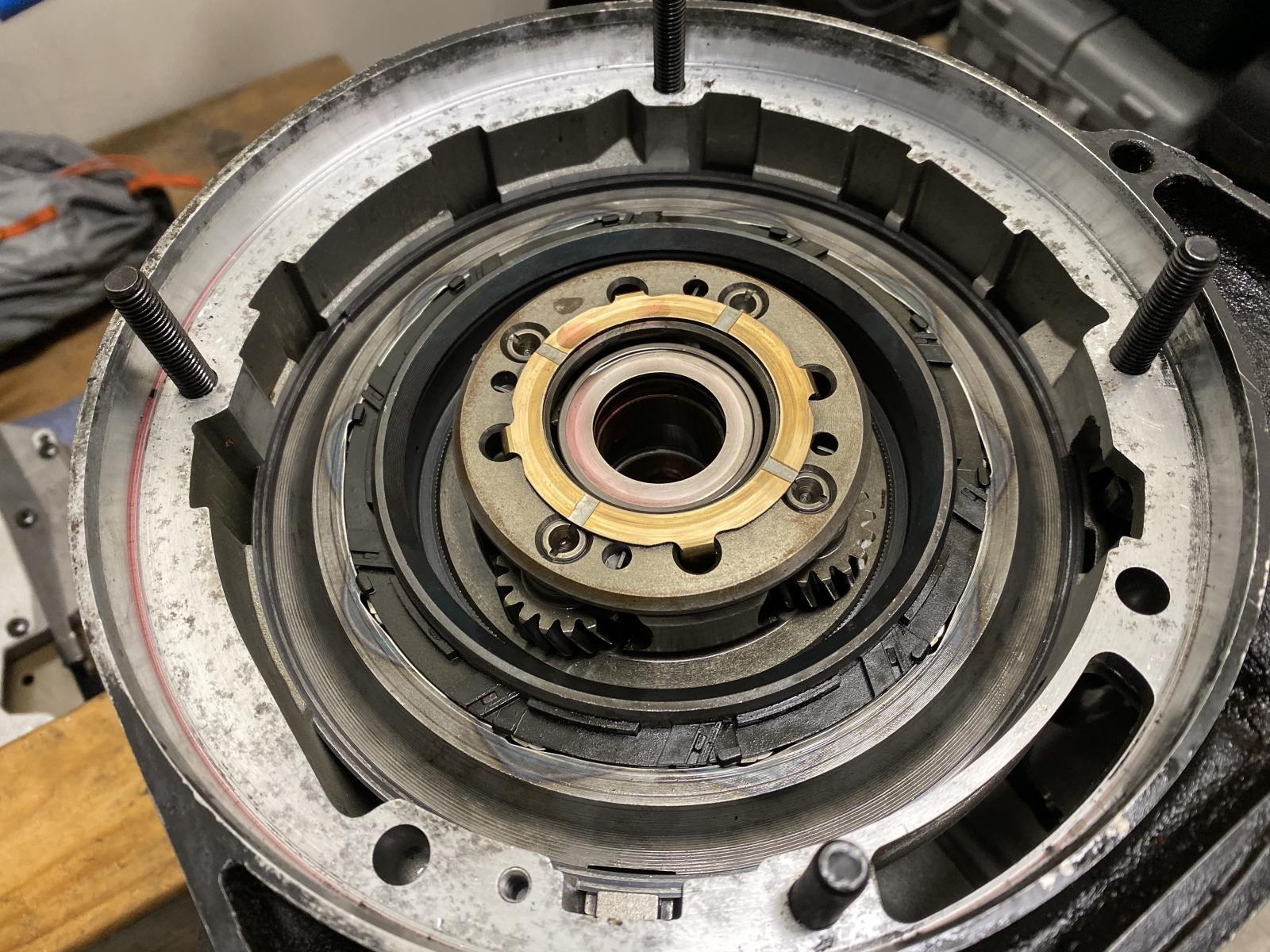

I had a clutch plate in the Direct Drum break. I do not believe it was a "stacking issue," but as we have narrowed down here, an issue with the piston for the direct drum. I'm going to order a new piston to confirm.
I was just rolling back through this thread and noticed something in one of your pictures.
Just looking at this pic I can tell you that the top surface of that piston is way thinner than the one I bought.
I am pretty sure that you have already come to this conclusion but I would feel pretty confident that that piston is the cause of your excessive gap and likely the cause of your failure.
I don't have any pictures of my piston but I am sure you will see a difference once you get the new one.
Thanks for the follow up. That is the conclusion that I came to, and I ordered new piston's from WIT. I went ahead and ordered all three since the other two were super cheap. Even if I don't use them, I would like to compare them.

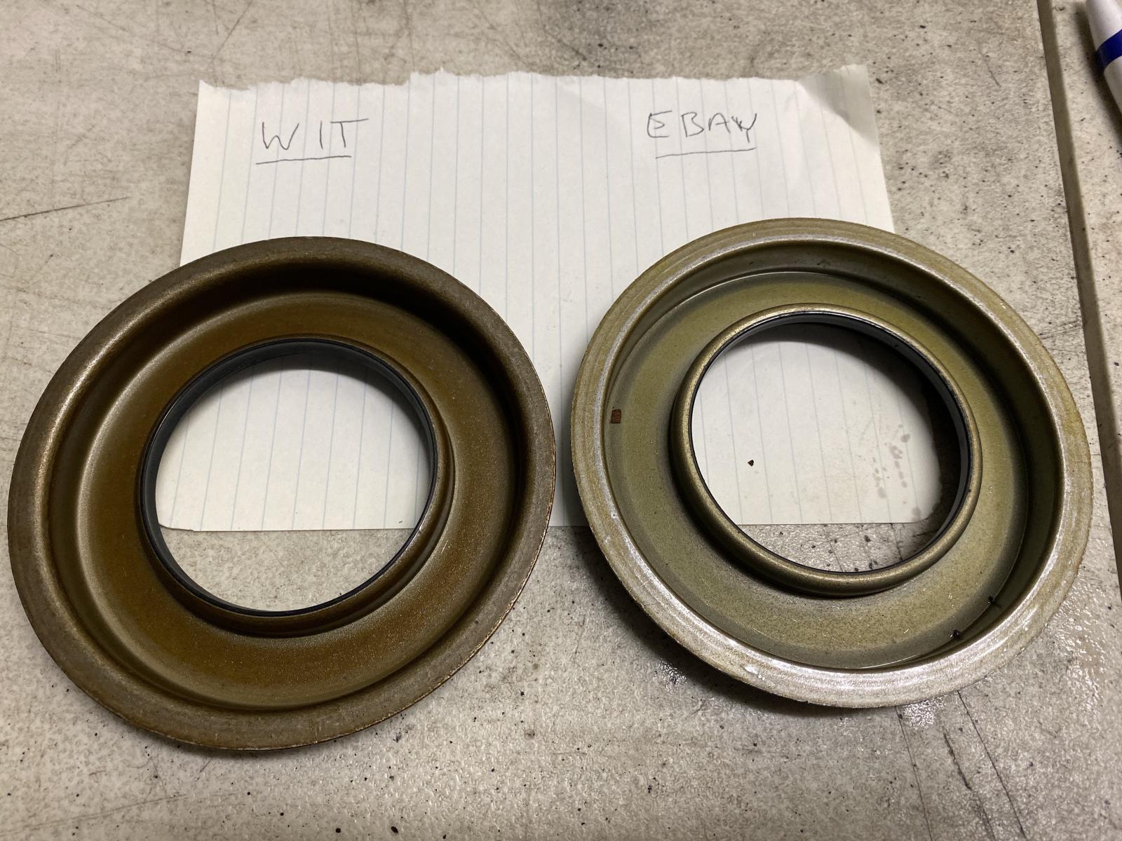

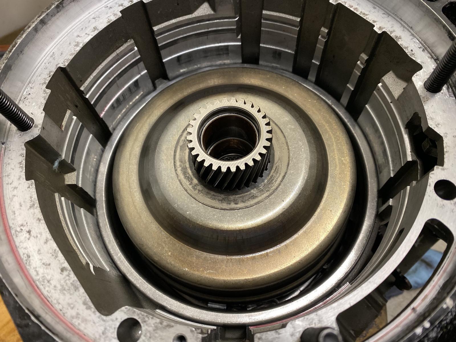

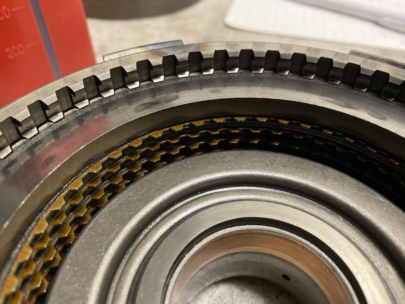

My pistons from WIT finally arrived, and they confirmed what I suspected. The pistons I got from eBay were either the wrong parts, or just not of the same quality.
The only one that was identical was the Forward clutch piston. The 1st piston and the DD piston were not even close.
Both the 1st piston and DD piston have Audi stamps on them (from WIT).
For the 1st piston, you can see that my eBay one didn't have the ball bearing. I'm planning on using the one from WIT.
Here are the two from the forward clutch which are identical.
And the comparison of the two DD pistons:
You can see the obvious height difference:
This made up for the gap that I had, and my clearance is now dead on spec. 2.05mm.

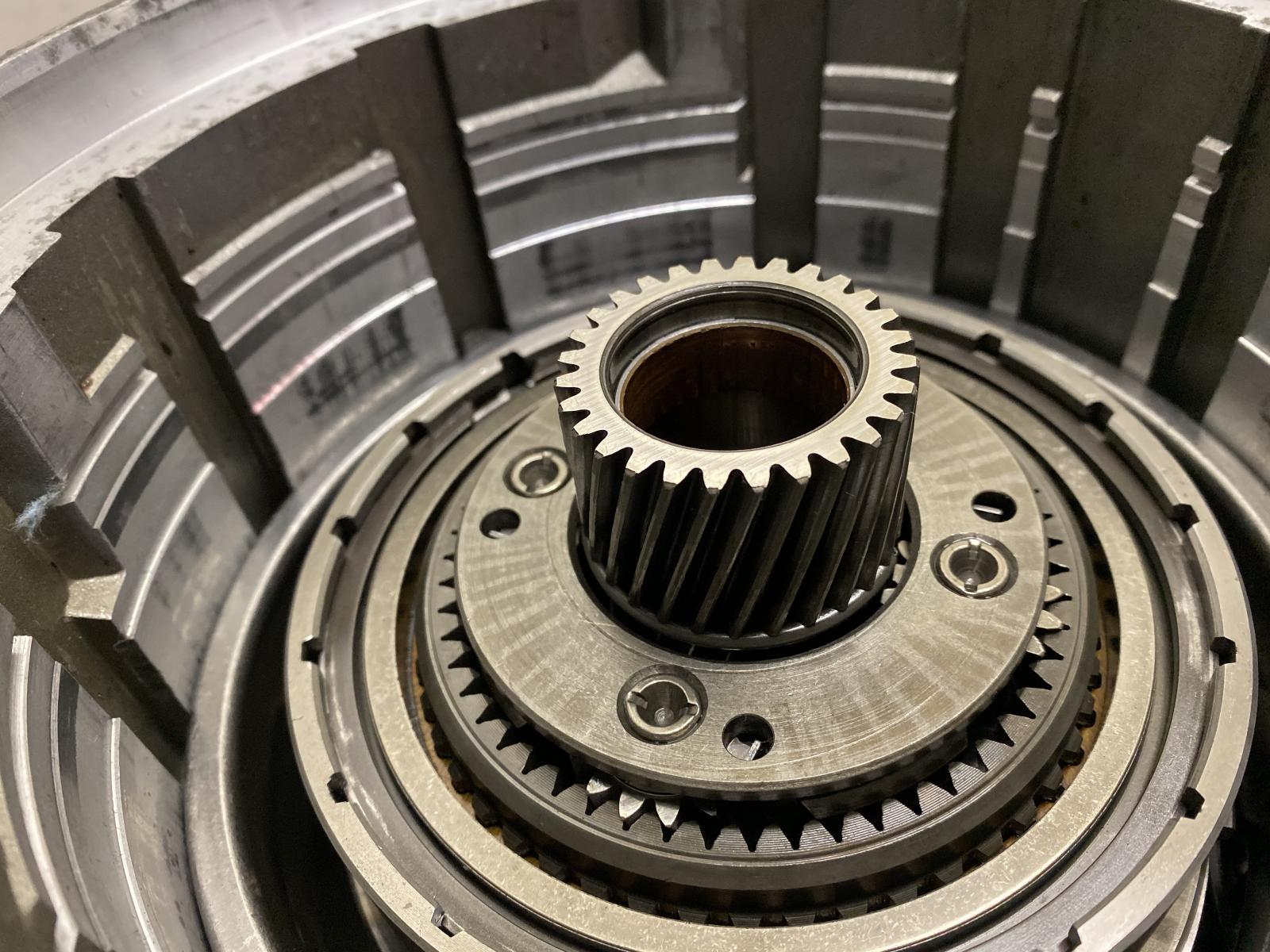

Confused by your comment on the WIT pistons vs. Audi pistons. Maybe my comment wasn't clear, but 2 of the 3 pistons I got from WIT were clearly stamped with the Audi badge on the underside. The only one that was similar to what I got from eBay, non-Audi, was the forward clutch piston.
I'm curious what you're referring to if not the Audi stamped pistons from WIT.
At any rate, I reassembled everything last night. It looks like we have some new people in the thread, and I'm always looking for input, so I'm going to post my step by step assemble. Any concerns, please raise them before it's too late. ha!
Apologies if I get any of the part names wrong...
1st Piston:
+ Apply Shield:
+ oil pump w/ thrust washer:
+ spring plate (7nm torque iirc):
+ Direct Drum:
+ 2 of the 3 piece bearing (the 3rd piece is in the forward clutch) & thrust washer:
+ Forward Clutch:
+ another bearing:
+ planetary gear:
+ sun gear:
+ shell:
+ another planetary:
+ clutch plates:
+ one way clutch:
+ can't remember what this part is called:
Sorry. I was not very clear in what I was trying to say.
Allow me to clarify.
Matt asked me what pistons I was using.
I told him some stuff I got from WIT.
He suggested only Using OEM stuff which, naturally, I would like to do.
While I did look at my pistons from WIT pretty hard and compared them to the factory parts, I do not recall seeing any Audi stamp on them.
Perhaps I did not look hard enough.
I have heard of some bum pistons on the market but mine looked to be pretty exact replicas of the factory parts.
Matt mentioned that the cheap ones are made of thinner material, as you had in your ebay DD piston, and have sharper radii in a lot of the corners, which you may also notice in your DD piston.
Mine were not like this and, as such, I am inclined to run them whether they have the Audi stamp on them or not.
At this point I don't feel like taking the trans back apart to check but I probably will just to do a more thorough comparison and check for any factory markings.
While rebuilding these things is not that hard, in my opinion, it's a real pain in the butt to drop them from the van and I don't want to do that in 3-5k miles.
Anyway Matt jokingly suggested that I be the guinea pig and see how long these "aftermarket" pistons hold up.
At this point I am inclined to do so.
